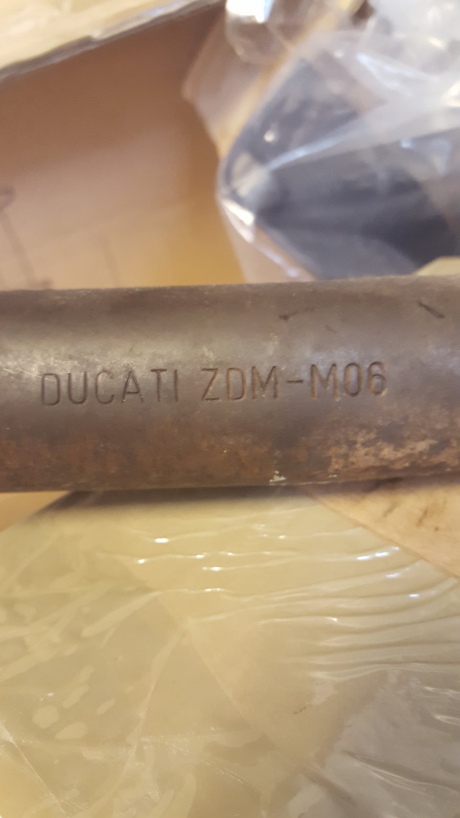

  3. Air Duck Hi.
    Strangely enough I've just found your post having come back in from the garage with a scrap of paper with
    DUCATI ZUM M06 written on it. I had to give the headers a good clean to find it.
    I was a little worried that meant Monster 600, but having done a quick Goggle I found some evidence that DUCATI ZDM M06 suggests they are for a 900SS.
    All the sites google found appear to be German Ebay, or German Ducati forums, so I'm wondering if they came off a bike originally sold in Germany.
    Nasher.

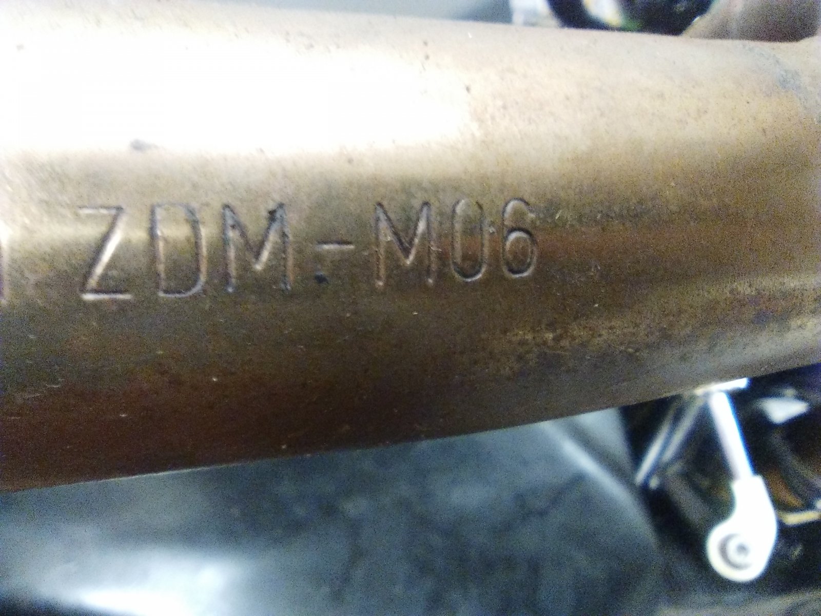

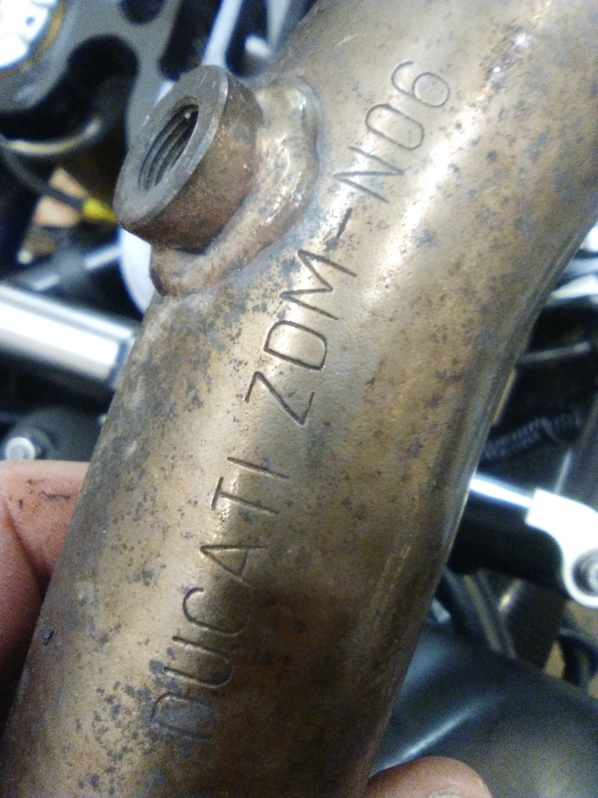

  5. Think it should be ZDM mate iirc that stands for 'Ducati Motorcycle'.
    Rear header pipe section says ZDM-N06
    Front header and branch set says ZDM-M06
    Front header and branch part number stamped into the pipe: 670.1.007.1A
    These are definitely from an SS (which I've had since about 1995).

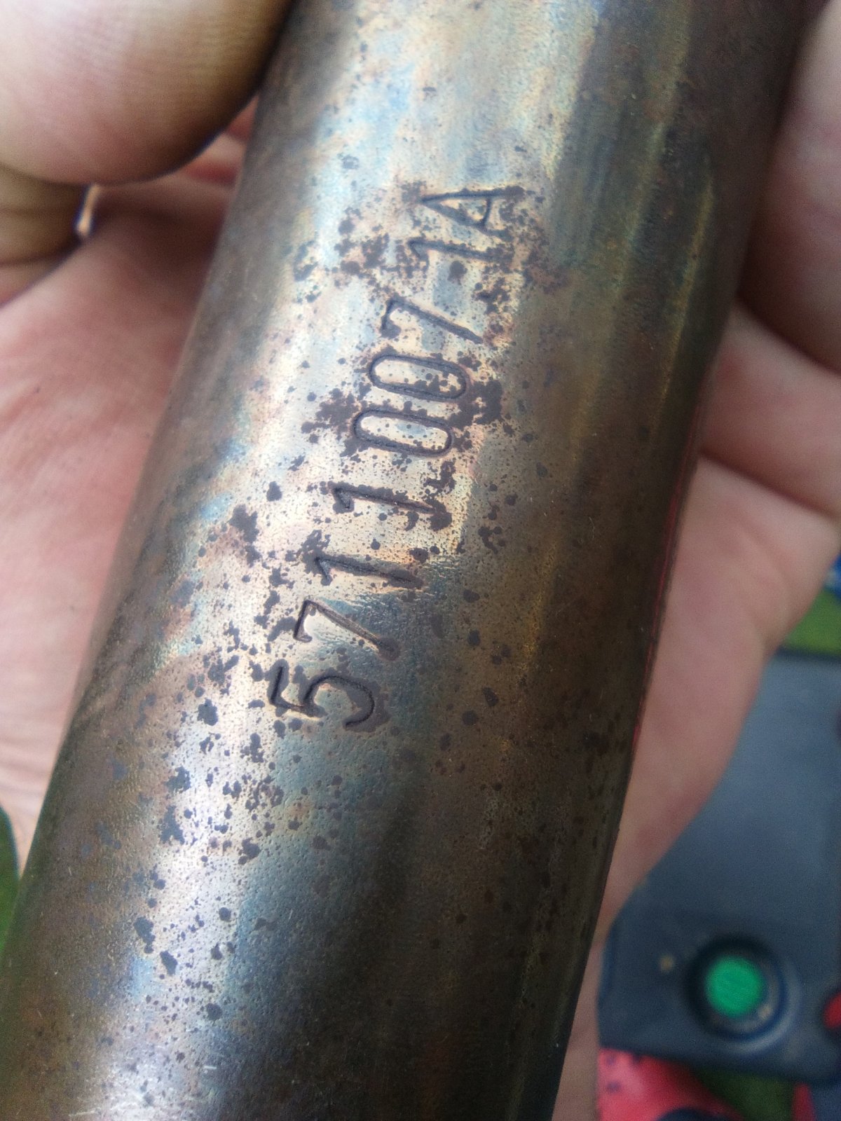

    I've cleaned the pipes up a bit better and found both sets of stamped numbers.
    The front/horizontal Cyl pipe and collector is marked:
    DUCATI ZDM - M06 570 1007 1A
    The Vertical Cyl pipe is marked:
    DUCATI ZDM - N06 571 1007 1A
    These tie up very nicely with what both Air Duck and Desmoquattro have shown/said, plus now I can see the actual part numbers I've checked them against the Stein-Dinse website and they are down as 900 SS/SL 94-97, so spot on for what I need.
    The Numbers Dukedesmo has posted do indeed show as the correct part numbers for a 94 M900.

  14. Here's the rear pipe number (that goes with the pipes I posted earlier):
