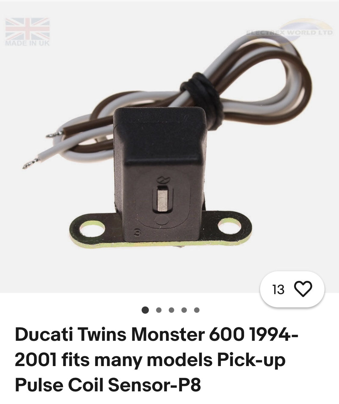

  7. James, you are doing all the right stuff, my thoughts....The resistance on the pickup coils can be fine, but they can be fecked. This can manifest in bad running. If it runs bad the spark would suffer, a weak spark was your original symptom.
    These coils sit in a hot oil bath, and if its the originals are now 30 odd years old. Ducatis of this era had electricals gremlins. I would replace the pickups if theres any doubt, i use Electrex World in the UK, they are about 30 quid each. If you are putting CA Cycleworks coils on, it makes sense to refresh the pick ups, then you know they are good. The igniters were never the best either. A common upgrade is an Ignitech ignition box, but thats another story. Chapion plugs are better than NGK for these, the Ducati branded plugs are Champion.

  10. Sounds like a logical next step. The pickups arent expensive to replace, only a hassle, due to having to reset the timing. I run a smaller gap too, for maximum signal strength. Sure its about 0.3/0.4 mm from memory for the distance from flywheel lobe to pickup
  11. OK, well, it wasn't the pickups. Sigh...
    I've spent the best part of 5 hours on changing them today and, though I would say it is a little bit better, it still ain't right. I think the horizontal cylinder is not having it. It seems to be chiming in more than not, but still running cooler than the vertical.
