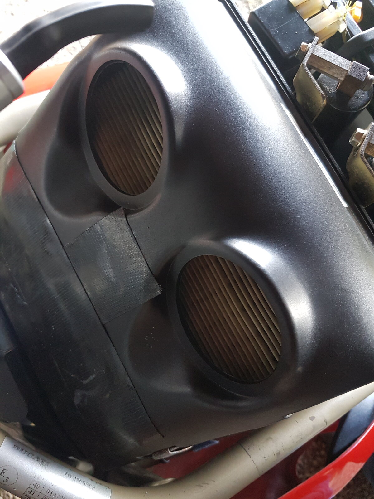

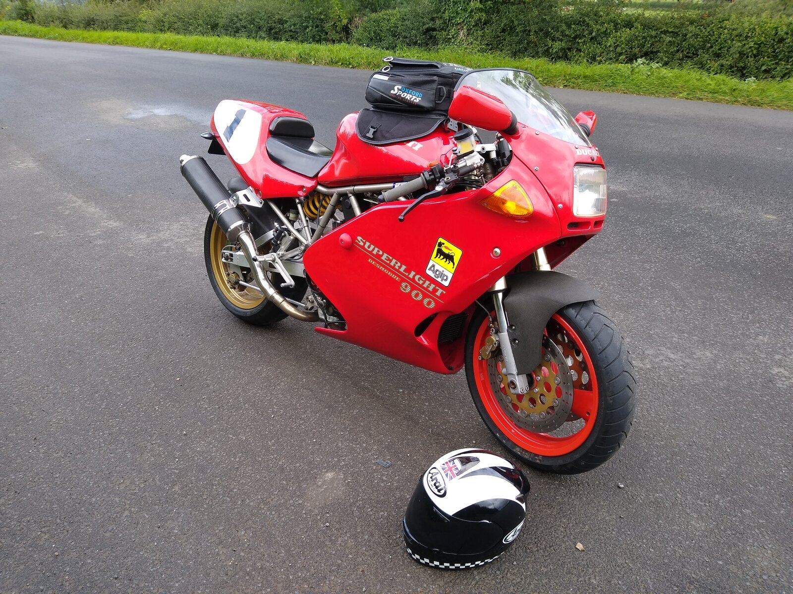

  1. First time out on my carby 900ss today and it's also struggling much over 5000rpm. My airbox is missing the trumpets as shown below so that's what I'm blaming. I've posted in the wanted section so if anybody has a set please let me know.

  3. Ditch the airbox lid completely and fit a ITG foam filter.
    Steve R
  4. Thanks for the advice, what would be the benefits?
  5. Better breathing for the motor and a washable filter that will probably last the lifetime of your bike.
    The induction will also sound awesome.
    Steve R

  7. I doubt it but you might need to change the main jets.

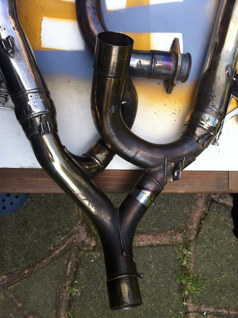

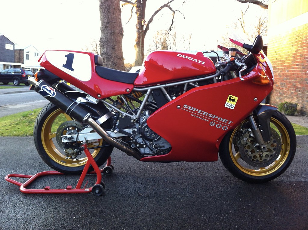

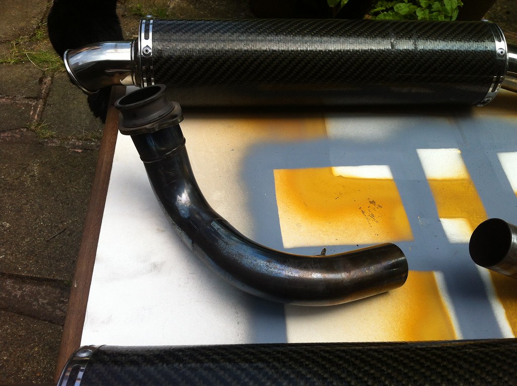

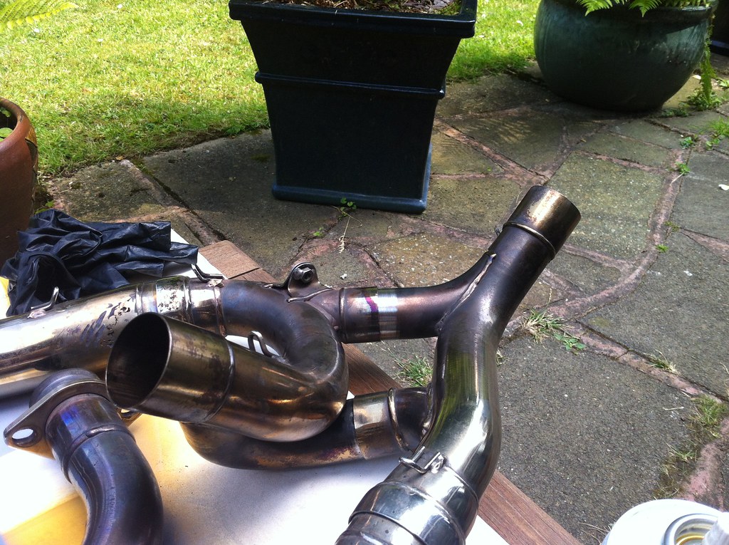

  16. Hi Sev,
    Many years ago now when I 1st started playing with/tuning my 851, John Hackett told me that if I wanted to start making real power I needed a set of 50mm headers.
    At that time almost unobtainable...
    Whilst shopping for parts for another Ducati I stumbled across a rather crude (but later to be found out very effective) F1 Thunderball Racing full 50mm Spaghetti system with lightweight thin walled S/Steel headers/all the pipe work and 50mm carbon cans.
    These systems were originally supplied by Gio Ca Moto the fore runner of Ducati Performance before they tied themselves to Termi'.
    In a fairly mild state of tune my 851/916cc motor kicked out 128 rwbhp and 76.8 ftlbs of torque using this system.
    More than a standard 996SPS at lower revs despite using less capacity, heavier crank/rods, lower comp', no plenum chamber HUGE airbox and smaller inlet valves.
    It pulls up tree stumps from as low as 2.5K rpm.
    Despite what the science might say I think Mr Hackett was right on the ball with his advice.
    My 884cc '79 900SS Bevel is kicking out more power than most of the 900SS Bandies, using equal/tuned length 46mm Id headers without any balance pipes into megaphones and then tapering down to 50mm Id outlets, it also peaks at 7,800rpm but can rev on quite happily.
    Steve R

  18. Thanks for that, an interesting bit of reading which bolsters my findings today. It's still struggling to rev right out so I think I will try my float heights at 11mm, and maybe consider chucking some 150 mains at it.
    It definitely smells less rich, splutters up to 3k when cold (as you'd expect with FCRs) and feels a lot crisper. I was about to try it without the filter but the rain strikes again... : unamused:
    Thanks again to all for your input.
