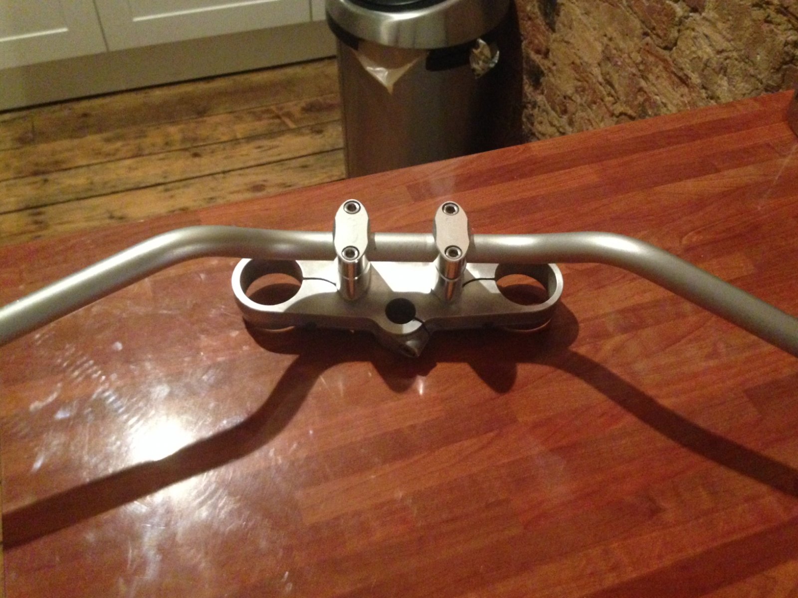

    Also, got hold of these street fighter style bars (photo). Haven't put them on yet, but looking forward to it!

  10. thanks for that Dude
    my son's gonna the main rider - he is 6' 4"
    So will look at comfort.
