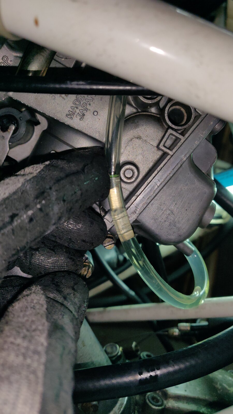

    Got the new chokes fitted, and set the floats to ~14mm (square side of float). I checked the float height afterwards with the clear tube and it was on both carbs next to the cast feature. So all good.

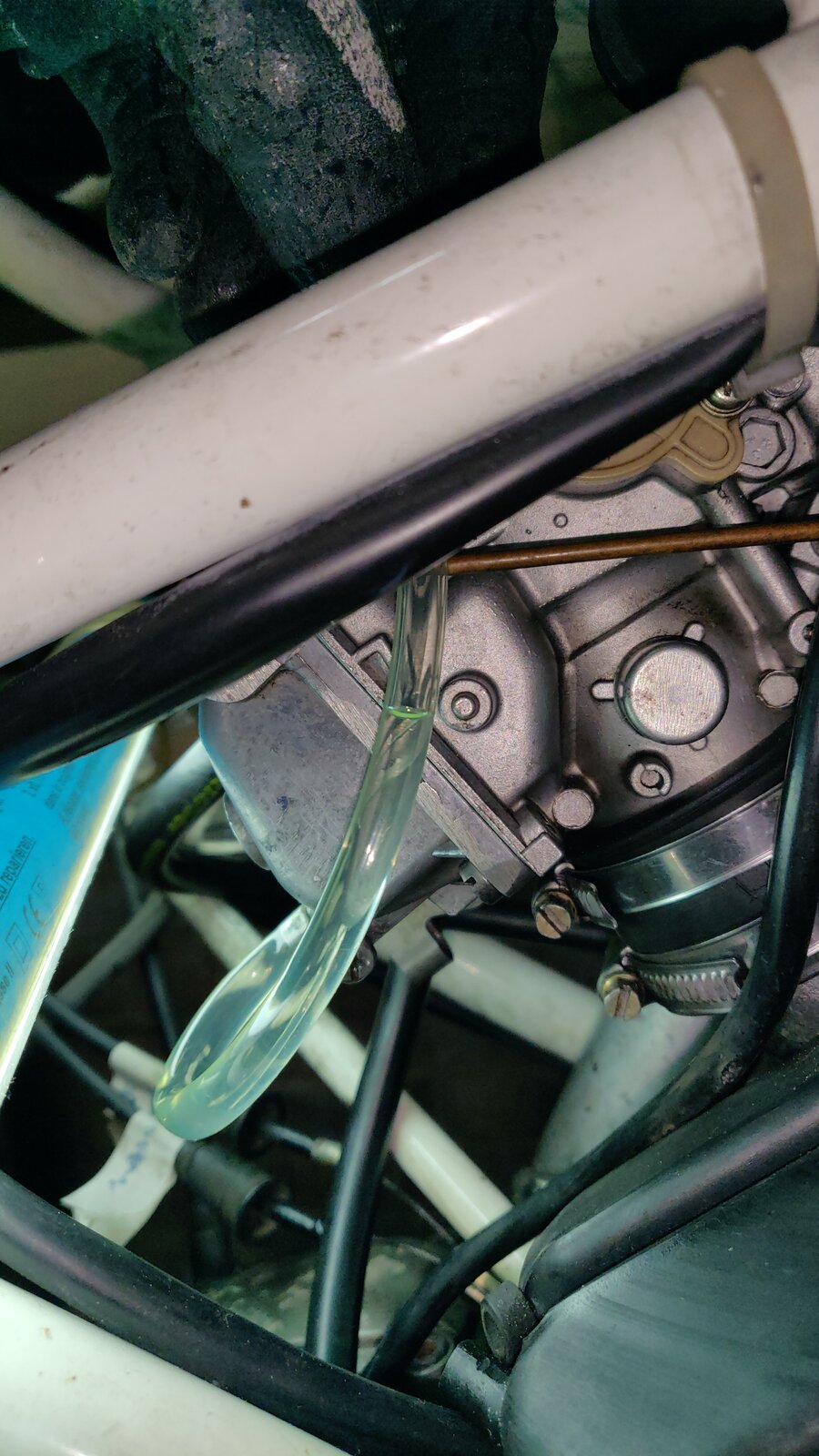

    I build my own carb sync tool, out of 2 milk bottles :D and some screenwash... I love the beauty of science. Most expensive bit were the 2 screw nipples. First attempt was just to see what was happening, and it showed stronger vac on the right carb/hori cylinder.
    First I tried to change the pilot screw, but quickly realised that not the right way. So moved onto the sync screw between the carbs. What a pain to get there and look at the gauge.... (note to myself: were helmet when crawling under the bike..... autsch :D )
    Played around with the sync screw and I was able to balance them, but couldn't get a stable condition. After a blib on the throttle it felt it was moving away the other way.... and it was a bit like ping pong
    top is vertical and bottom is horizontal cyclinder.
    I will hang the bottles up next time, recording video, adjusting the screw and watching the bottles is difficult to juggle :D

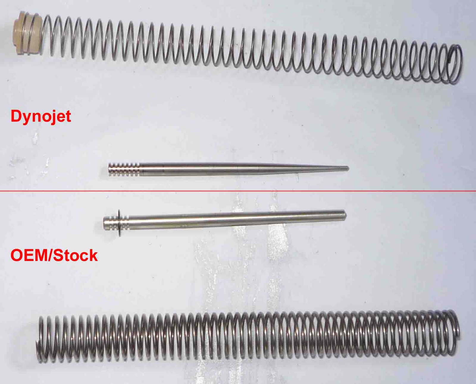

  14. The jet number 6 is the main jet....do not confuse jet sizes between OEM/stock and Dynojet jets***.....they are calibrated by the manufacturers using an entirely different method.
    ***The Mikuni OEM main jet should be 140.
    A Dynojet main would be between between YJ116 and YJ124 for a Stage One kit......for Stage Two -between YJ140 to YJ150. ***As mentioned The Mikuni 140 is not the same as Dynojet140.
    All the OEM Mikuni jets and needles will have the size and a little square logo stamped on them. The other two jets will be 70 (starter jet) and 42.5 (pilot jet).....not Dynojet.....Mikuni only.
    Dynojet jets only have the size marked......the needles have no markings.
    While you are checking things I assume you have taken the pilot screws right out to see if the spring, tiny washer and O-ring are present and intact.......Lumbux was having trouble with his 750SS which sounds similar to your problem, IIRC we discovered an O-ring was missing from one carb, so the pilot circuit was drawing air through the pilot screw thread even though the screw was in place.
    Before you start buying new jets check the photo below so you can see what you have in the carbs.....notice the difference in the needles and how much 'flimsier' the Dynojet spring is.
