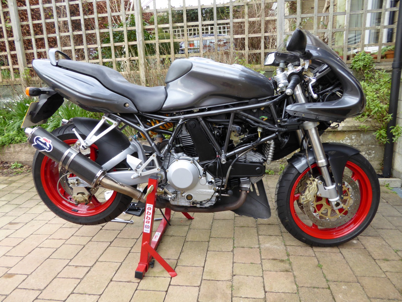

  18. So - here's a picture of the bike a couple of weekends ago - half of the fairing is on... Now I can see that I could have spent an awful lot more time (and money) on this project. But I like the frame colour, and it's so much smarter than when I started.
    However....

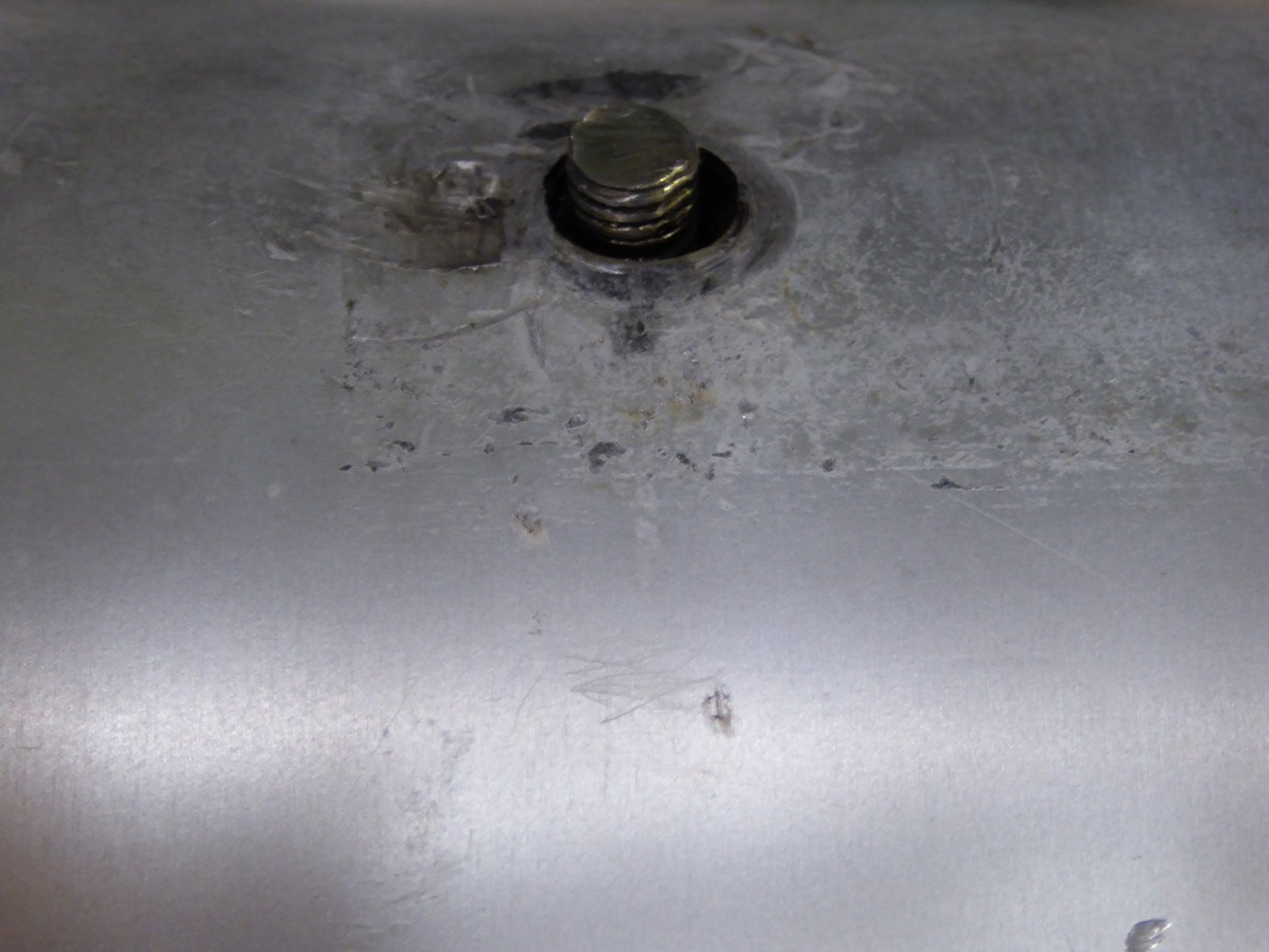

    ... in a fit of enthusiasm, I bought a 2nd hand pair of OEM cans. It's in case I have trouble at MOT time. But one of the mounting bolts is sawn through, as you can see in this pic...
    The reason that it had been cut is that the nut below just spins, so it can't be undone. B******s! I do wish that the seller had been upfront with this! Broken mountings are an automatic MOT failure, so unless I can fix it, it's no use. Any ideas how I can sort this? I don't think that trying to fill the space with epoxy would work, as it'll be greasy in there. I thought perhaps drilling a small (2mm?) hole through the ally skin and into the nut below, and then putting a pin in there might be a solution to jam the nut, but has anyone a better idea?
