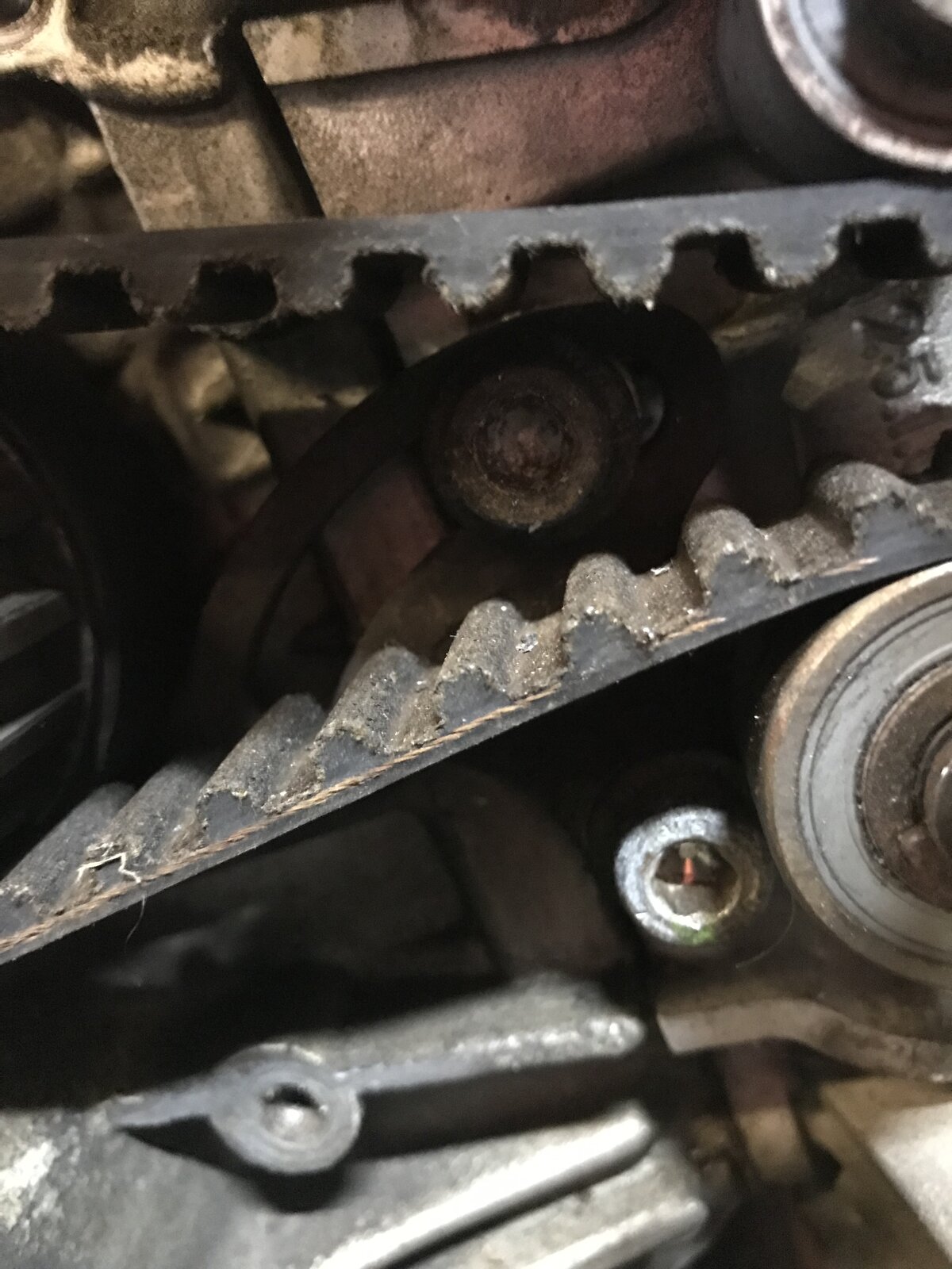

    Thought I’d do the belts today.
    The tensioner bolts, in my opinion, have been over tightened. The top one in the pic above is knackered.
    Any idea how I undo it ?
  12. You could try tapping a slightly oversize torx or star bit into it with a hammer, hopefully it will grab it well enough to undo.
  13. Yep, you need to change the belts alright.
    I had the same problem on my 750 with the bolts - the torx method didn't work, either.
    So I drilled the head off and then found the remaining thread was loose and undid it with my fingers. If it is a bit tight carefully drill a small hole into it by say 3mm and use a bit or screwdriver to bring it out.
    FYI, I got fed up with Ducati's OEM cheese low head bolts which should be the ones that are used for the belt tensioners and brake discs, so I bought a huge number of good stainless ones. I have plenty left - ;)
  14. Just tried the torx method, and no didn’t work. Worth a try though.
    Next step the drill.
    What’s the best place to source the stainless ones ?
  15. Got it out in the end.
    Resorted to air hammer to cut a slot and then angled the air hammer to loosen it.

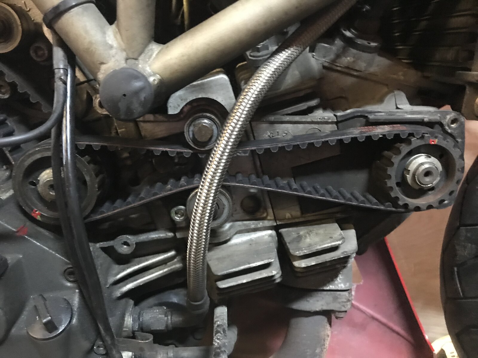

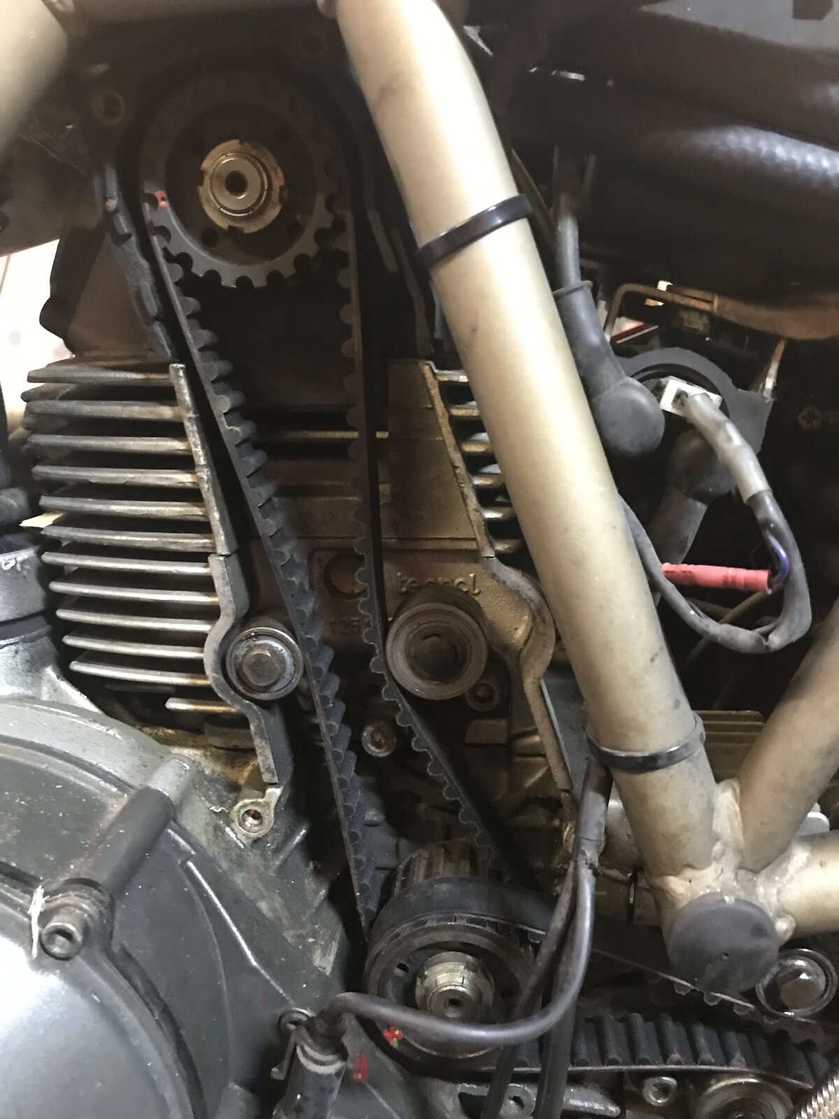

  16. A589D3EC-F56C-4BBE-9ADA-499FA86AC36B.jpeg 33ED0BD9-E6B3-4ED9-8790-C5B698F1AE7C.jpeg New belts on. Not tensioned yet as need to get new bolts :mad:
  17. PM me your address etc, and I will stick some in the post. The ones I have are M8 Low socket head 20mm long. I can't recall what the length of the tensioner ones are; because at some stage I had to cut some old brake disc ones down slightly but I don't remember why!
