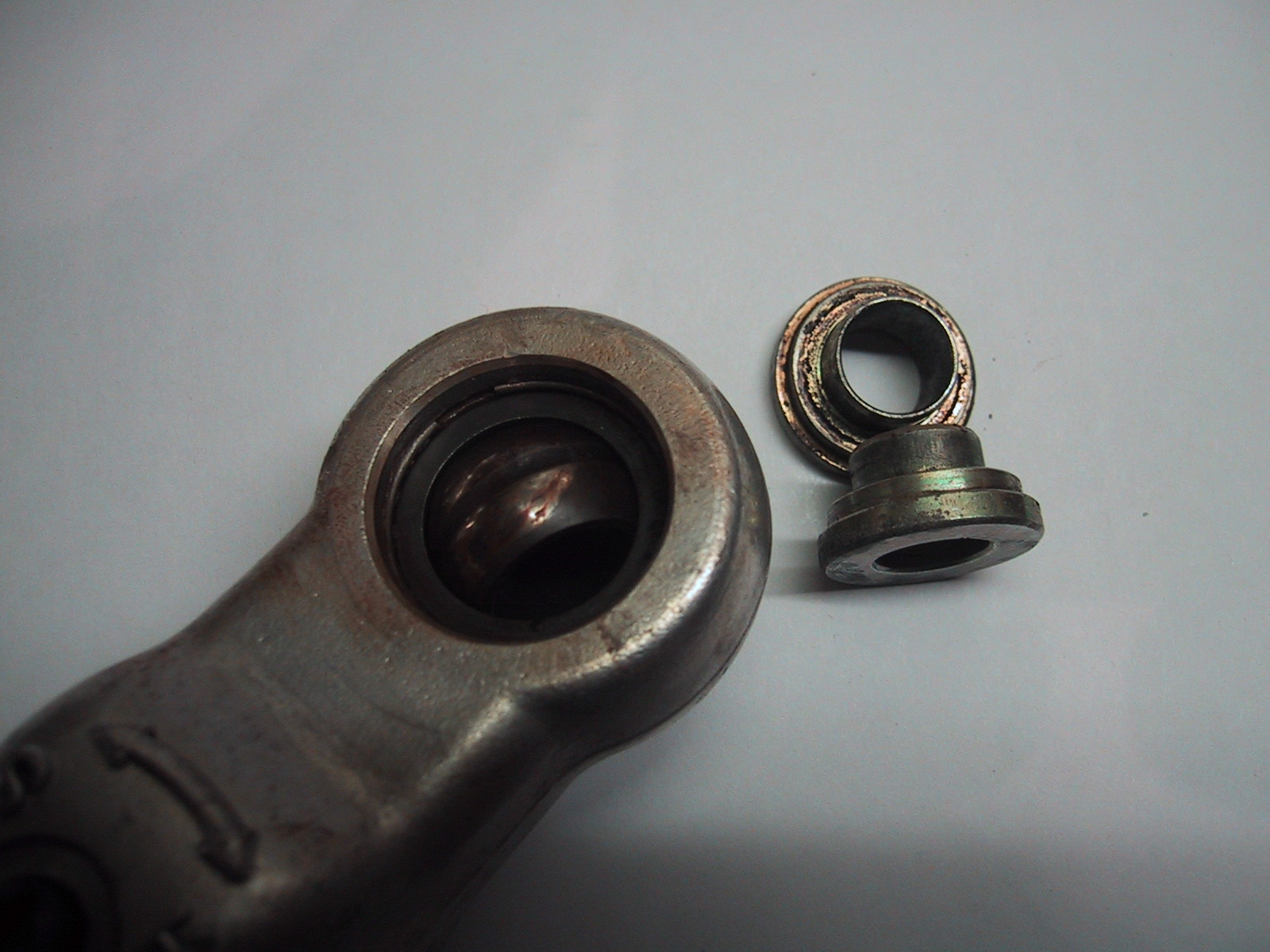

  6. If you pull out the top hat bushes, there is one pressed in from each side, you will find a rubber o-ring like seal on each side to keep the weather out. The bearing is behind the rubber seals. If your's is a Showa shock then that is the correct bearing.

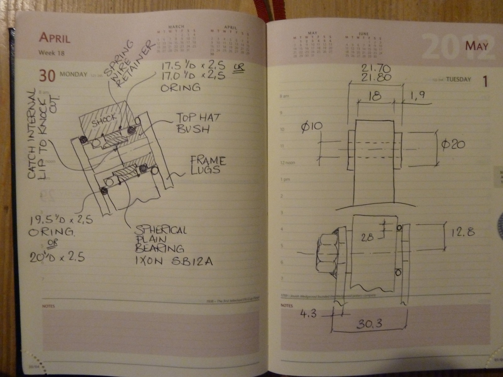

  10. A few pics
    I think one of the other post says which o ring I went for. Just checked it was the 17.5 i,d, P1000473.JPG
    As mentioned I was olso going to get a skt hd cap screw with more shank, think its a toss up between 60 & 65 long and then cut to length. Also I think ALs idea of shimming with thin washers would be bettter than bending lugs as previously mentioned.

    Another thing chaps, are the rubber seals o rings or flat section, and are they both the same size? Actually are the top hat bushes the same both sides, possibly not from your dwg? Looking at your lovely cut away dwgs makes me think we had the same Technical Drawing teacher at school, I only found out years later he was a Spitfire pilot during WWII.
    #32 ush1000, Feb 23, 2018
  12. top hats are both the same

    It's a while ago since I stripped it and can't remember if they are square or round, but I put the 17.5 I.D. O-rings back in. I also plan to try and put a 19.5 / 20 I.D. O-ring on the outside to try to give a bit more weather / water protection. Don't think this was standard, just thought it would help and seen it on other threads. Wish I had a Tech drawing teacher who flew Spitfires, don't think much drawing would get done though.
