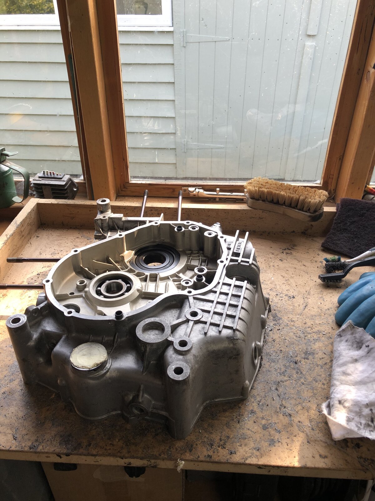

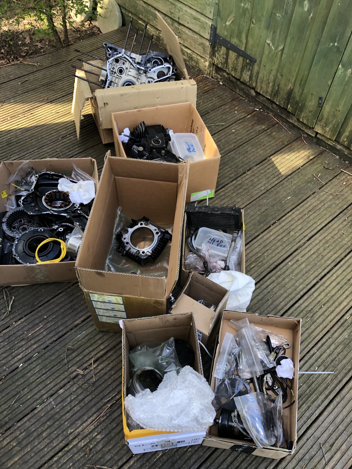

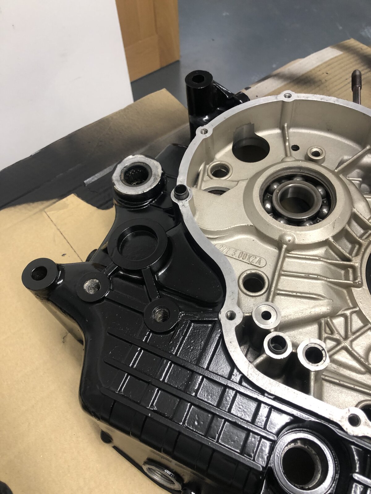

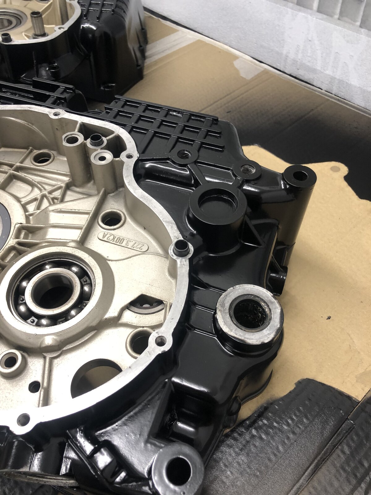

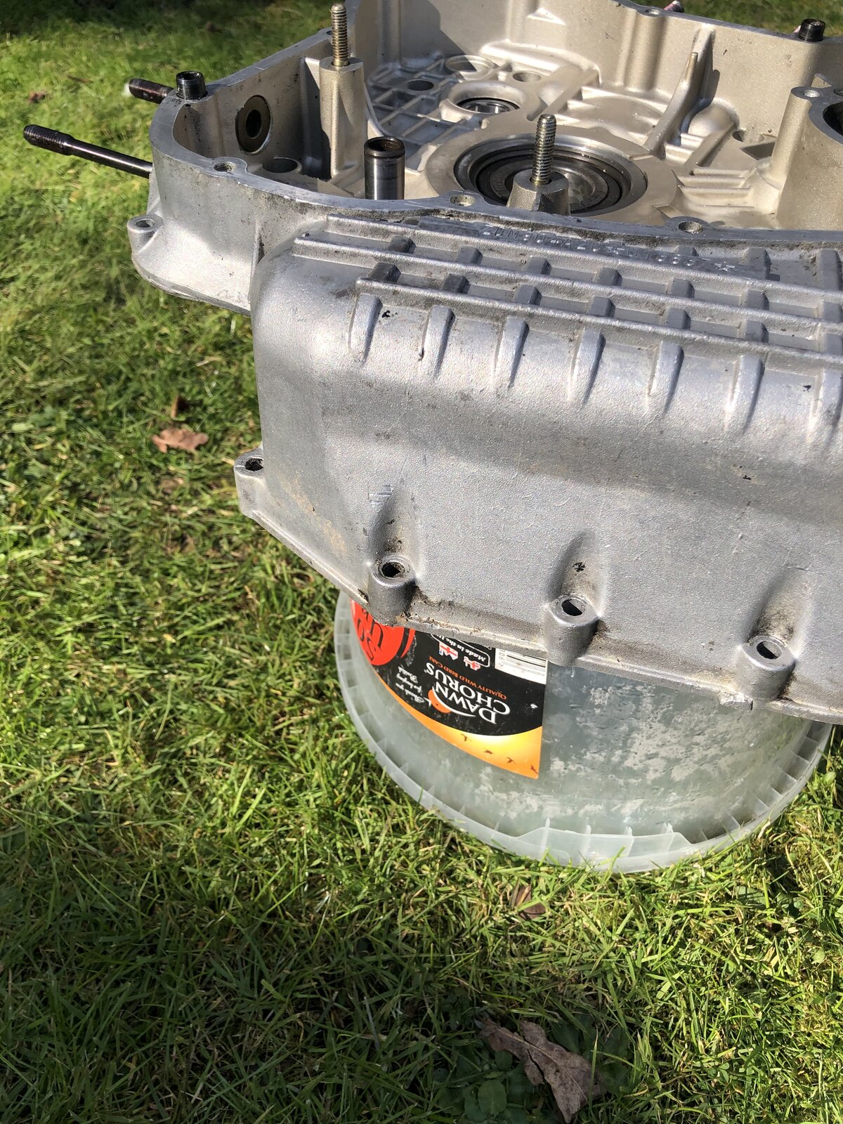

    I dropped the engine into Glen at Moto V near Colchester Essex last week and picked it up today so i can strip and paint everything and zinc a few bolts etc,
    Gallery plug all good it will be centre punched around the edge when refitted.

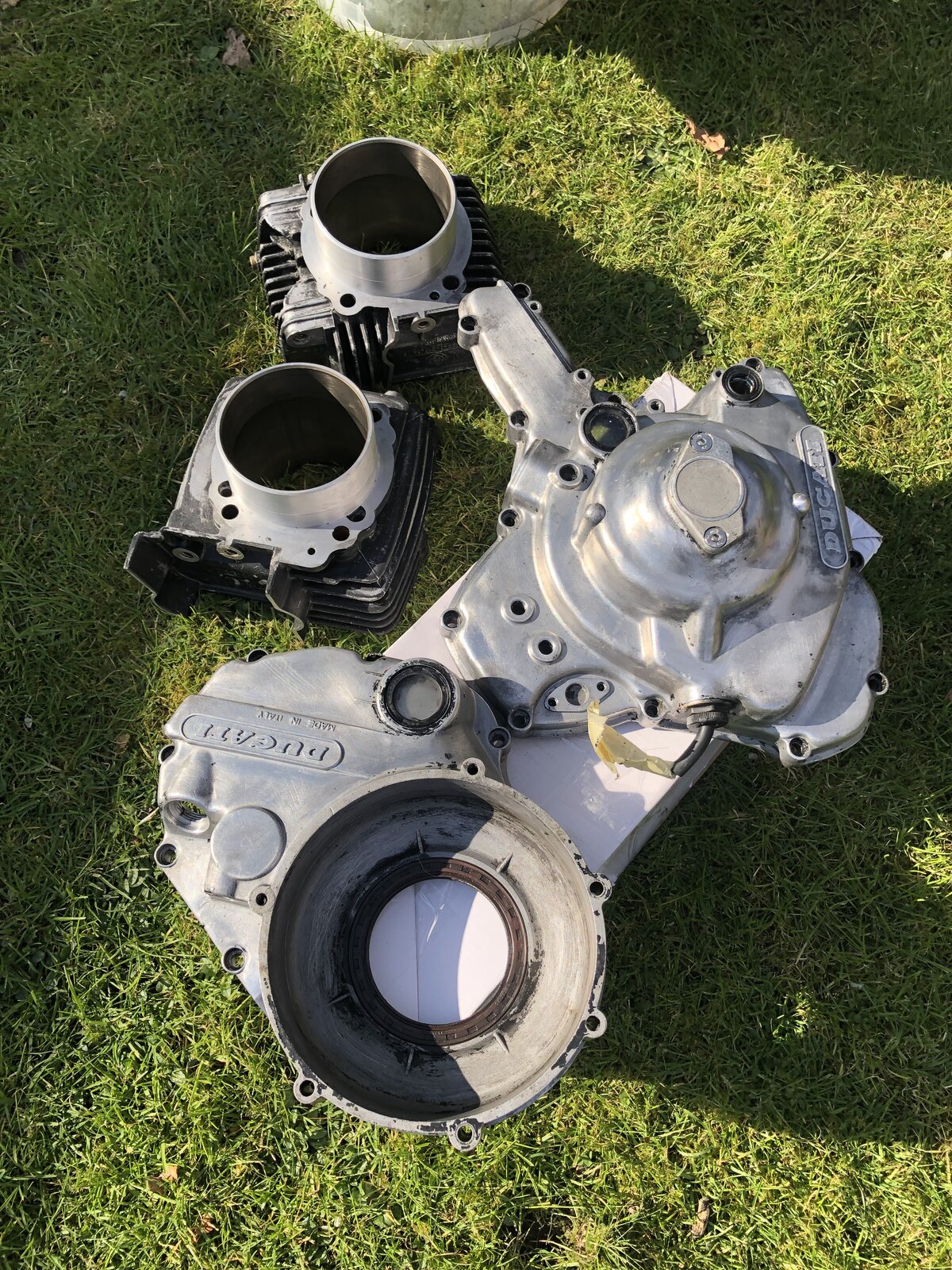

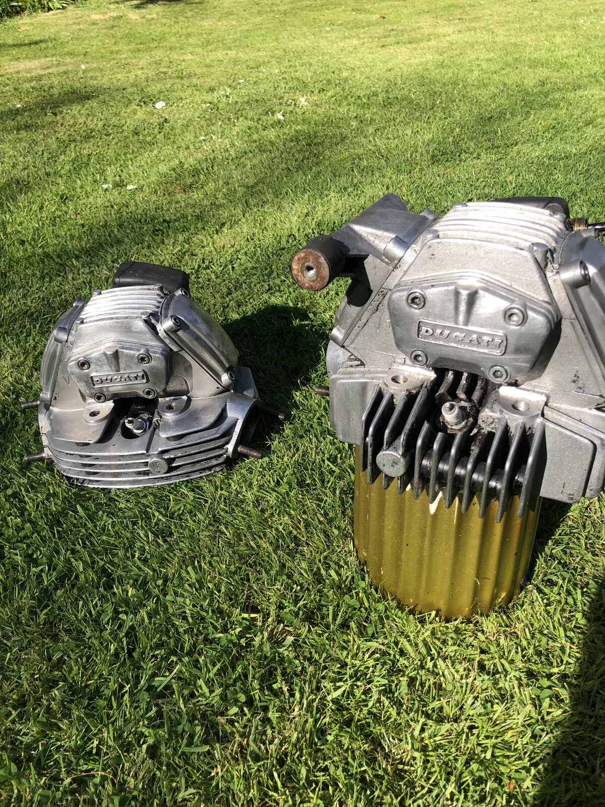

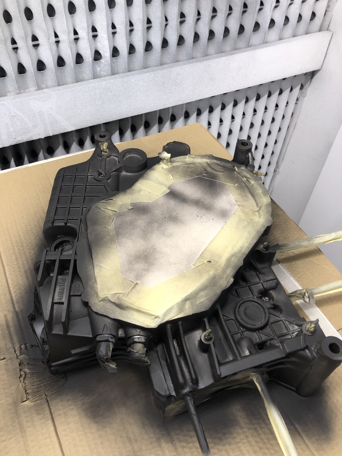

  6. Got myself some decent paint stripper and made a worktop board with sides to stop all the crap falling out everywhere,
    Just got heads left to strip then it’s painting time,
  7. Paint it once, paint it forever. Aqua blast & ACF 50, but each to their own.
    Cheers Gaz

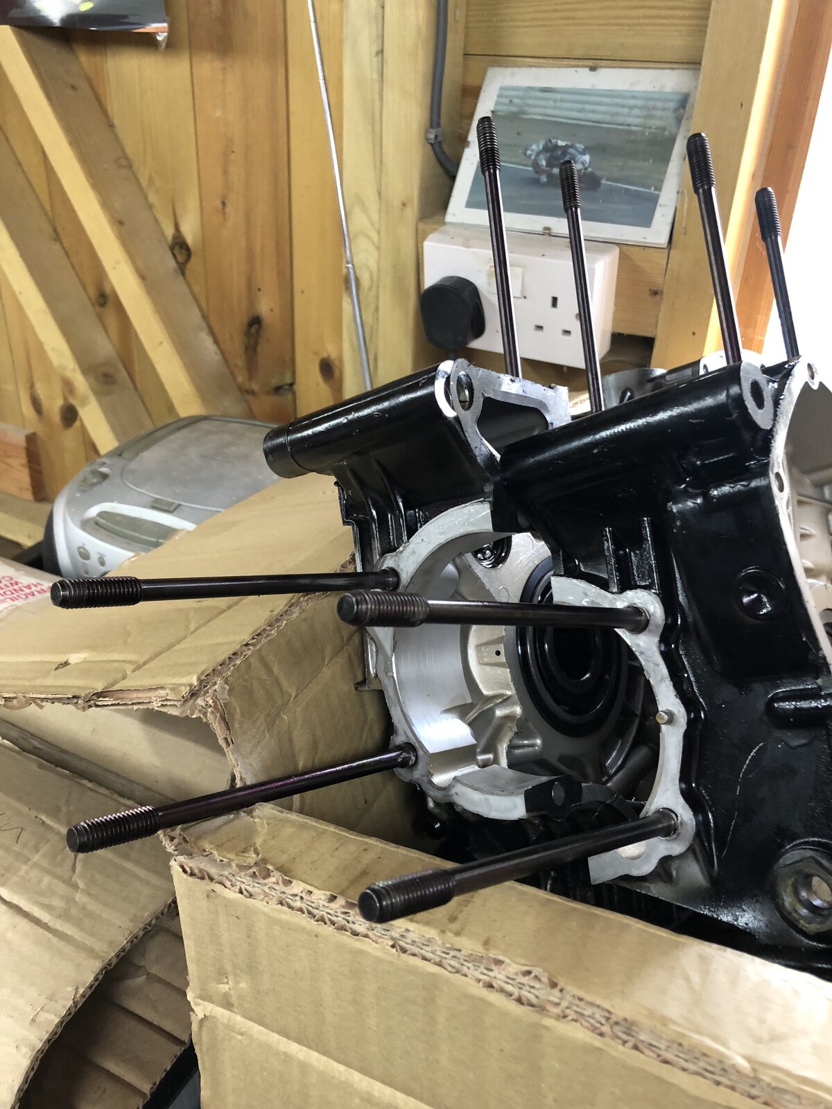

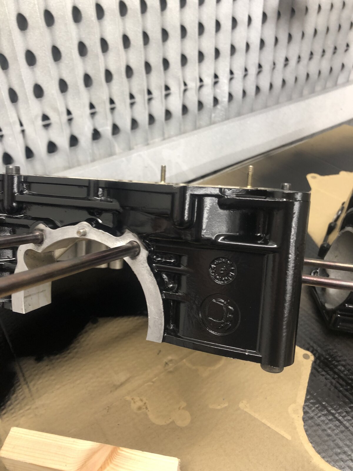

  8. Was going the Aqua route but now probably all black, gloss barrels/head, satin cases, grey valve covers and oil cooler bracket and bolts plated.
  9. Little up date, last of the paint stripping.

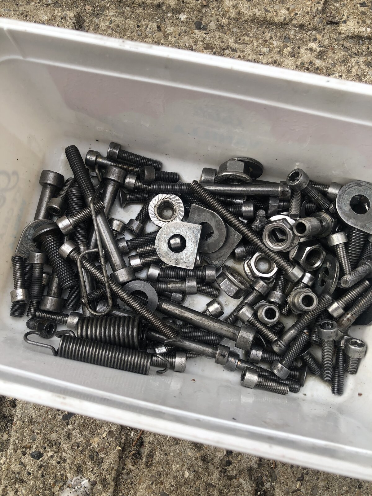

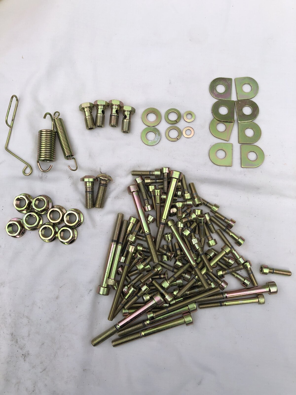

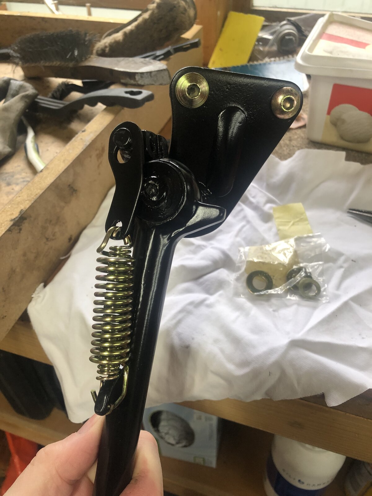

  12. Gradually making more progress, all engine bolts etc plated.
    #152 Roadtrip, Aug 7, 2025

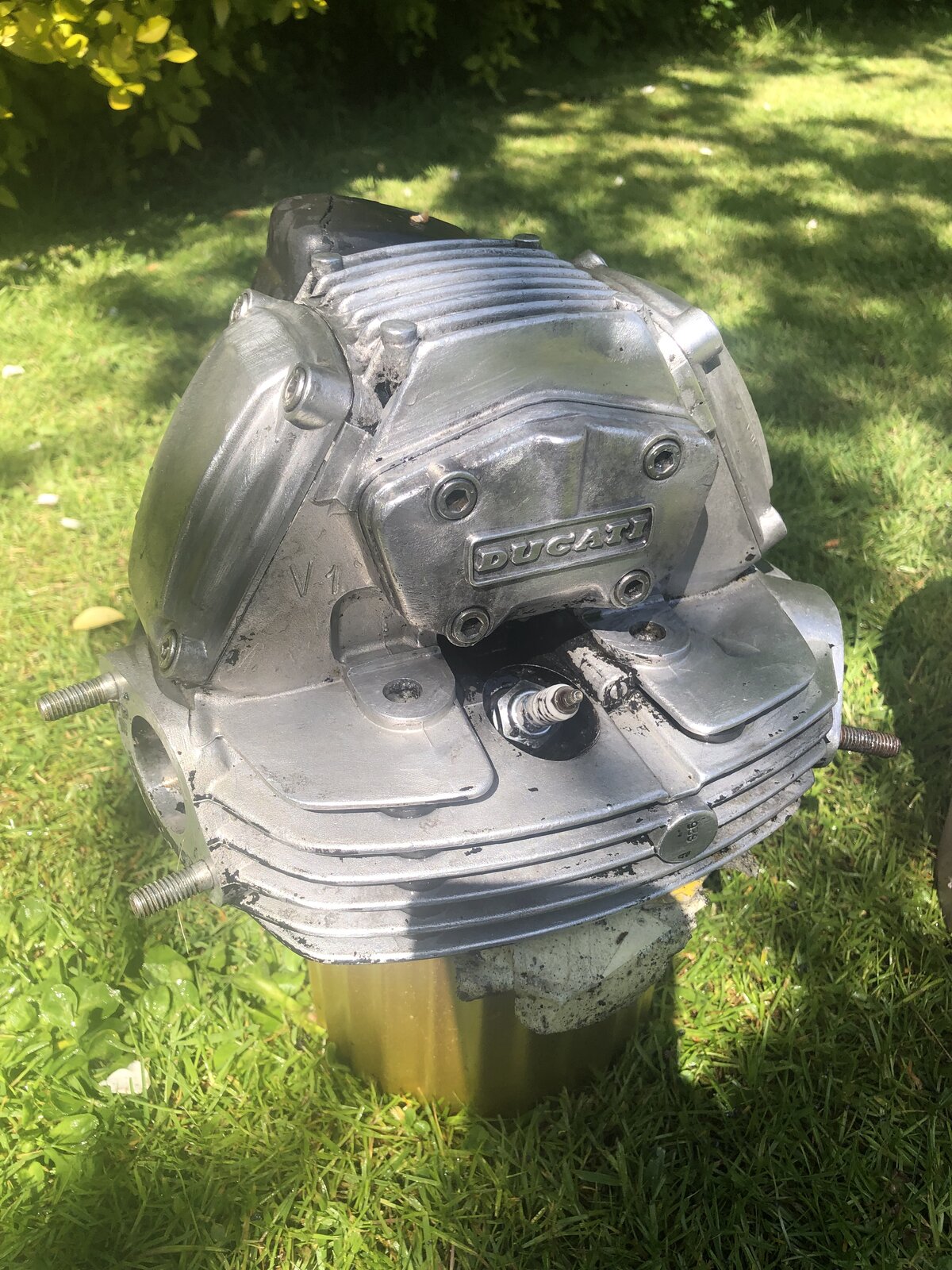

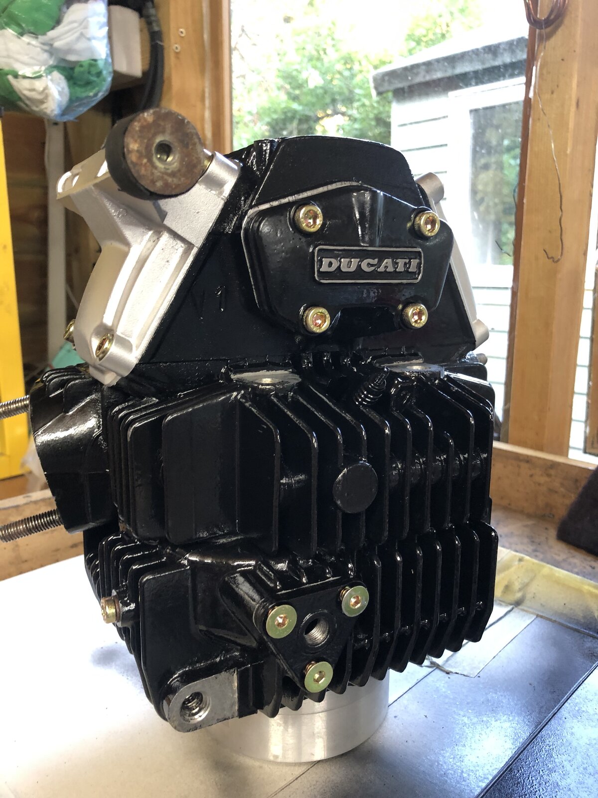

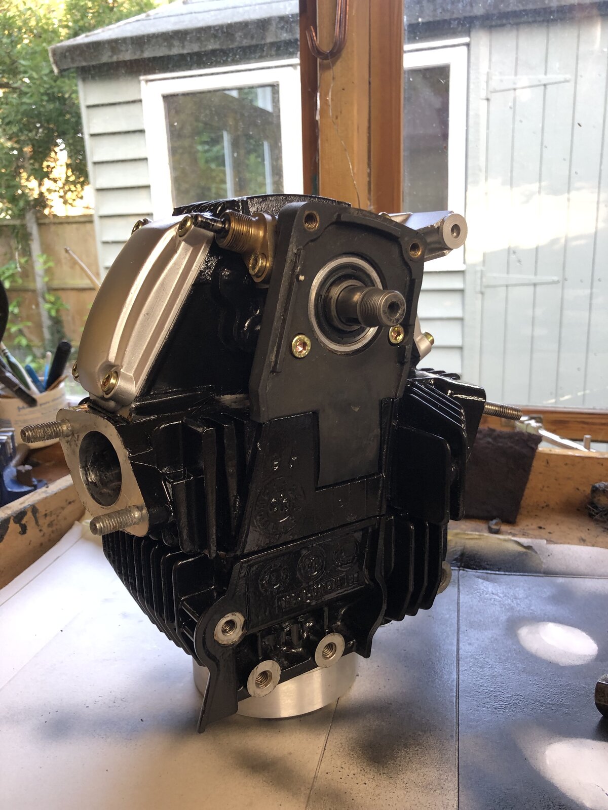

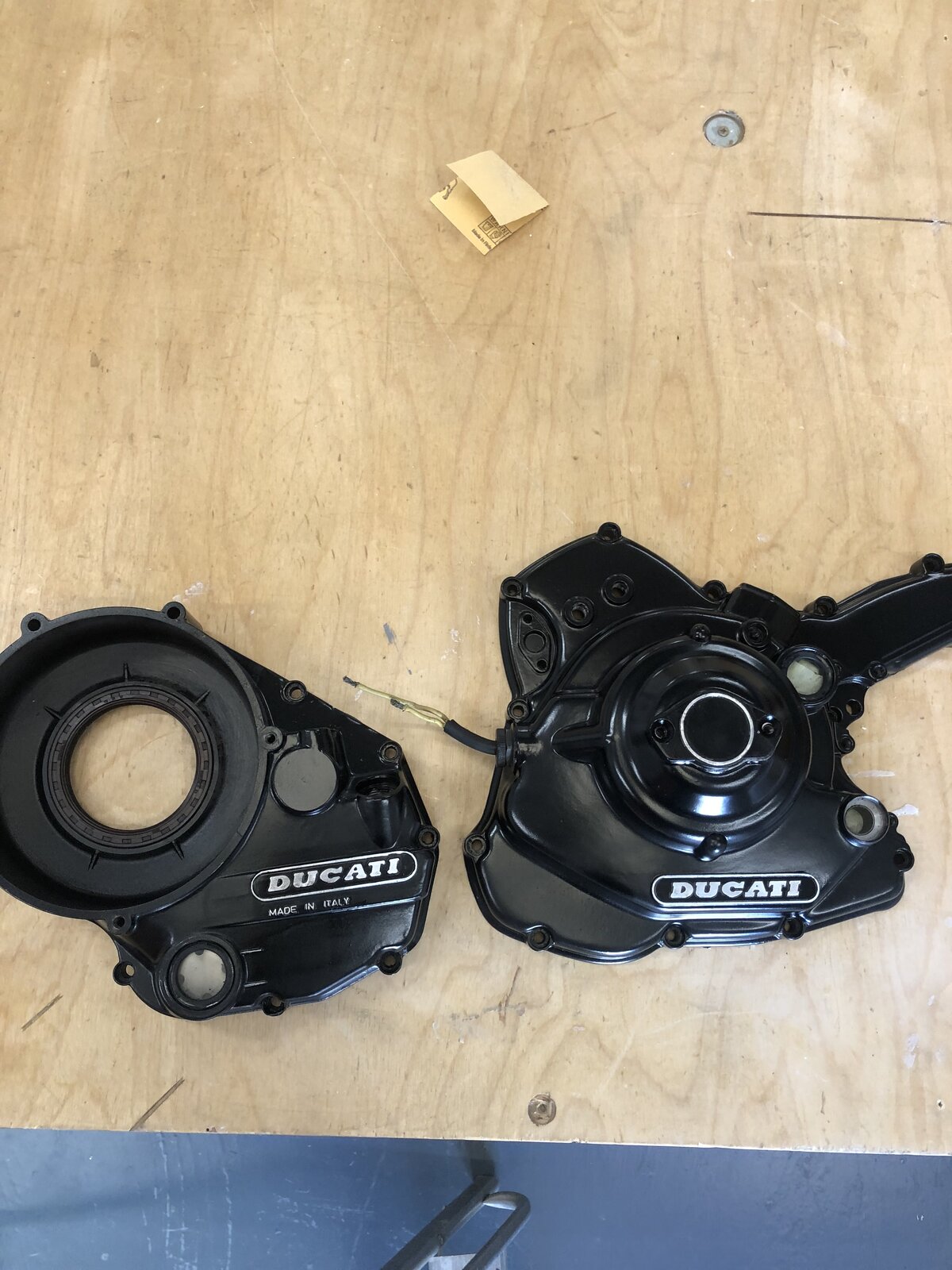

  13. Paint work finished on the top end with bolts loosely in to help when valves are all taken out for a clean/check and rebuild.
    Need to order new inner belt covers as mine are both cracked,
    • Like Like x 7

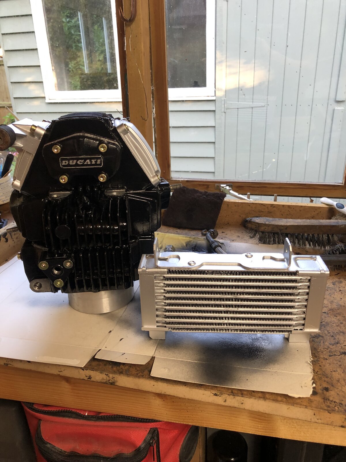

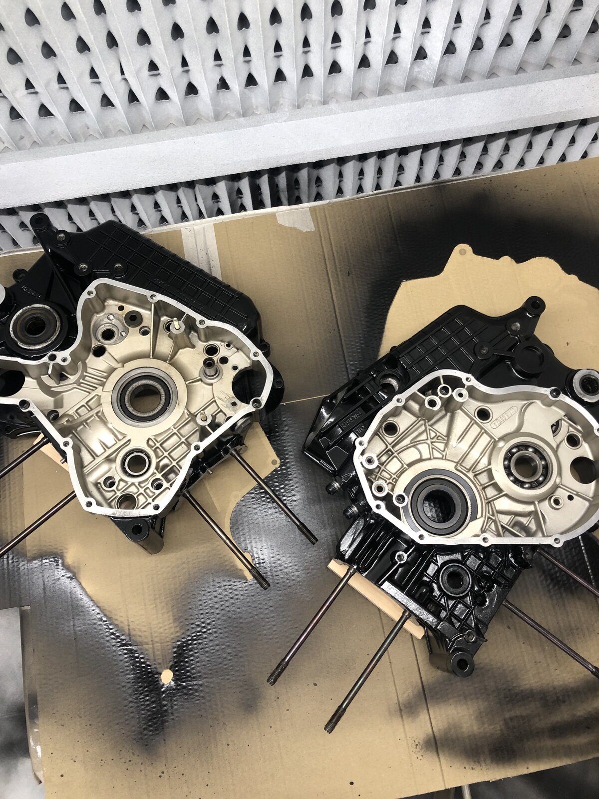

  14. Last of the spraying done now,
    I did a light dusting with lidl Parkside first which has a big spray fan and covers very well then 4 coats of Hammerite satin.
