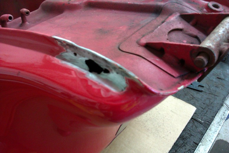

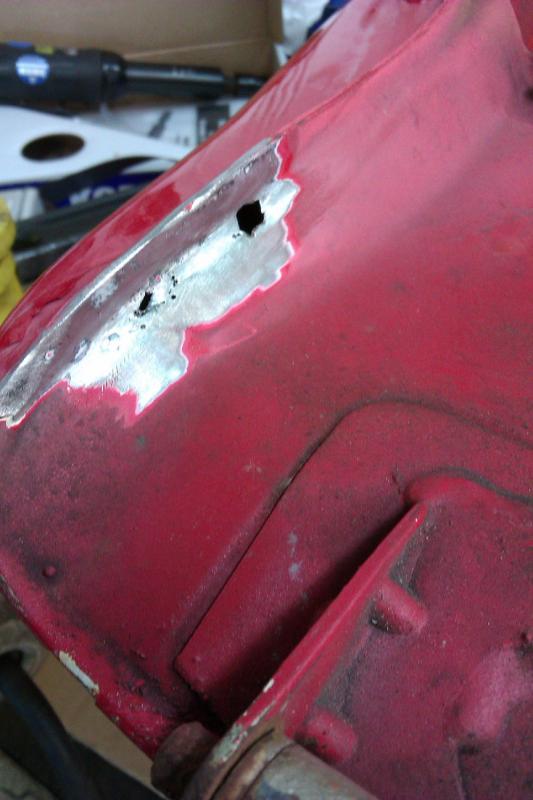

    the outcome of that was this!!

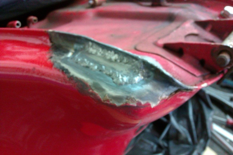

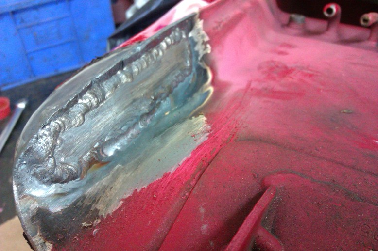

    Big blooming holes either side of the offside back seam. I managed to use our workshop TIG welder and some little thin strips of stainless to patch it up, ending up with a pretty rough looking repair, was a bit of a rush job during works time.
    It still looks bad even after I painted over it, but it didn't leak when I put some water in. I've put some of the J-B stuff over the welded area and over the other side of the tank, it is meant to be petrol resistant and is like araldite, in that you mix it up out of 2 tubes.
    The tank is fairly rusty inside still, just hoping it hangs in there for a few years.

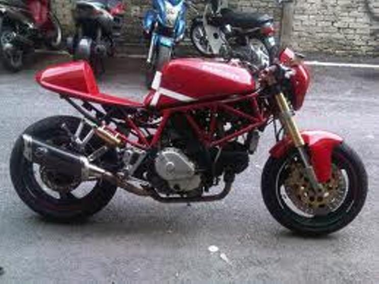

    On another note I found this picture of a naked SS which I think looks great:
    Would love to do this to mine.
