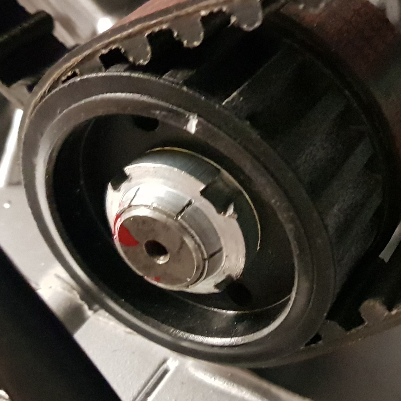

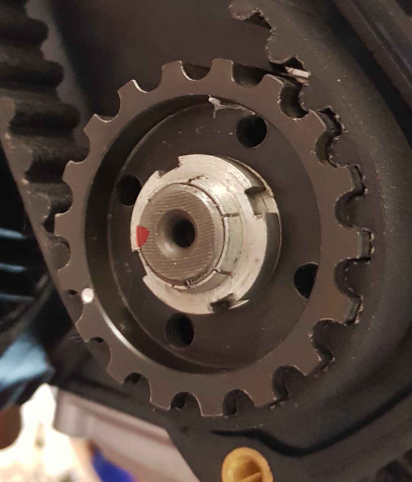

  7. not sure of the years introduced or sequence but do you remember the central, common outer pulley in picture having a "guide" incorporated in the outermost face as a deterrent for belt creeping off? I don't think the very late 2V engines had them at all. Around Pantah/2valve belt introduction time, this guide was a separate ring that was spotwelded onto the pulley in only around 3 places from memory and so could work loose/fracture and detach completely.
  8. There was one on each pulley of my '97 750.....never seemed they would come off easily.
    I think Ghost had his come off because IIRC as it was a race bike he used to change his belts quickly by pulling them off and putting them back on afterwards.
  9. You can only speak as you find - one of my early Elefants had one that was part fractured and so I removed it, and so wasn't at all surprised when Cagiva/Ducati went to the trouble and expense of making the guide one-piece for later engines, they certainly wouldn't have done so without good reason.
  10. Mine weren't one piece but they certainly wouldn't come off. I gave up trying.
  11. Ok, thanks for the info
  12. as Alan said, at one point they were on the cam sprockets as well and it was this configuration that made belt replacement on the horizontal head more difficult than later versions.
  13. As mentioned, I had them on my '97 750 on all three pulleys, but I found a quick dodge for easy belt replacement.
    When you slacken a belt off, lift the loose belt up a bit, so you can swing the movable adjuster idler under the belt from the outside to the inside of the belt. Belt just lifts off over the flanges easily.
    Well, it works on the 750 and 600.....I don't know about the 900.
  14. These were the only 2 types of pulley I was aware of..... 20190617_150637.jpg 20190617_150651.jpg
