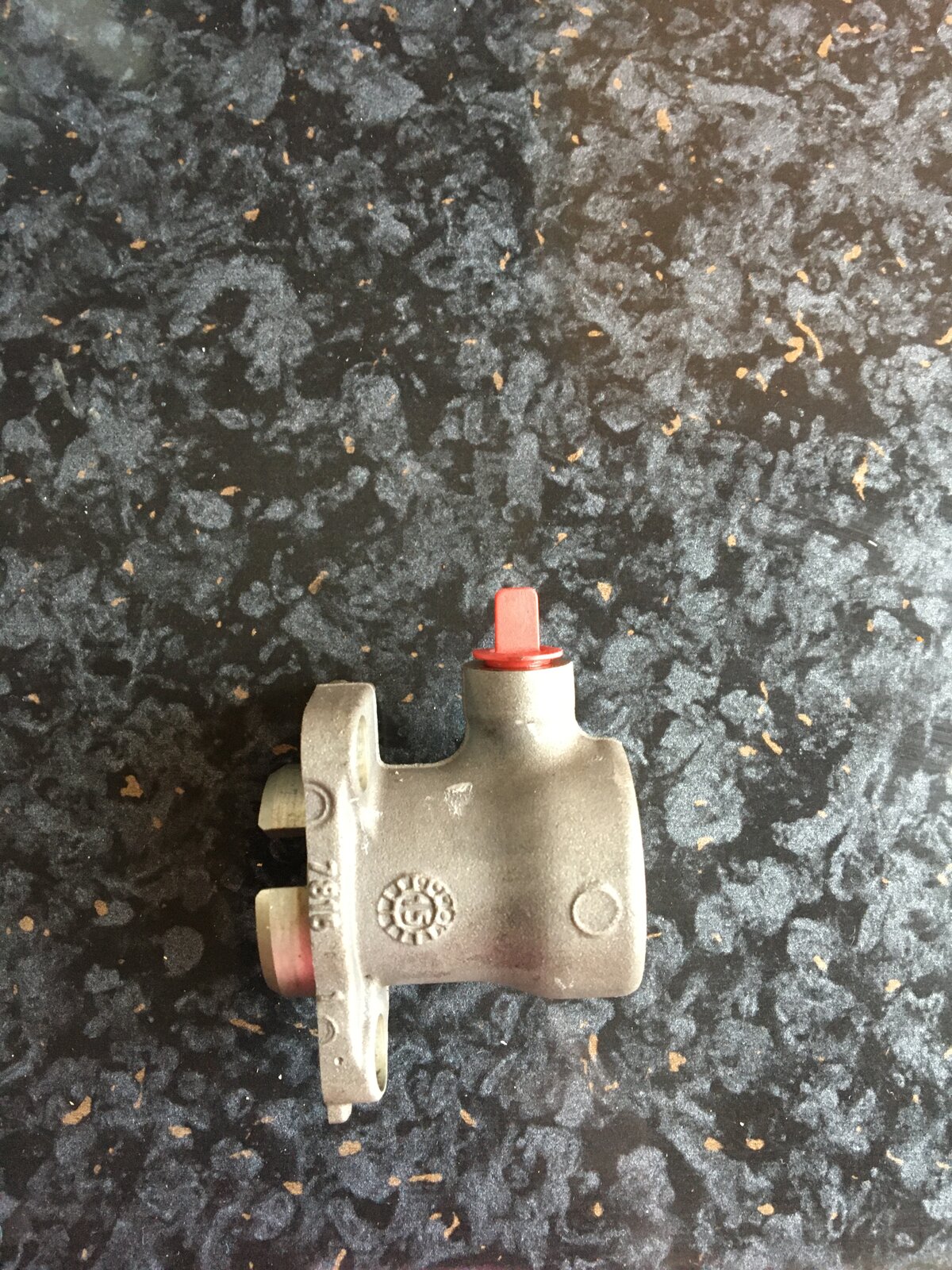

  5. @Cotters, this any good? Just dug it out. Came off my 998S.
    566F2AD6-69CD-4566-B15F-86885B876C4A.jpeg 140F657D-3B87-4776-B4CE-C56F8BA82563.jpeg F389ADFC-76AE-49B2-992D-1157E4EA7B18.jpeg

  7. The later cylinders will fit just fine. Again, not sure it’ll make the pull any lighter. Only thing you need to watch is that the pushrod length changed on the later bikes, so you’ll either need the longer push rod or fit a 10mm spacer into the cylinder piston before bolting it up.
