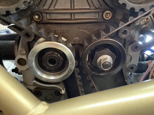

  4. Yes I did
  5. And I thought mine were close. Are they also new Ducati belts?
  6. Yup luckily I’ve only started it up once :bucktooth: rechecking them now

  10. Very nearly , it’s a poor pic But disaster averted thanks to this thread :beer:

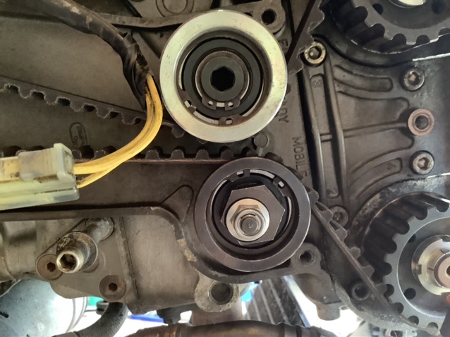

  11. Well swopped horizontal belt to vertical, tensioned with facom and 5mm test a little better 335412B6-4E41-42C5-A07C-BC8392DE1712.jpeg 335412B6-4E41-42C5-A07C-BC8392DE1712.jpeg 2FA7C304-1F92-407D-9558-D72B4360B029.jpeg
  12. So I suppose the question is How close is to close?
  13. Difficult to measure but horizontal 3mm vertical 4mm clearance
    I’ve dug some old belts out All low miles. genuine 2015ish
    Exact fitt 2018 ish
    They all measure the same give or take a few hundredths of a mill
    But the new genuine belts feel and look different

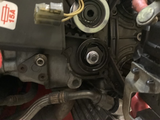

  14. Here’s my 1098 horizontal cylinder belt for comparison. Obviously not the same bike but belts have plenty of spacing.
  15. Here’s mine 998s horizontal.
