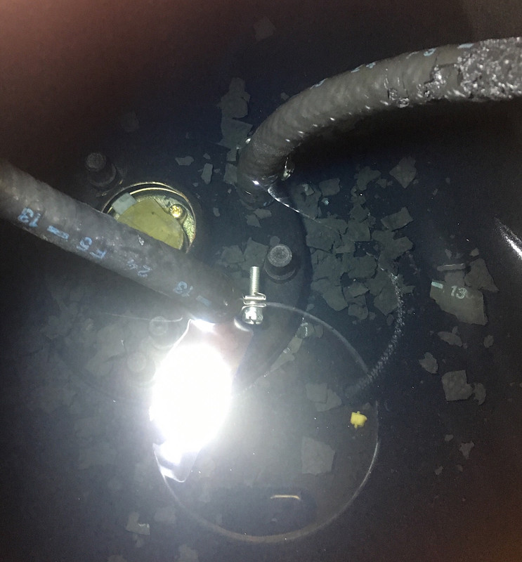

    You may want to take a look inside the fuel tank and check the fuel lines that are immersed in the fuel. They tend to deteriorate with time and leave lots of small rubber bits that clog the fuel pump and/or filter.
    This is what it looks like when that happens. IMG_0304.jpeg IMG_0305.jpeg IMG_0306.jpeg
  4. Thanks for the replies, and yes i was thinking fuel filter and lines, although i changed the filter when i first got the bike and the lines looked OK at the time, i'll get the tank off and have a look, what diameters are the fuel lines so i can get a length ordered?
