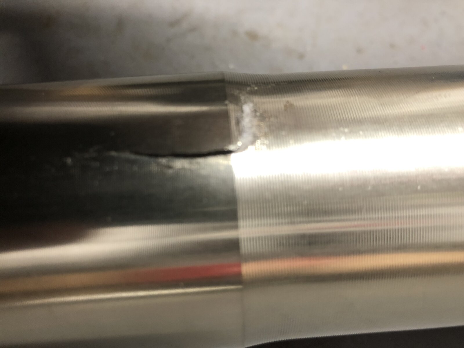

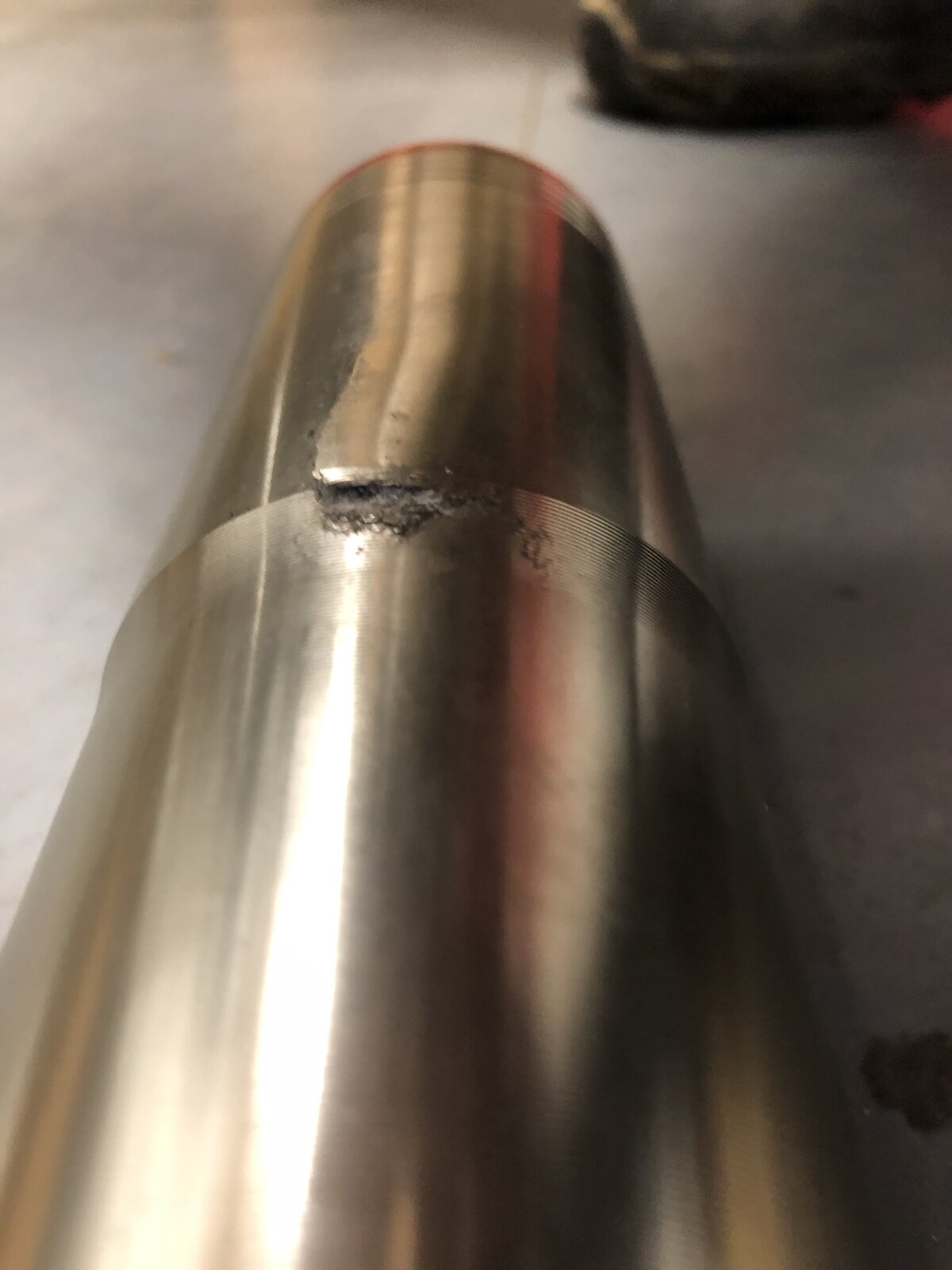

  1. EFB5C302-675A-496E-A994-5DCD13C47233.jpeg Has anyone seen anything like this before and any contacts for repairs to something like this? 48FB9136-BB76-4305-937E-5C89B0E656A2.jpeg
  2. Hi Alan I think thats a common problem on the 916-996-998 its like the metal has burst from inside I replaced my 998s forks for the same reason , boonstra in Holland sent me a perfect used set for 300 euro , hope you get sorted
  3. I've seen a set off a 749 that were far worse than these. It's corrosion which has started where there has been a nick or a scratch in the anodised surface coating. The only real cure is replacement.
  4. Yep, one of my 748 forks went that way. If you find someone who can repair it let me know please. The issue is the ribbed texture of the fork leg, rub it down or blast it to remove the corrosion and you lose the ribbing as well. I got a replacement forks, 2nd hand for £150, less than the cost of any repair probably.

    #5 XH558, Jan 12, 2020
  6. Personally , I could never have confidence again , whatever the repair
    with damage that deep into the bulk of the metal .
    I'd go for replacement , if only for peace of mind .....
    .... but just my two chetrum worth .
  7. Cheapskate ! My opinion is worth at least 3 ngultrum. Andy
  8. My MV failed its MOT because of that. The tester I use is a MX rider he said he has seen forks snap because of this kind of corrosion
    I have a roll of clear Gaffa tape used for repairing poly tunnels. I put a strip of that on the front of my forks to protect from stone chips
    • Useful Useful x 2
  9. I searched all over to see if it could be repaired or get new uppers. You can't. I have set of Showas off my Duc and looked for them as well.
    You can get replacement lower stanchions though
  10. I believe it occurs where a stone chip breaks the surface of the anodised layer, moisture gets in and under the layer and begins to work it’s evil magic. Mine stood for a while so that didn’t help matters:(. The clear tape is a good idea.
    I only ever found complete fork replacements when I was looking, couldn’t find anyone who’d split them into component parts. Anyway, mine are now nice and blingy TiN coated:)

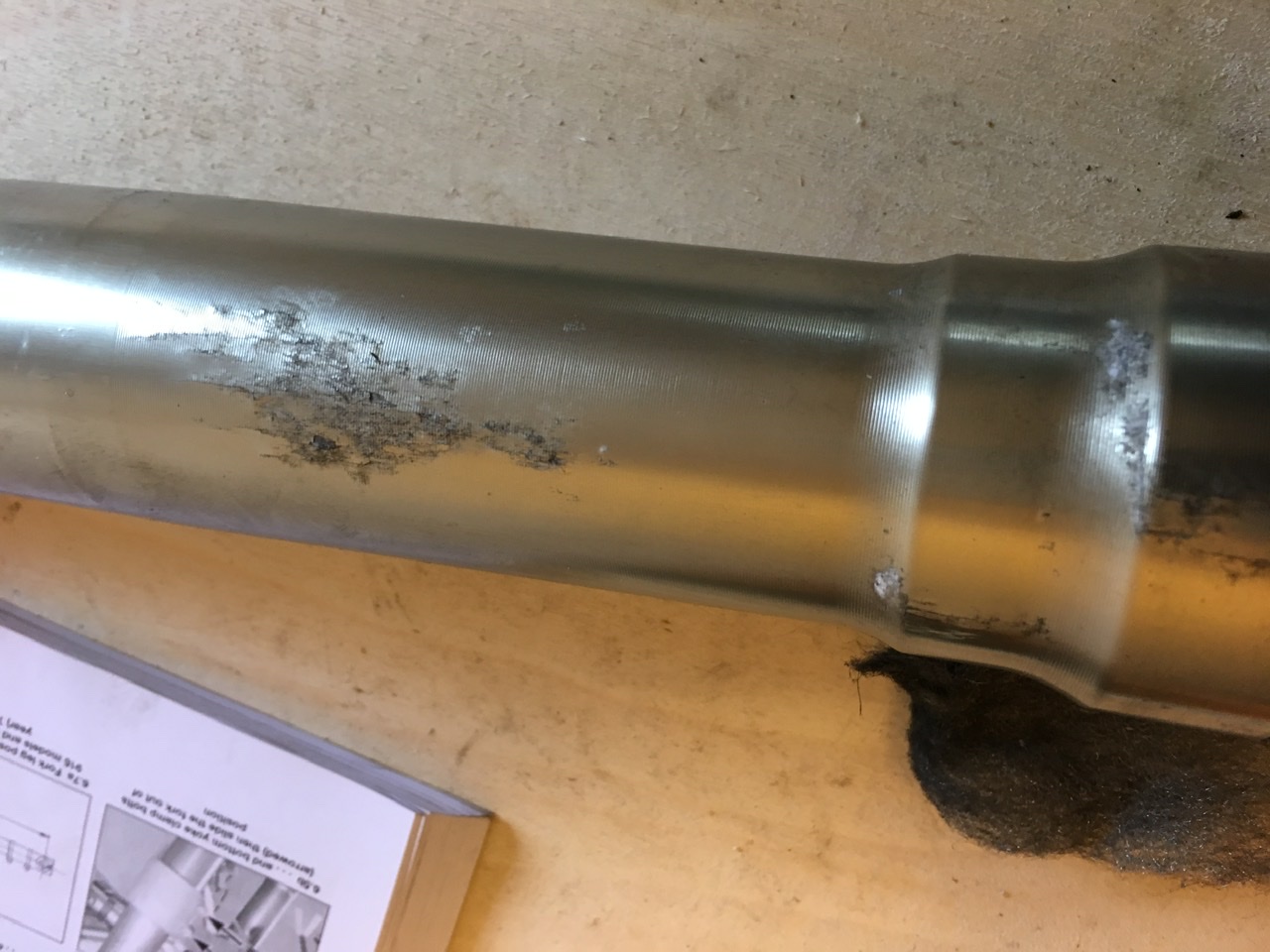

  12. Thanks for the input fellas.
    The full story is that these were a replacement set for my manky pitted forks.
    I paid very good money for them as I wasn’t happy when I saw them.
    They were advertised on eBay and the issue was described as “pitting”.
    IMO they’re way beyond that, so have asked for a refund so will see how that goes before I say anything more about the seller.
    Real shame as the rest of that fork and the other one are mint and the damage is in a position that you’d never see when built but I’m more concerned about the integrity of the fork and the damage spreading.
    I’ll update you when it’s sorted...
  13. Ok, I’ve found a right leg from a 1998 916 to replace the damaged one I pictured.
    My bike is 1995 - QUESTION - Will this fit my bike??
  14. The leg will fit but the brake won't fit the fork bottom. By 1998 the calipers had changed from 40mm bolt spacing to 65mm. You could of course swap the bottoms over.
  15. Yes, it'll fit just fine. Main difference is the brake mountings, but 916 were all 40mm afaik.
    You can get new outers but they are expensive, about £500. Good used forks are getting rare now, I've been after a set for my 748 and have accumulated enough to build a good set from parts.
  16. Yes that’s the one, how do I strip the bottom bracket off the old one???
  17. Your biggest problem is holding the tube, there is a grub screw on the inside of the fork bracket, then it is threaded on.
    Steve
  18. I think he should be able to swap the whole tube complete with fork bottom.
  19. It obviously depends on the condition of the old tube.
