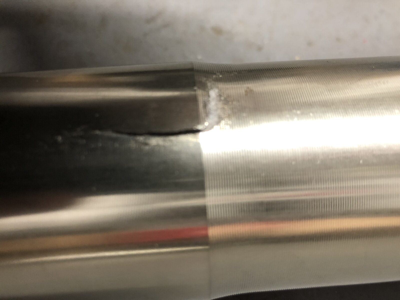

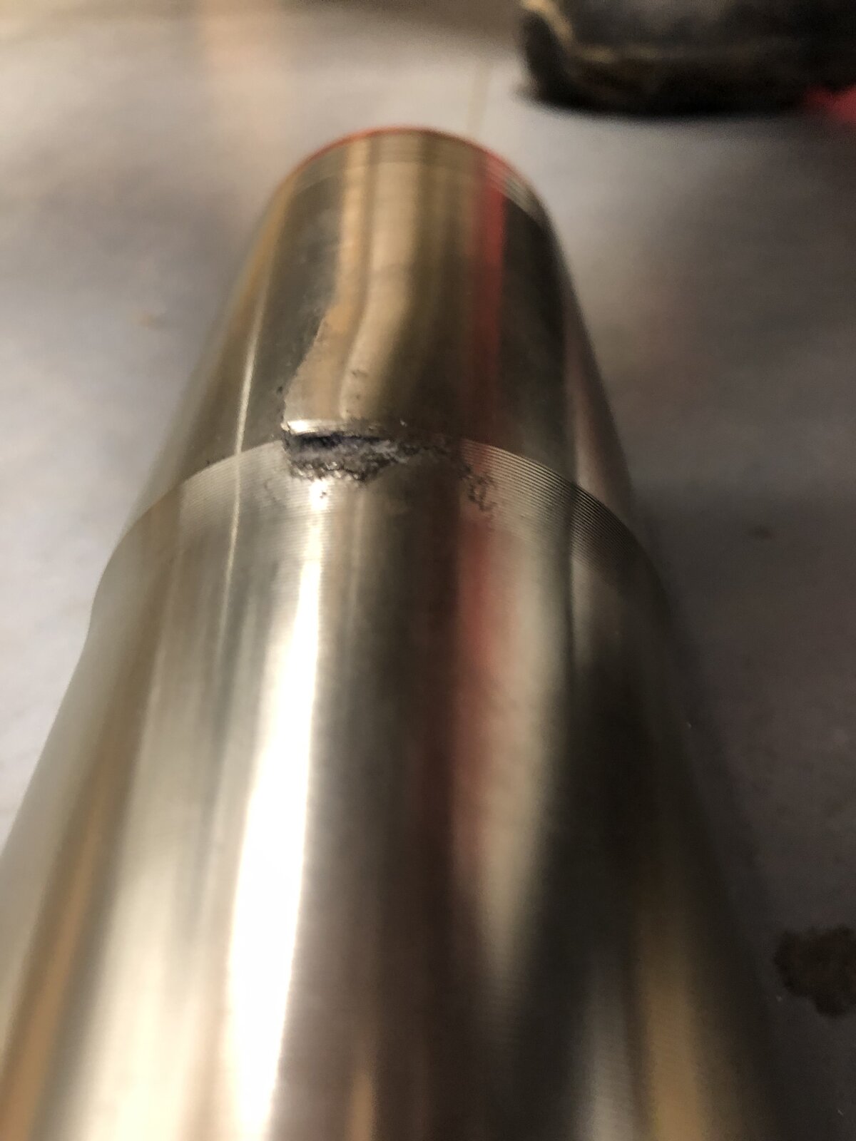

  1. Cheers boys, old tube is pitted so it’s swapping bottom bracket needed.
    Looking at it now, my eyes aren’t the best but that grub screw is super small, looks like a weird size Allen that I don’t have!
    Anyone know What is the size??
    my eyes are shit, old age doesn’t come alone!!

  10. it looks like a T7 torx head on the set screw and both the set screw and the tube are Loctited in.
    There are videos on you tube
    and here on a GD051 without a tube grip tool
    Not sure I would use a blow torch but you will need to get quite a bit of heat into it
    I have a useable left hand fork tube with the 40mm mount if you want it .

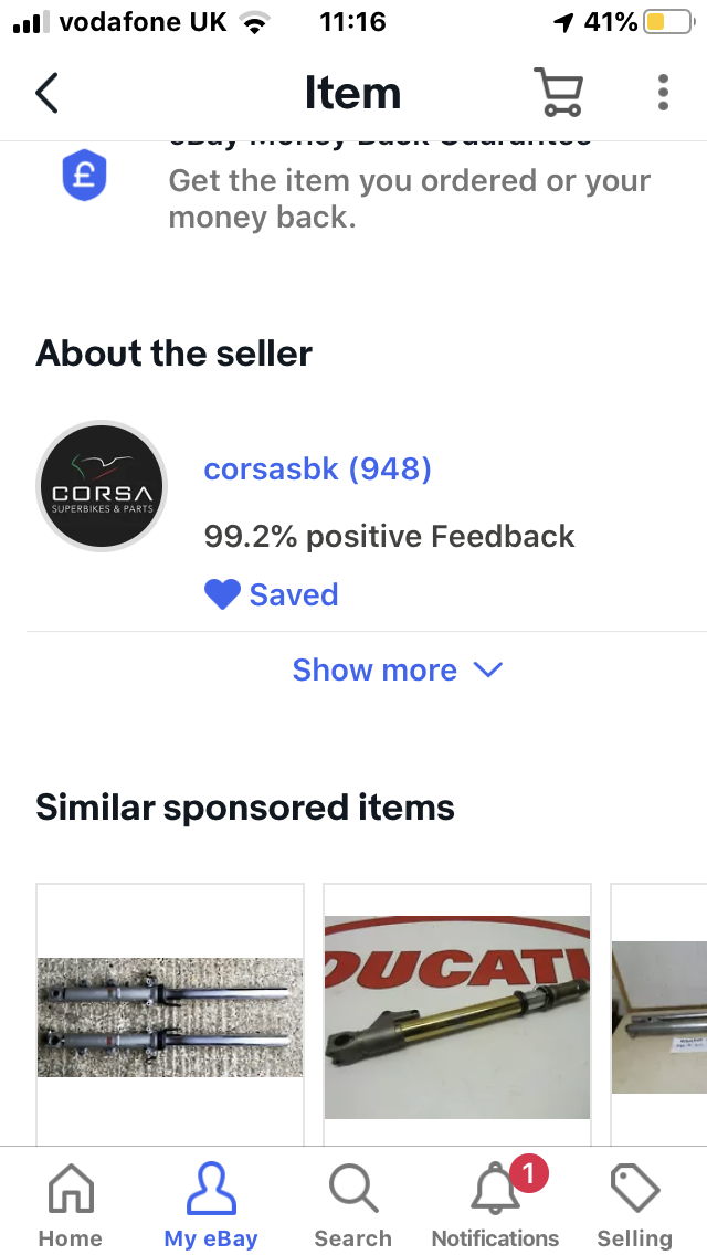

  12. Pirinimoto are brilliant, and if those st forks fit your yokes then really - 300 quid for a brand new set of forks- why wouldn’t you.
  13. I thin that is toast, and unsafe to use moving forward - but thats just my opinion.
  14. There are refinishers out there that can do the outer tubes, but all of these 'issues' should be judged on an individual basis.
  15. 0D07B13D-DFE9-4E90-A732-DCAA8C2F4E2D.png Got a set of immaculate forks from these guys in Netherlands- outstanding service, communication and value - recommended 0D07B13D-DFE9-4E90-A732-DCAA8C2F4E2D.png
