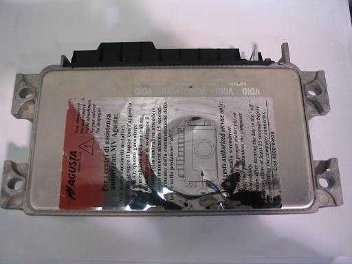

  16. I can, and many more on here also. I learnt the hard way that the rubber bung on top of the ECU giving you access to the chip is rarely adequate in stopping water ingress and ironically, it's the "Void" sticker that does a better job as long as it's intact.
    on an MV so similar:
