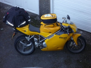

  3. Get a Kriega tail bag, had one on my KTM 790 attached to the pillion pad.
    https://www.thevisorshop.com/en/gb/...MI88b5ubWOjAMVrqNQBh1t8CUCEAQYAiABEgIvefD_BwE
    The only backpack I’ve worn is the Kriega I bought for my GG700. Not sure I’d want a backpack on a sports bike TBH. For the same reason I don’t on my pusho.

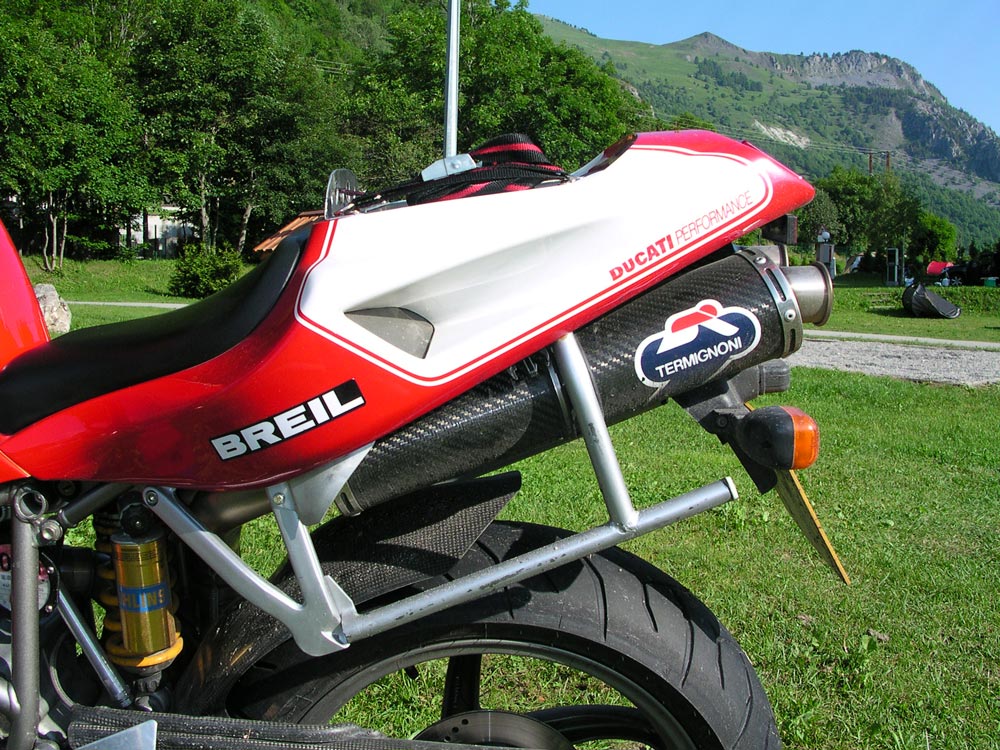

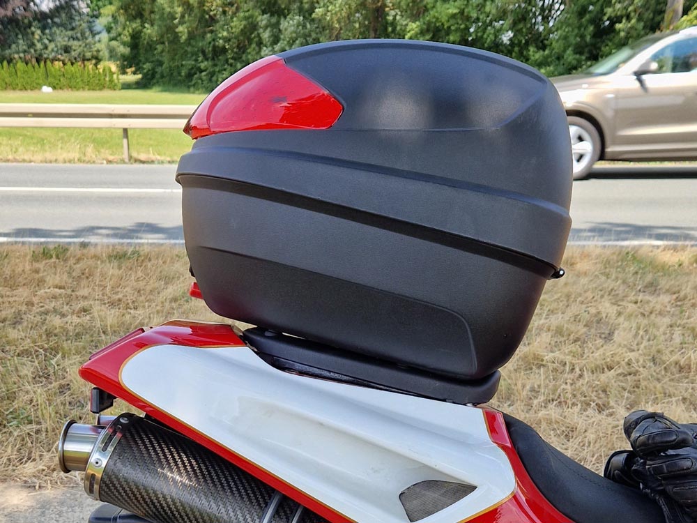

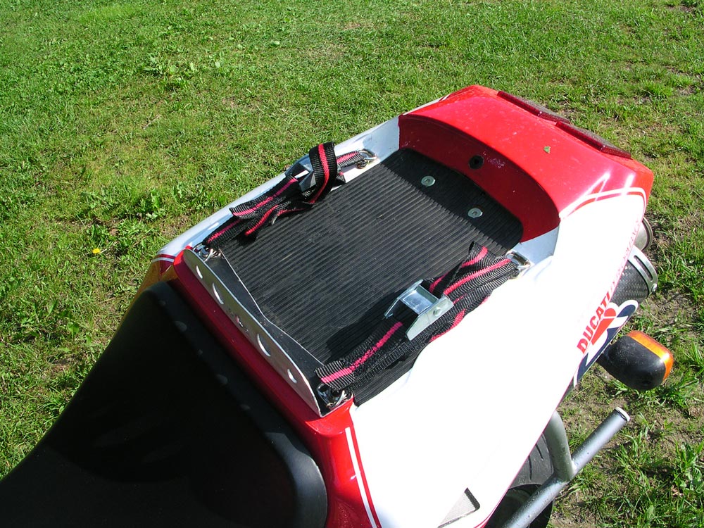

  4. My best mate has joined me on my annual tours on his 996 since 2010. Mostly on the continent, a couple of Scottish NC500 trips and a Wales & Peak District trip. He's now in his 60s as am I. Swapped bikes a couple of times and I don't quite know how he manages TBH, but he's not crippled by the experience and has no complaints.
    He's made a few adaptations:

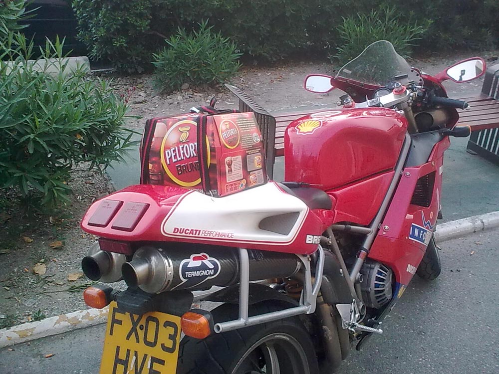

    These were the early changes made for the initial 2010 trip (Route de Grand Alps and Cevennes). He's quite creative in the workshop and fabricated the pannier rails himself using the bi-posto pillion footrest hangers and some tubing. These are easily detachable before and after a trip with a few bolts and keep his soft panniers in order, out of the back wheel and away from the bodywork. The pillion seat adaptation provides a platform with integral eyelets and tie-downs for strapping a bag, or a case of beer, securely. The pillion seat cover still fits so the bike has a normal profile the rest of the time.

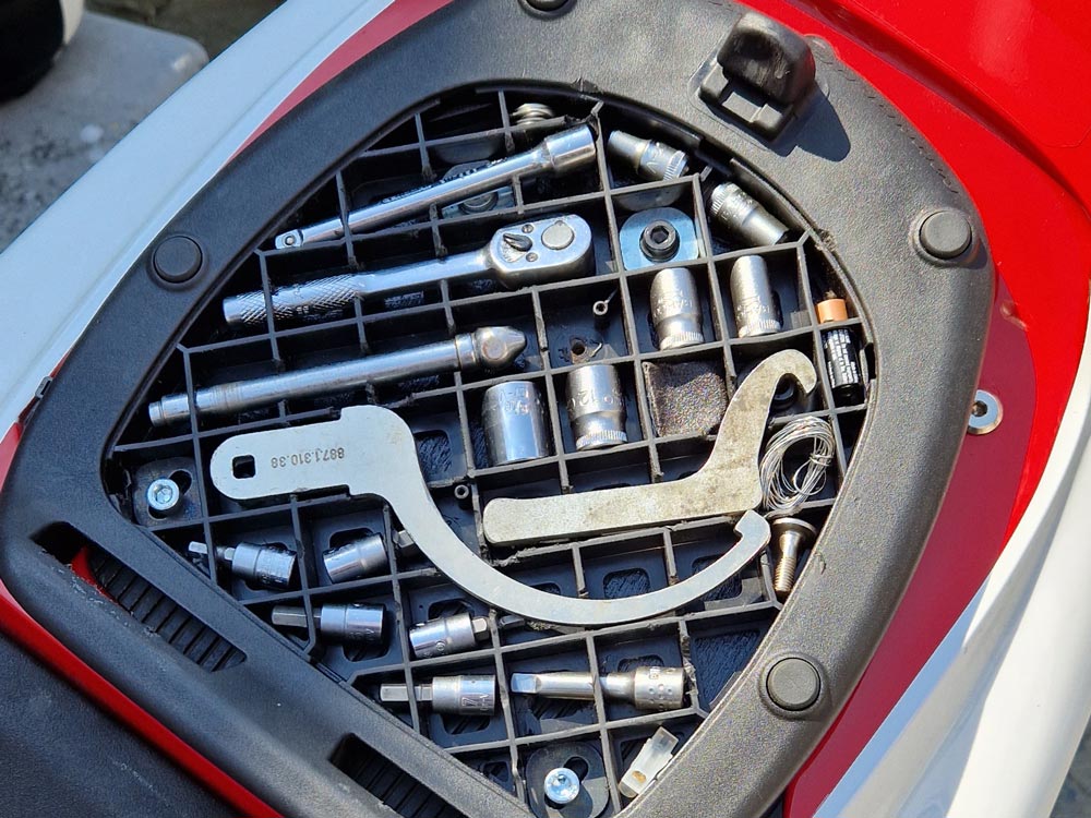

    More recently he's embraced the travel light approach with just a Givi top case on the platform. This gives better security as the base plate is bolted on and the case locks to that. The added ingenious touch is that under the pop off cover on the top side of the base plate he's found an ideal tool stash. The Givi base plate is only added before a tour and removed on return, again maintaining the std. profile of the bike.
    The rear shock, an Ohlins on the 996, has adjustable ride height and he backs that off if we have any serious motorway mileage. This, he reckons, gives a little relief on the arse up, nose down riding position. Once we hit the twisties he adjusts it back and has a ball.

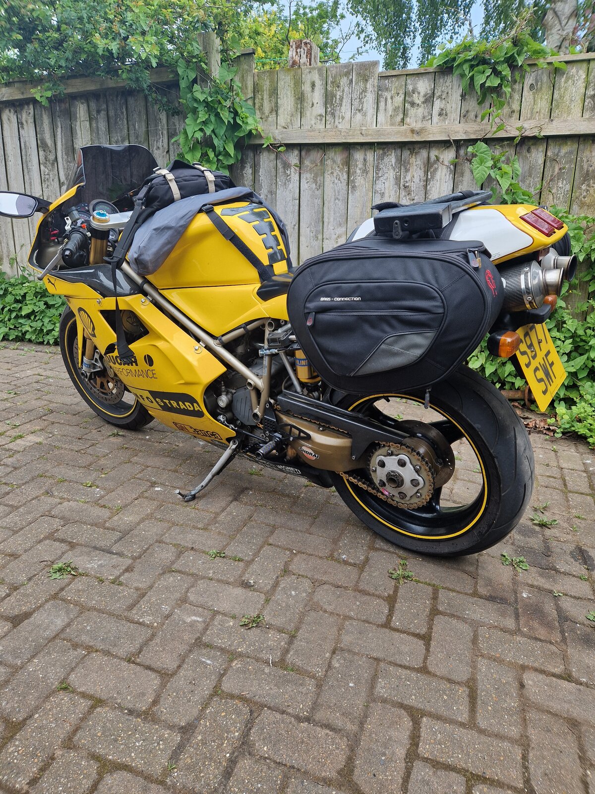

  8. I have Kreiga bags and SW Motech blaze panniers on mine. I have a kreiga tank "bra" that a 10 & 20 litre bag fits comfortably. Had to make my own brackets to fit the panniers 20240521_134913.jpg Screenshot_20230522_125427_Gallery.jpg
