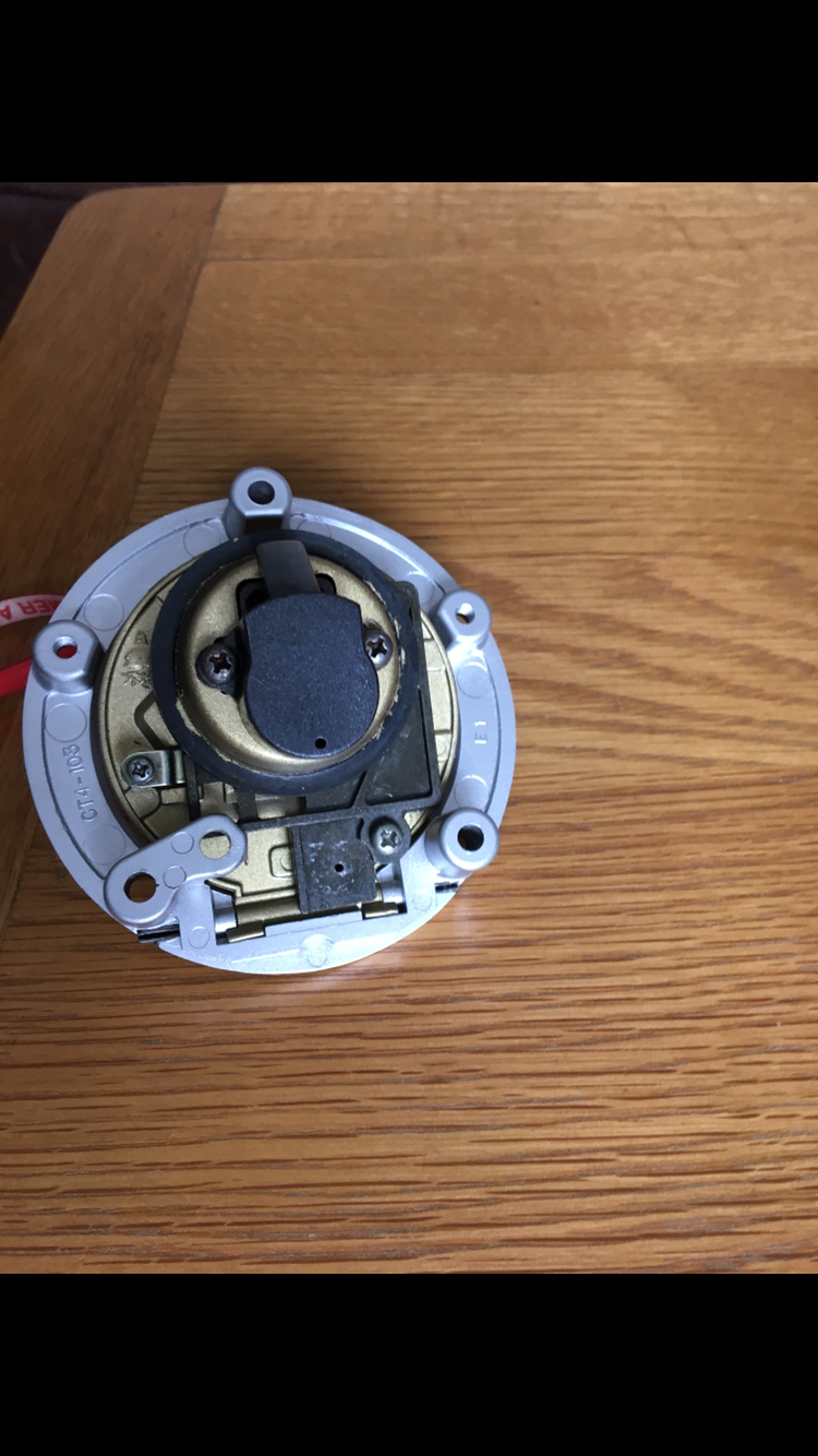

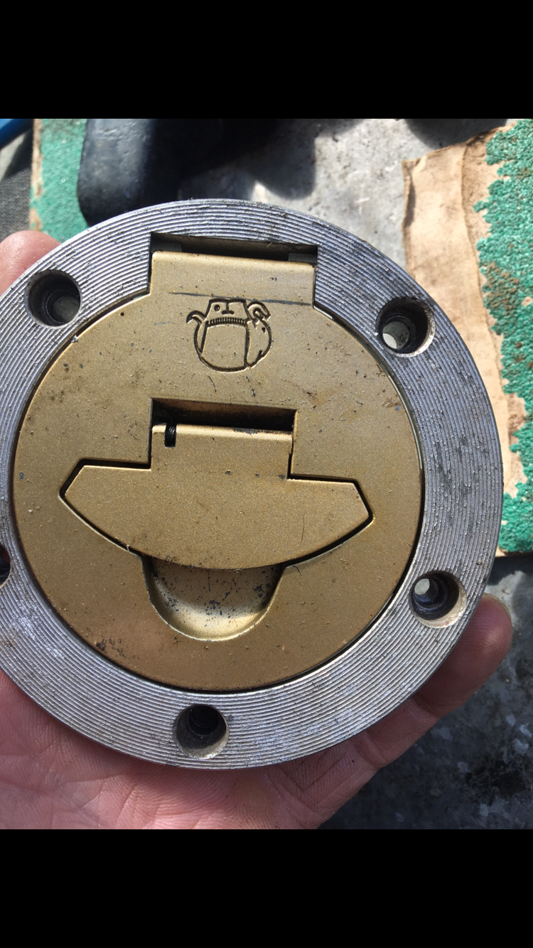

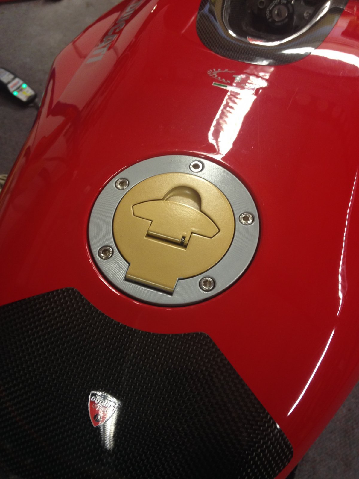

  1. CAABC763-E50A-4548-AD95-34A5EED0A76C.png A1AC61CA-963E-447A-B19D-15DB23C0D928.png F3300D12-D72F-45A7-A392-A36EDD82D692.png 4F8D0D98-F8A8-412D-8289-9CB48145249A.png I don’t think it turned out too bad

  2. Great work.
  3. Crackin' job chief, can I send some bits for refurbishment? ;)
  4. Very nice. I would like to do mine. How did you do it/what materials?
    TIA
  5. One step ahead of me as usual.:)
  6. I reckon there are a lot of us who would like to do this!!
    • Agree Agree x 5
  7. Totally agree with you,as this is the icing on the cake or the cherry on top.:confused:,he could provide a inhouse restoration service for this sort of thing.?
  8. Job well done that.

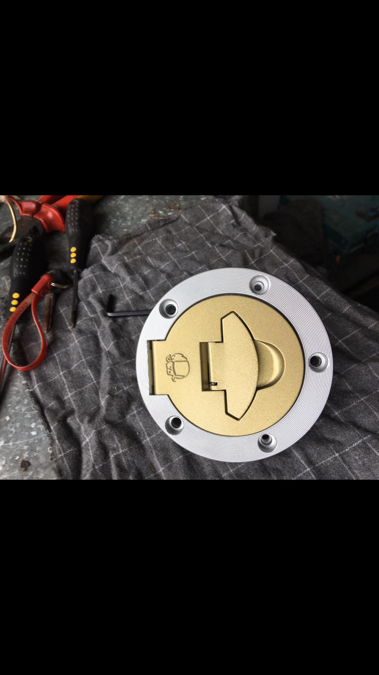

    @Expat Jack, spray cans mate.
    Finished off with polished stainless cap heads.

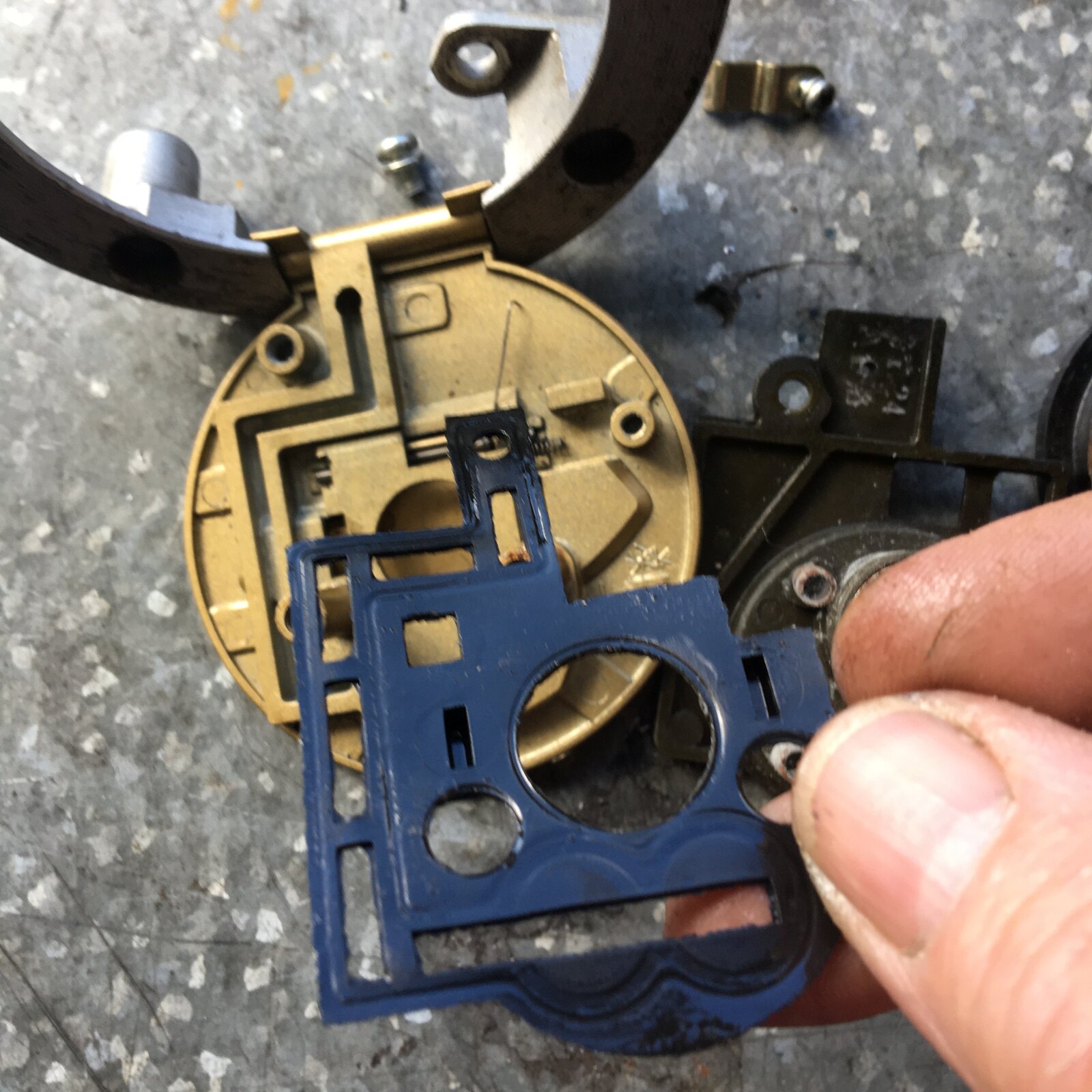

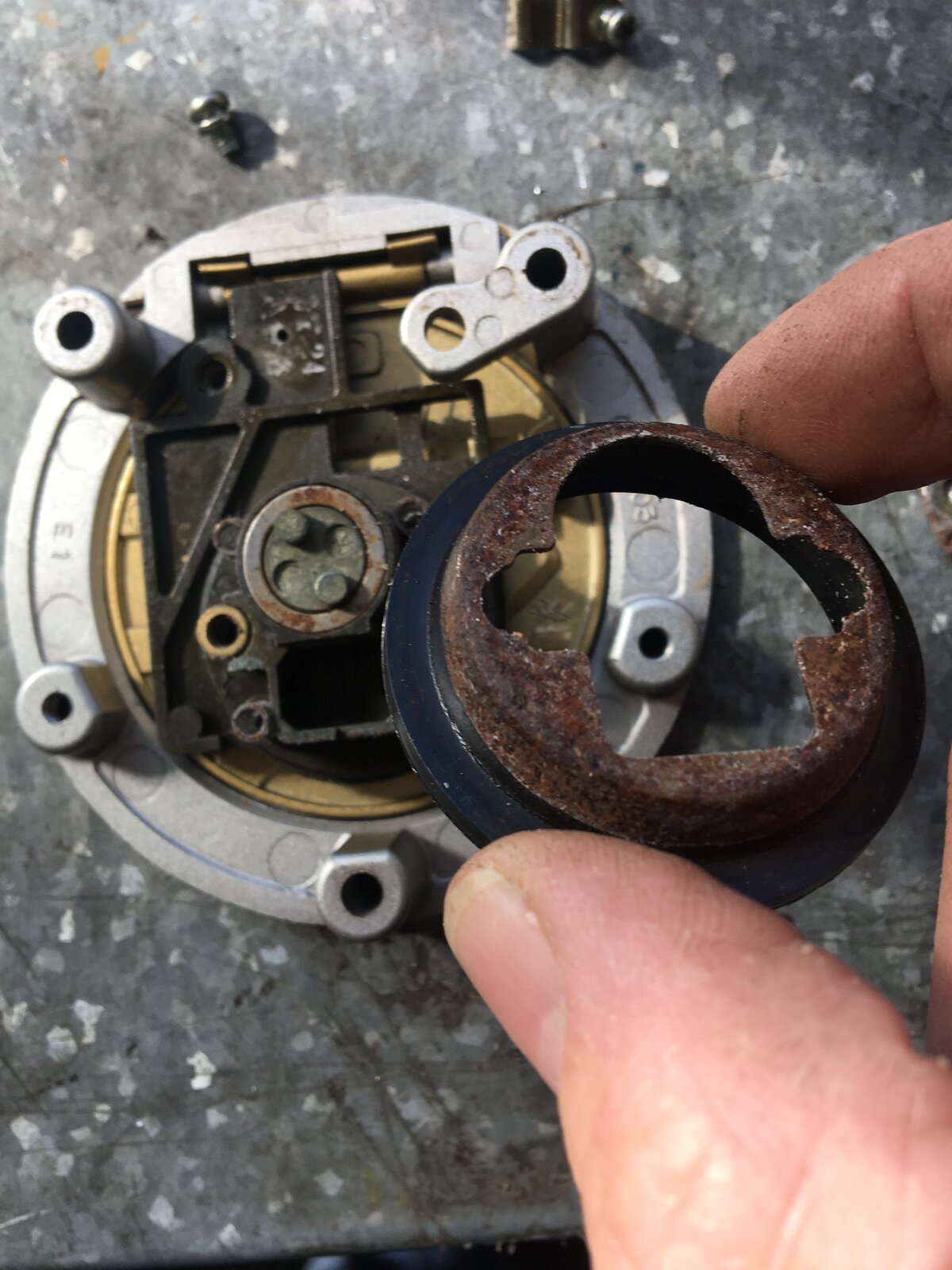

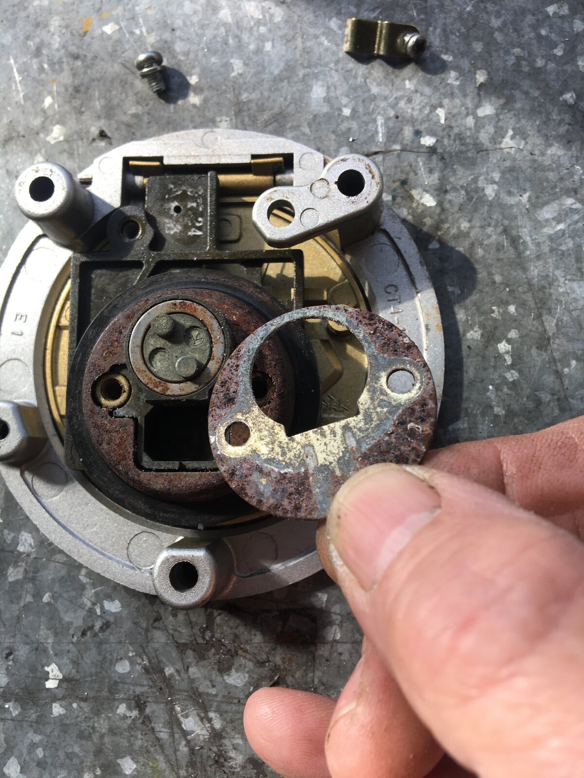

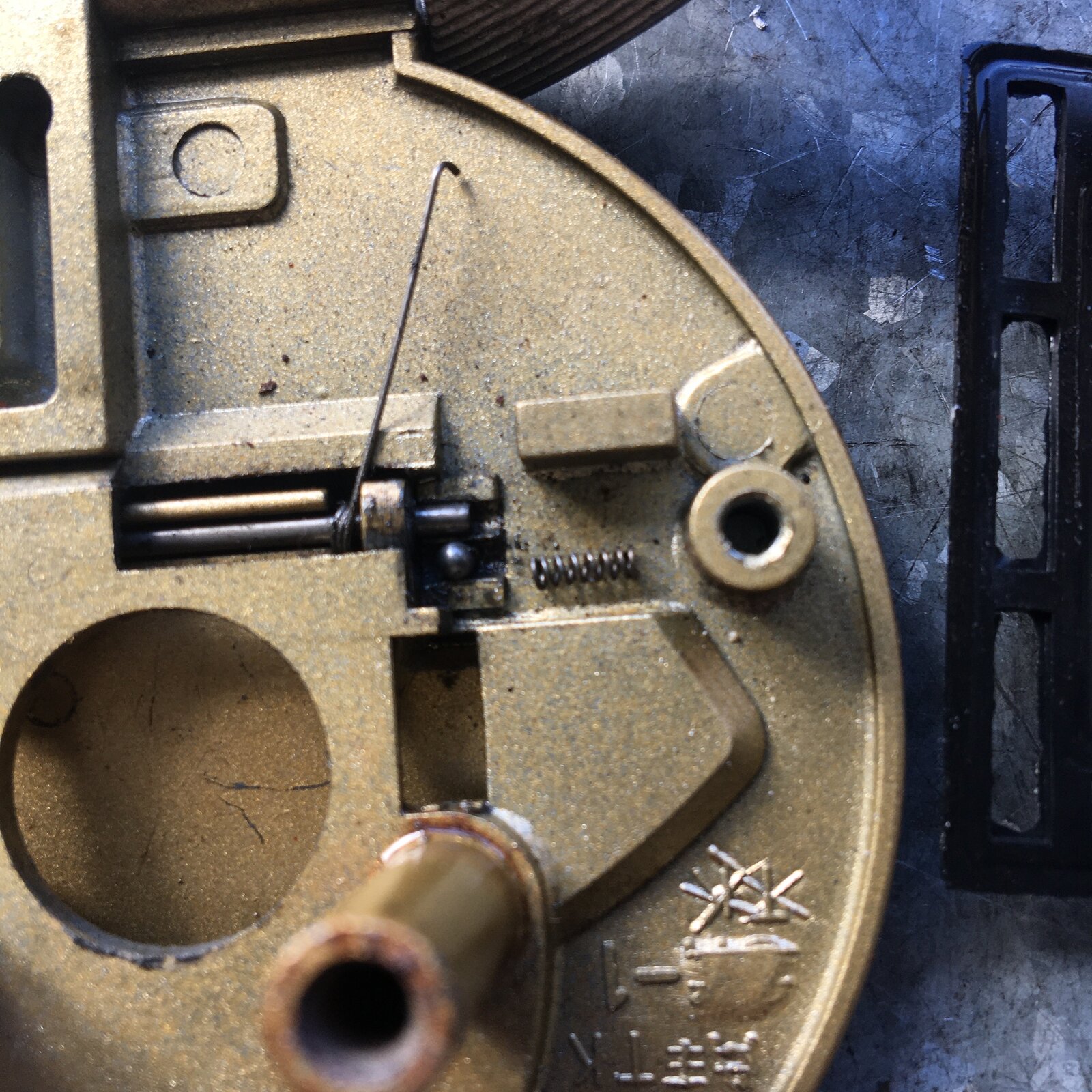

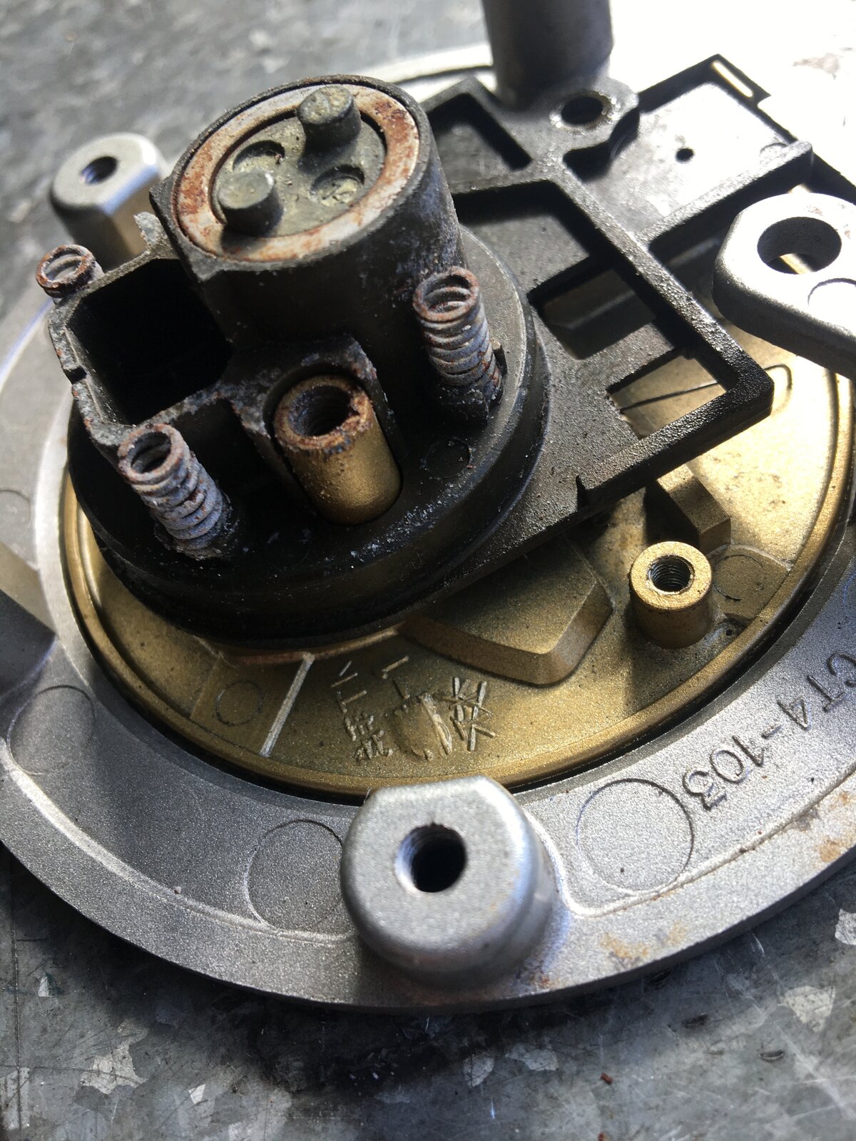

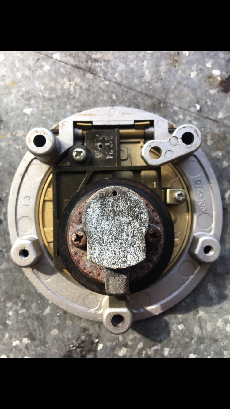

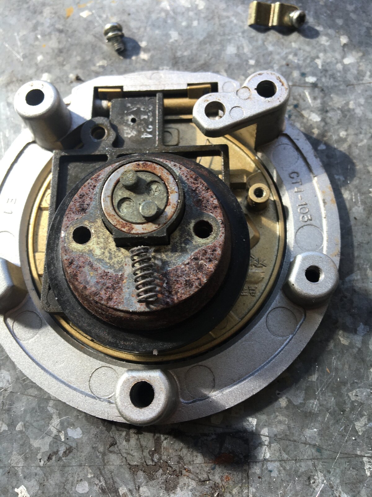

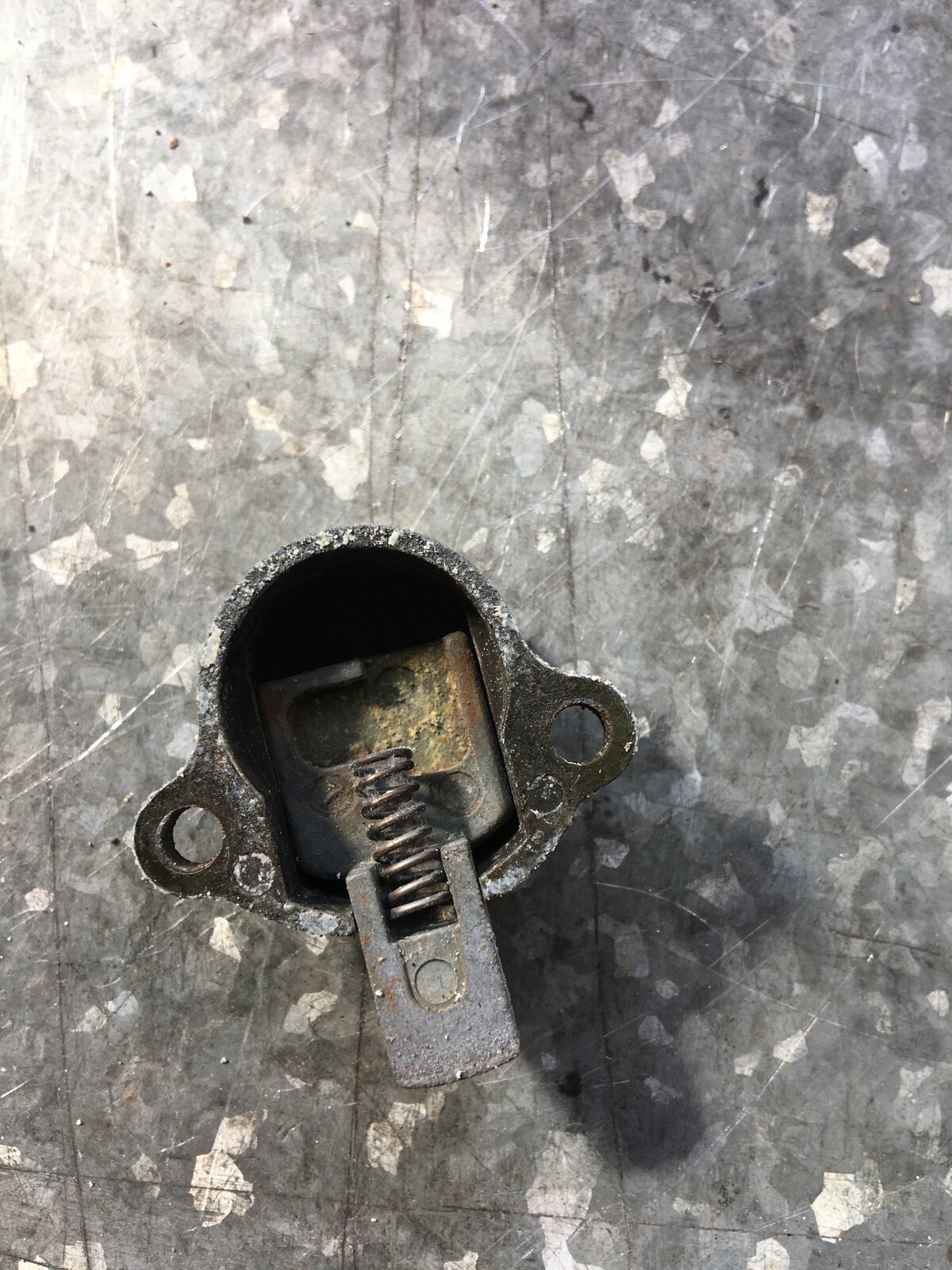

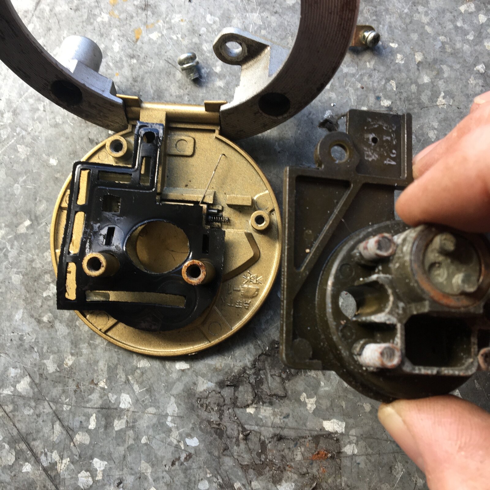

  14. I used hammerite smooth gold spray and Simonze VHT it was very straightforward the only trouble is getting the roll pins out which separate the main cap from the outer ring they MUST be pulled out either side it’s not one pin all the way through! The only other thing is the minute ball bearing and spring which actually helps open and close the key flap. there’s a little metal Fixed with a screw which holds them in place. Here’s a few pics of how it all comes apart 1DBA418A-B56F-4A17-BEE1-6504A9E7A3EA.jpeg BED7E545-827B-4C39-90B7-904929CB8247.jpeg 00295196-DFF7-4374-88A4-7B6C457848E6.jpeg B05B3C4E-5B58-495F-934F-1B0B9F894DCC.jpeg 06855906-36F1-4034-B618-67534BBC42FA.jpeg 105E2D60-5FE4-4255-AFDF-EAABE201E53E.jpeg C0C06C31-D8E9-4F0B-B92F-80770C6F5A35.jpeg

  15. 5D4268DC-067F-4268-A89B-C7598D959F5D.jpeg 7888D71D-5D10-4C89-AF76-78B08BCAE149.jpeg
