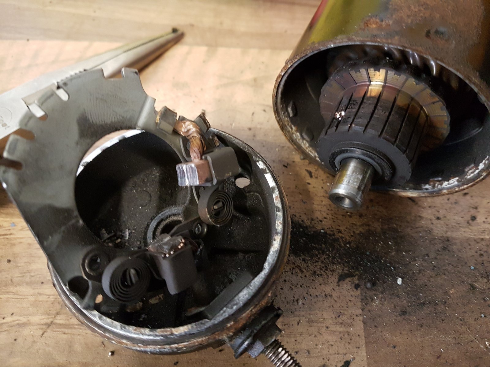

  11. found the starting problem.
  12. Well done.
    Steve
  13. electrics also sorted .replaced connectors on ignition relay.seems to have fixed it
  14. Let us know when it's up and running.
    Steve
  15. ???
  16. burnt out starter motor
  17. Can see how that could be a problem... :(
