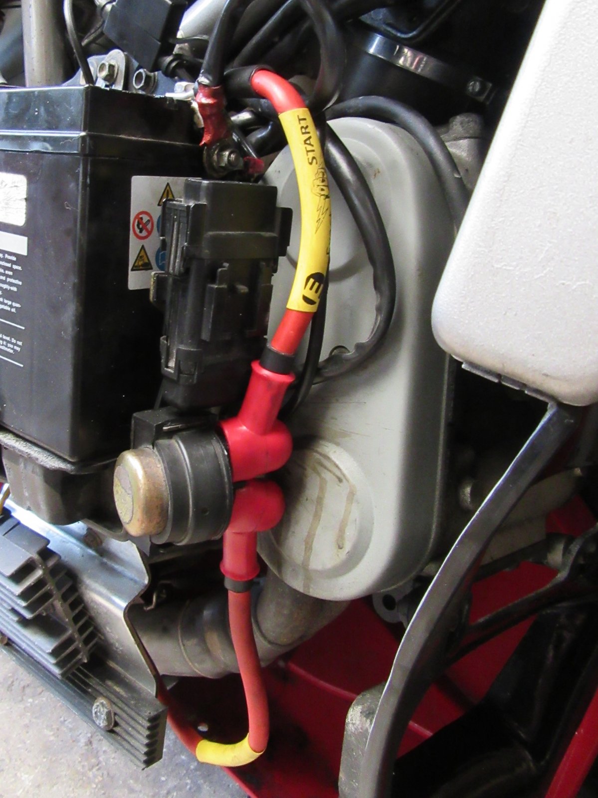

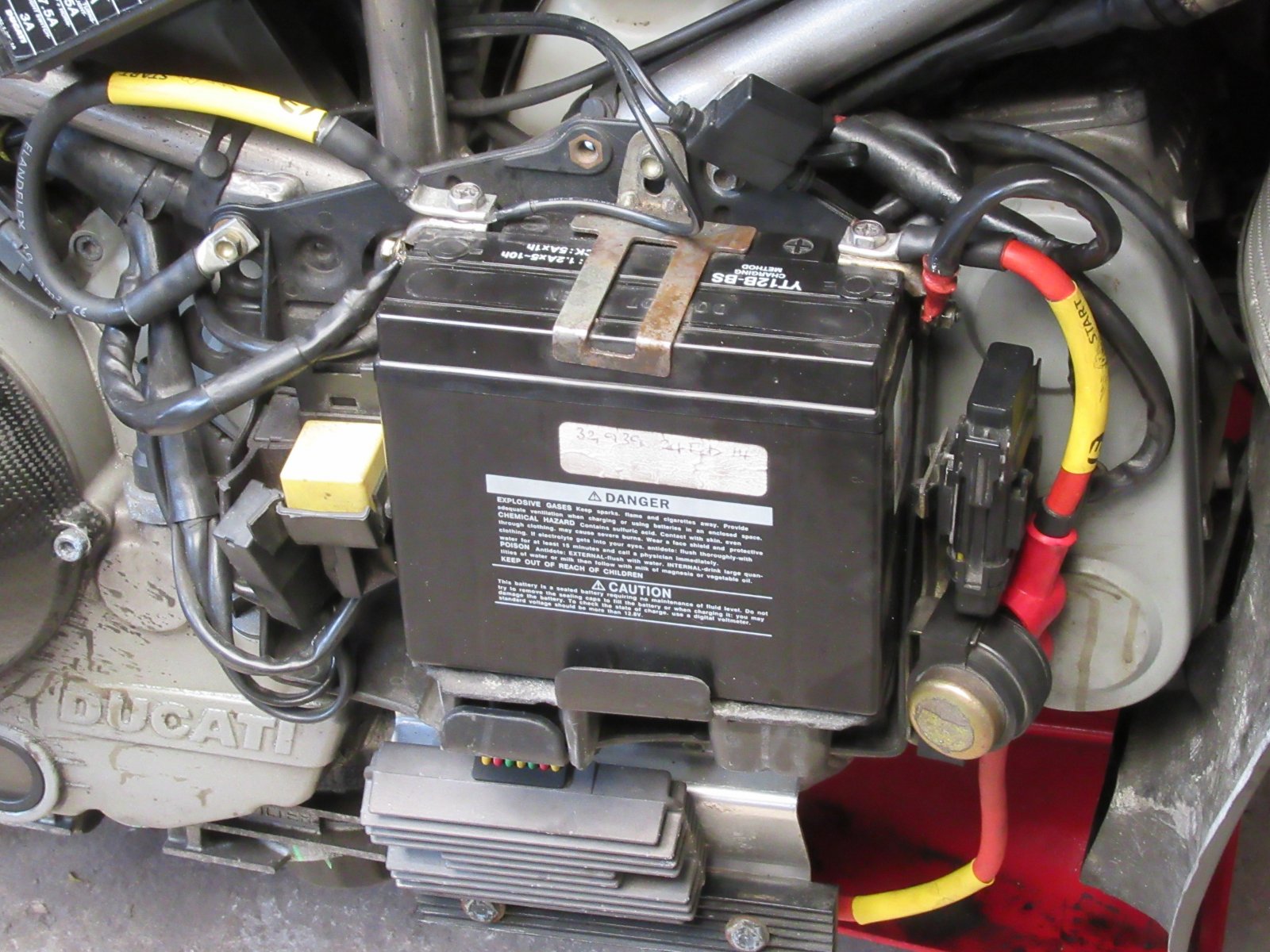

    Probably should have cleaned the yellow bits a little and maybe taken the photo at a tighter angle:sweat:

  15. Go on, give the rest of it a clean too :Wideyed:
  16. Chris will know the story of the brown spots on the frame, casing, cam belt covers and battery box damage which is all due to a few ccs of battery acid spilling out of an AGM battery when the reg failed over voltage (19v) and melted a hole in the battery case. A normal battery would have dumped a litre of acid and wrecked the bike. Makes the cables look even nicer.
    #36 Denzil the Ducati, May 10, 2017
  17. Looks pretty good to me Denzil. Never been convinced by the super clean. Cables look like they've been lifted from a power station. Should last the life of the bike.
