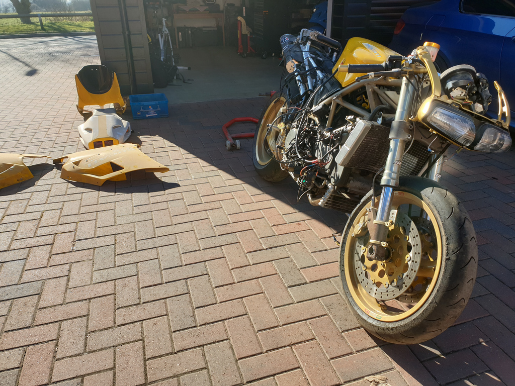

  1. A mate and I had a daft idea of buying a cheap bike to work on together and stick on YouTube. We were looking at a 748 track bike that popped up on eBay (and on here in the eBay bikes thread) but lack of timely buy-in from SWMBO meant someone got to it before us. Luckily, it turned out (I think) as I came across an old post on Facebook marketplace relating to a 916 that hadn't started for about 8 years and the current owner was thinking of selling.
    After a little research into what the bike actually was, a price was agreed and it came home with us in the van. It also came with an additional frame which will be used as it's currently on a Q plate. From what I can ascertain so far, the facts are as follows:

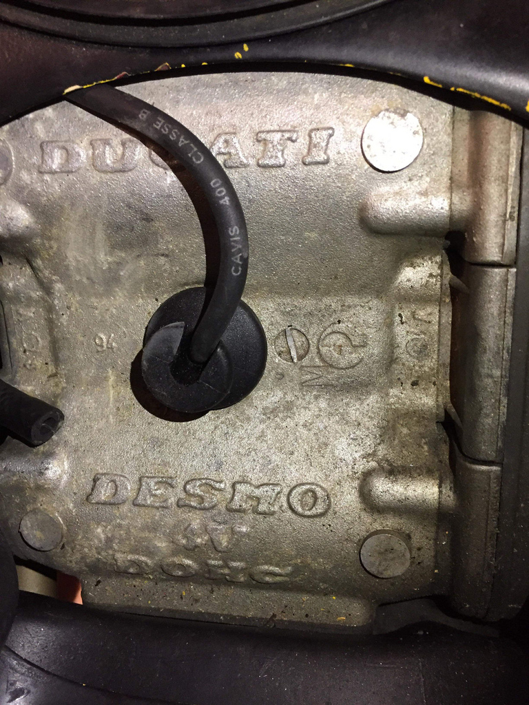

    It has a 94 engine (unknown mileage) with P8 ECU and 94 swingarm. The bodywork is post 94 as is the tank + tank cap. Wheels are post 94 (no Ducati Racing lettering) and the bike was sprayed yellow at some point. The wiring is a mess and has been chopped about a little but the engine cases look in pretty good order. The bike was stored in a marine engineer's workshop so lots of wood and everything was pretty dry.

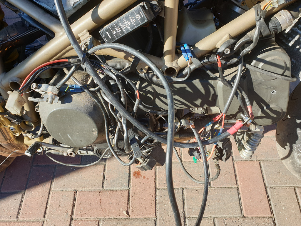

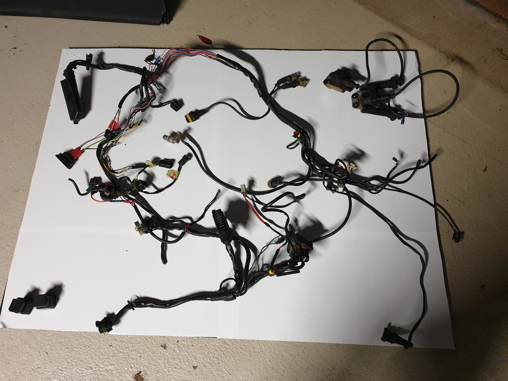

    Minor wiring mess:
    [​IMG]20190226_133638
    94 Motor:
    [​IMG]received_618582421929984

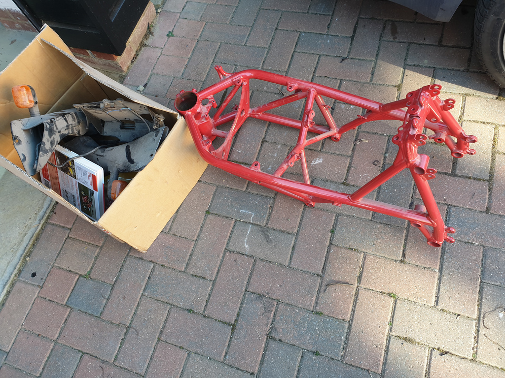

    Spare Frame:
    [​IMG]20190226_133646

    Looking at that butchered wiring harness is grim viewing. Get it nice and clean with upgraded gauge to the stator & starter.
  7. Has the frame you are intending to use got a V5, if not it’s a risk, I have fallen foul of the DVLA in the past, they are morons, took almost a year to sort my issues out, also get it checked for straightness before using it, cheers Mark.
  8. Excuse my ignorance, but as long as he has a V5 for the bike, who would know if the frame were changed? It is surely possible to get those VIN stickers redone somewhere? Or maybe I'm missing something?
  9. Hi Jez, it’s illegal to swap a bikes identity, it’s taken from the VIN number stamped/engraved into the headstock, swapping a bikes identity is called “ringing”, do it and your for the high jump, besides the V5 he has on the frame that the current bike is built with is a Q plate which he is trying to get away from, now if he were to have a damaged frame with a V5 and cut the headstock off, then weld it onto the spare frame he currently has then that (as far as I am aware) is legal!, it’s a bit like chopper builders, they buy a donor bike, then cut off the majority of the frame and replace it with their own custom tubing, but the bike retains its ID because they use the original headstock, it all makes a mockery of the whole registration thing IMO.
  10. Hi Mark
    Both the current frame on the Q plate and spare have a V5. Even though the build will be fully documented for all to see, the retention of a Q plate is far less desirable than the fact the bike will be rebuilt in my opinion.
    I do want to make enquiries with DVLA to discover any more history on both frames so a V888 will be submitted once the V5's arrive with me. I'd like to speak to them regarding a new frame plate as the original VIN is hard to make out at present, I presume due to sanding prep prior to being painted red.
    The Q was registered in 03 so substantially newer than the rest of the bike too. The spare frame is a 98 so still a 916 model year which I prefer, if not the ideal choice - it appears 94 frames don't come up that often!

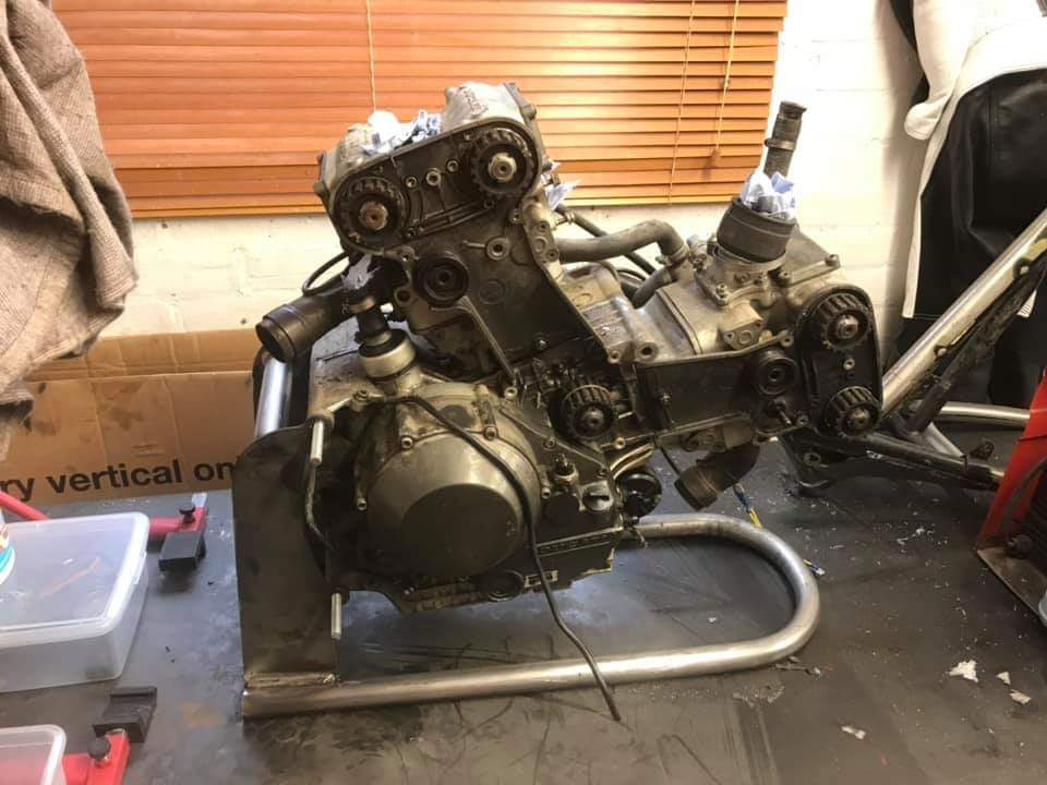

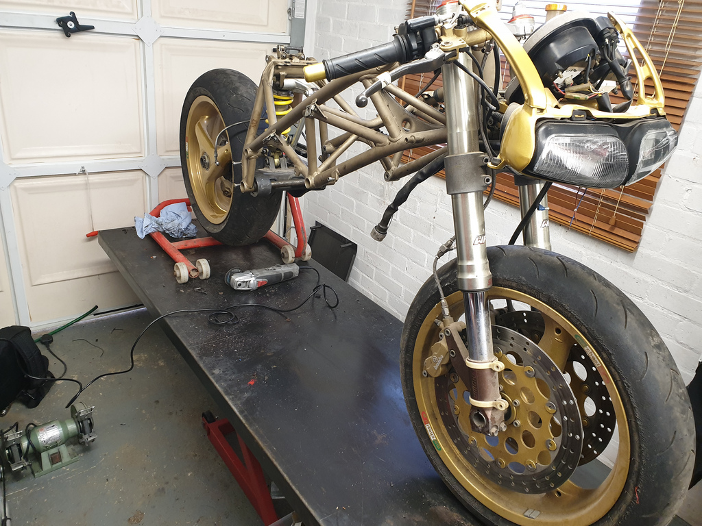

  15. A little help with stowing the engine while it was out and being messed about with meant some welding was to be done:
    [​IMG]FB_IMG_1553033581681 by

    That damn swingarm bolt was a pig but we were lucky to get it out in about an hour without the proper (or fabricated) tool.
    The bike is now down to a bare frame so it's on to painting next. I'm hopefully picking up some genuine 94 wheels tomorrow so they'll get painted along with the current wheels and possibly both frames. I've never painted before so it will be a learning exercise methinks. I know we could get it done professionally from the start but I'd like the satisfaction of doing as much as possible ourselves.
    The engine looks to be pretty good apart from some minor wear to the rockers. The shims are out a bit too but that will be sorted with the engine rebuild.
  18. While you have the heads apart I would check for excessive wear in the covers for the rocker pins.
    Wear here can allow the pins to rattle a bit.
