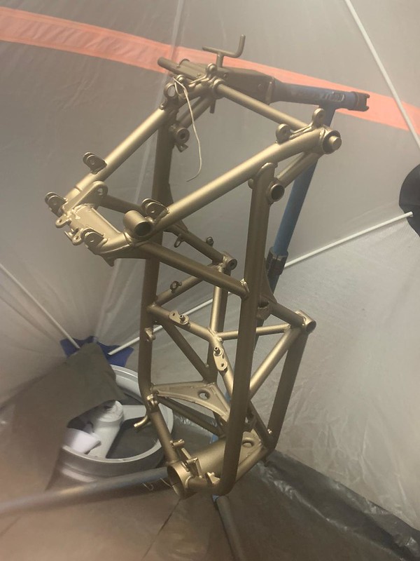

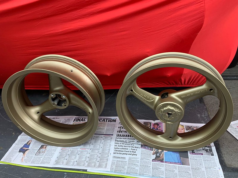

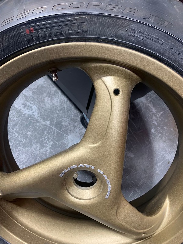

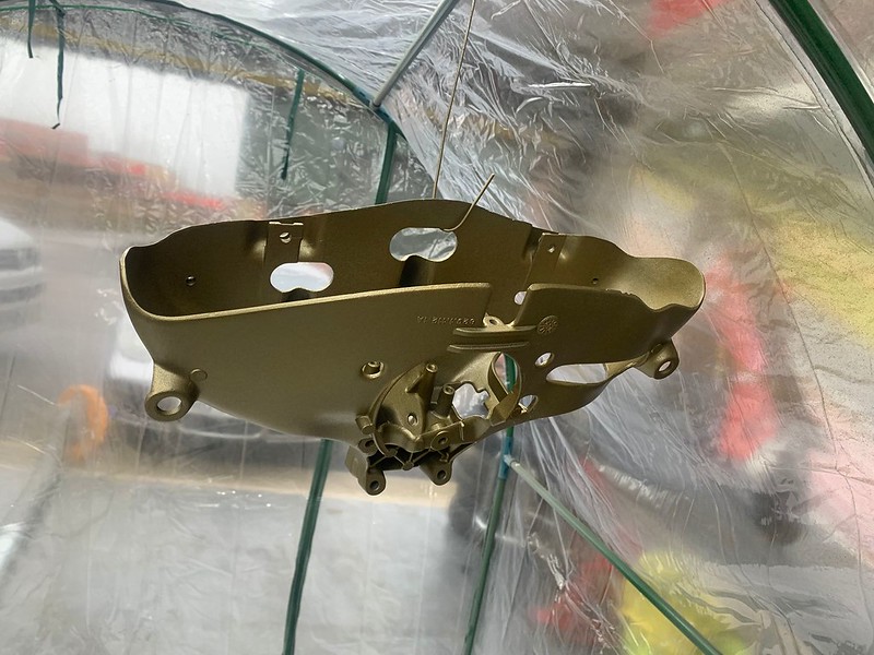

    Over the last couple of years, despite no filming, I've been trying to prep things ready for putting the bike back together. The frame, wheels and headlight bucket was painted a colour matched gold:

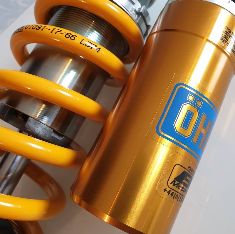

  7. You'll see in the last video that the Ohlins shock was refurbished by BG Motorsport and while a bit of a triggers broom, looks amazing!

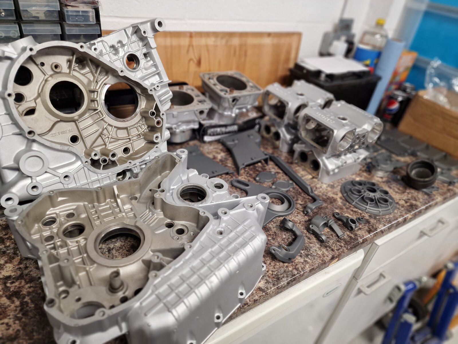

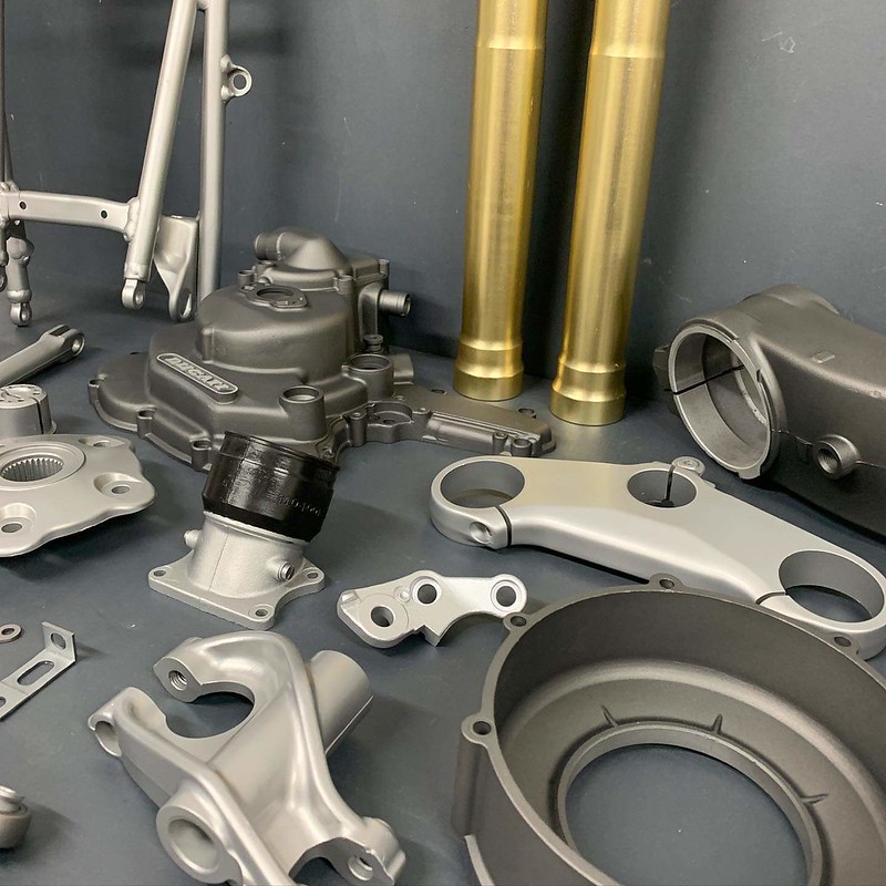

    Next up was a bit of cerakoting. I've become less and less concerned with making it appear original as it will always be a bitsa and as you'll understand shortly, my long term plan has solidified with it basically being done to my taste so I'll basically do as I please.

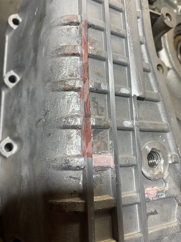

    In the meantime, the cases had a minor repair:

    1. Cerakote the cases and small pieces like the intake and exhaust covers. The cases will be silver and the smaller parts grey, similar to the other parts already done. Will drop these off this week.

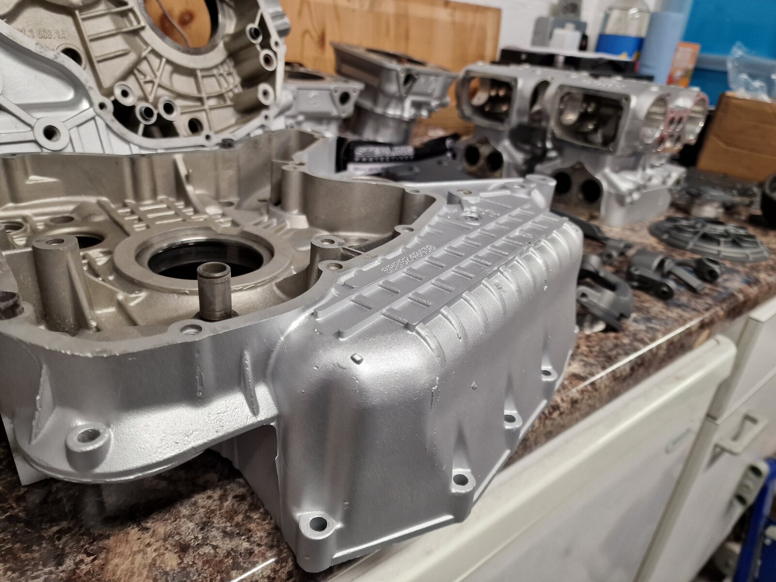

    2. Balance the crank - this will be with the engineers this week too - all being well.

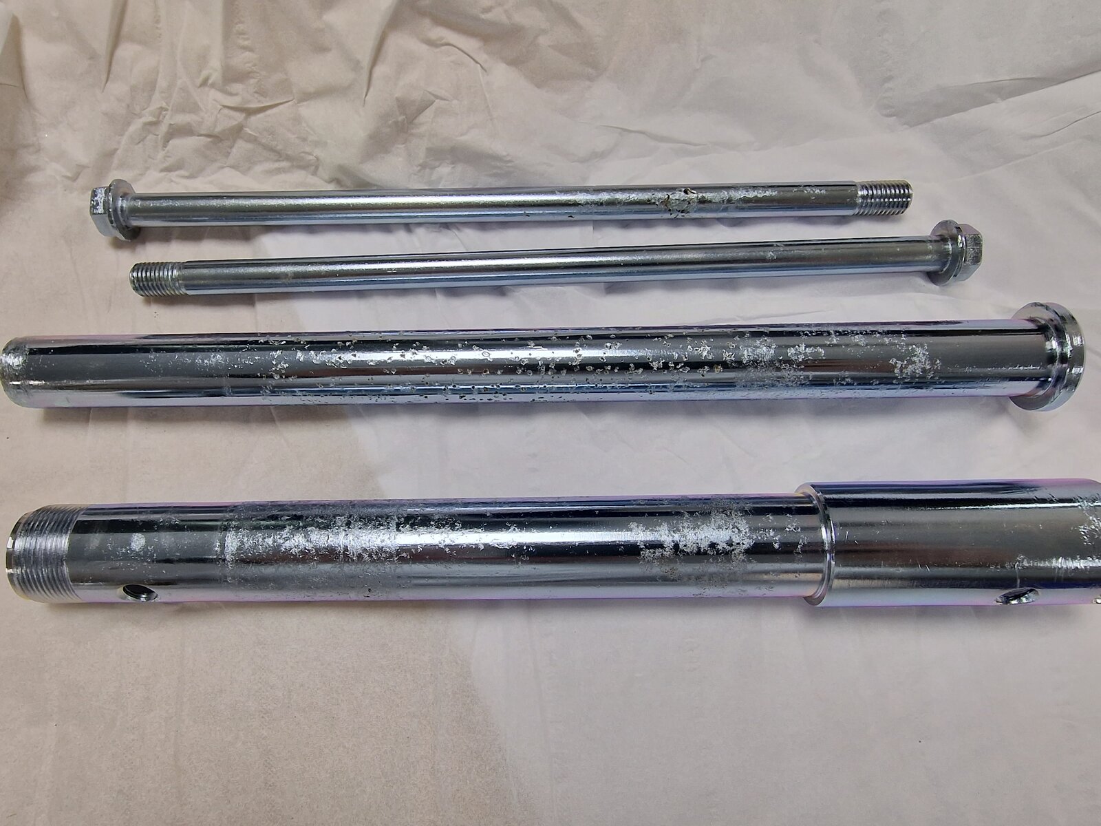

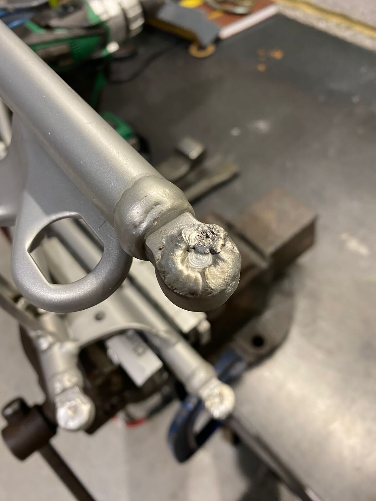

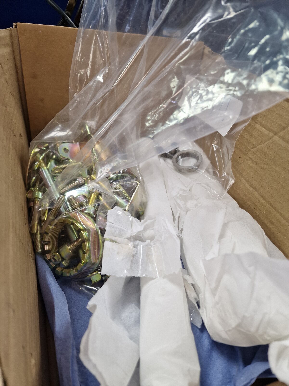

    In the meantime, I had the last of the hardware which was suitable to be plated, plated. The only let down are the two engine boots that go theough the frame, the swingarm pivot volt and the front axle. Rather than have them done in the yellow, I went for silver but they didn't fare too well.
    Now, i expect they're not too worse for wear to use for a short time but I think I'll be replacing them soon. The smaller ones first as they're cheaper!
  10. Always best off giving the parts you take for plating a polish first. The corrosion will only come back with time.
  11. For me personally, it's my first time having a lot of this stuff done so sometimes it's a learning experience.

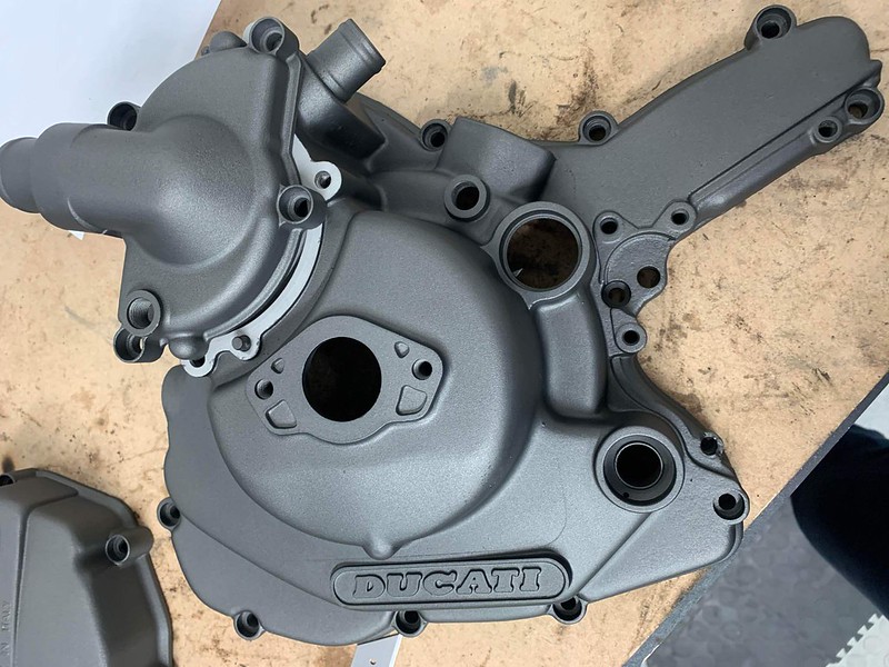

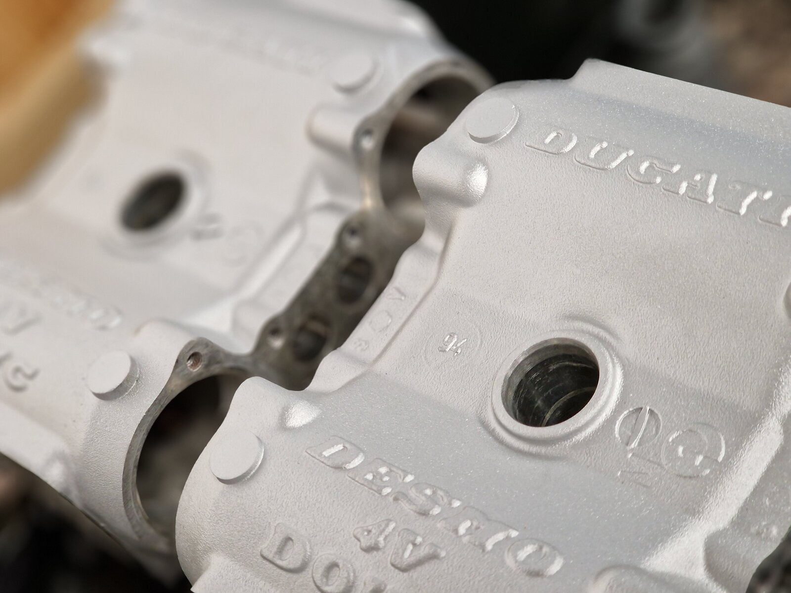

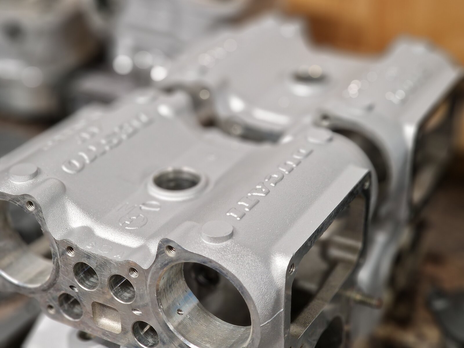

    In other news, the engine cases and cover cerakoting will be done soon - I got some sneak pics of a few of the parts.

    Where did you get the plating done, i need to send a load off to someone. And did you have to prep it first or do they do all that?
    Stu
  14. They were done by Protech Finishing in Northampton.
    Protech Finishing Ltd
    01604 792163
    https://g.co/kgs/9YNxAw
    I didn't do anything to mine before dropping them in but maybe I should have given the larger ones some attention first. I didn't discuss the process but I'm sure they'd be happy to go through it.

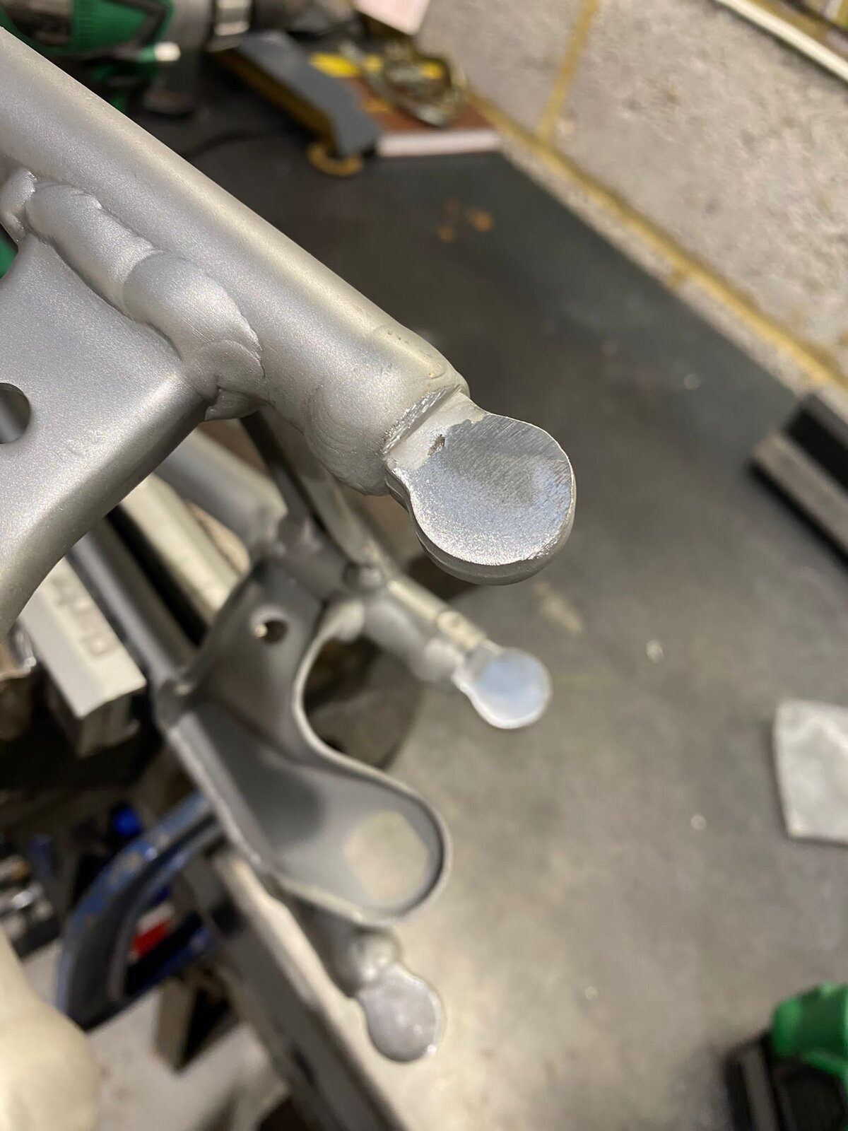

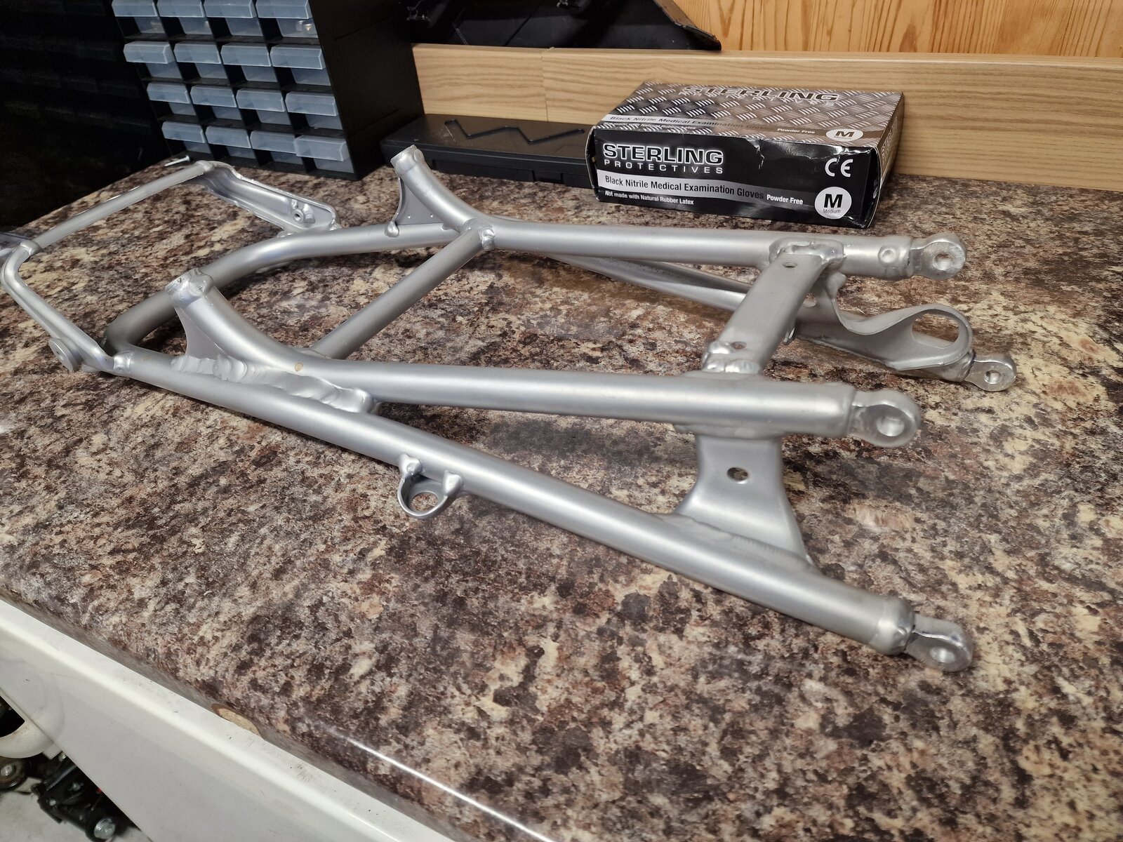

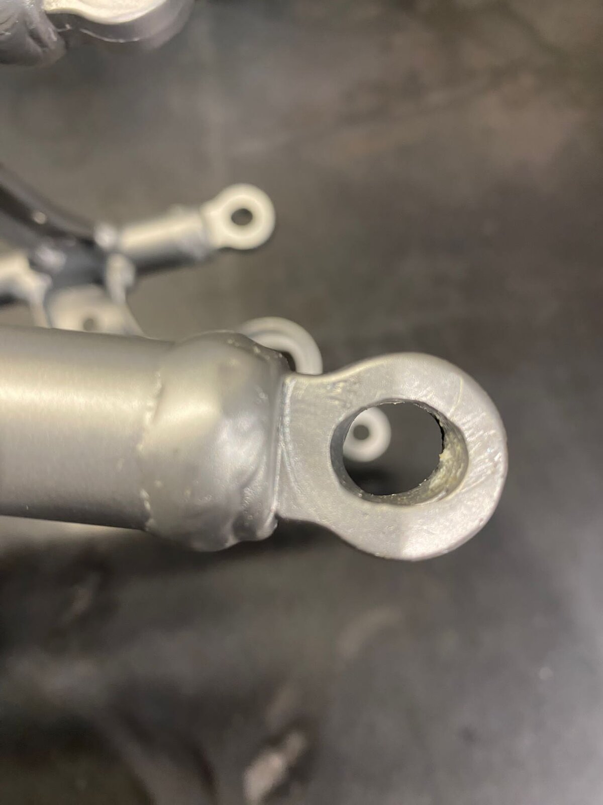

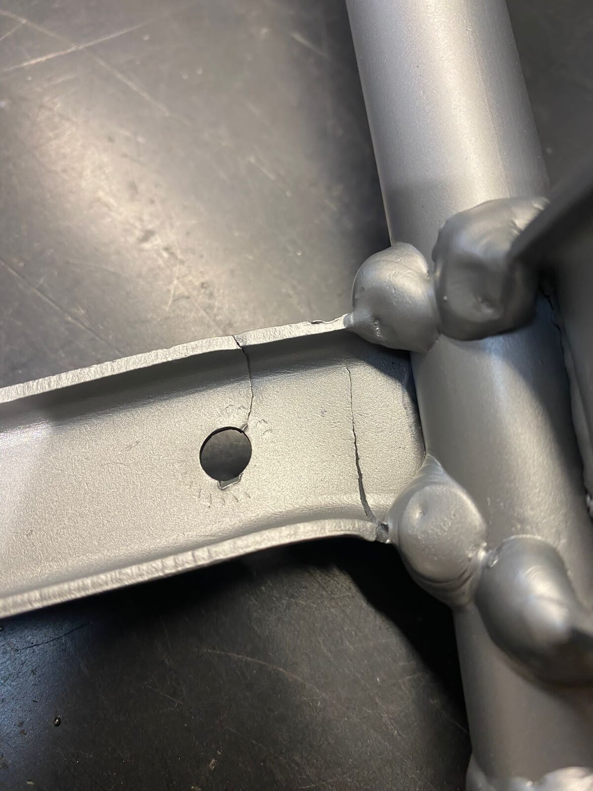

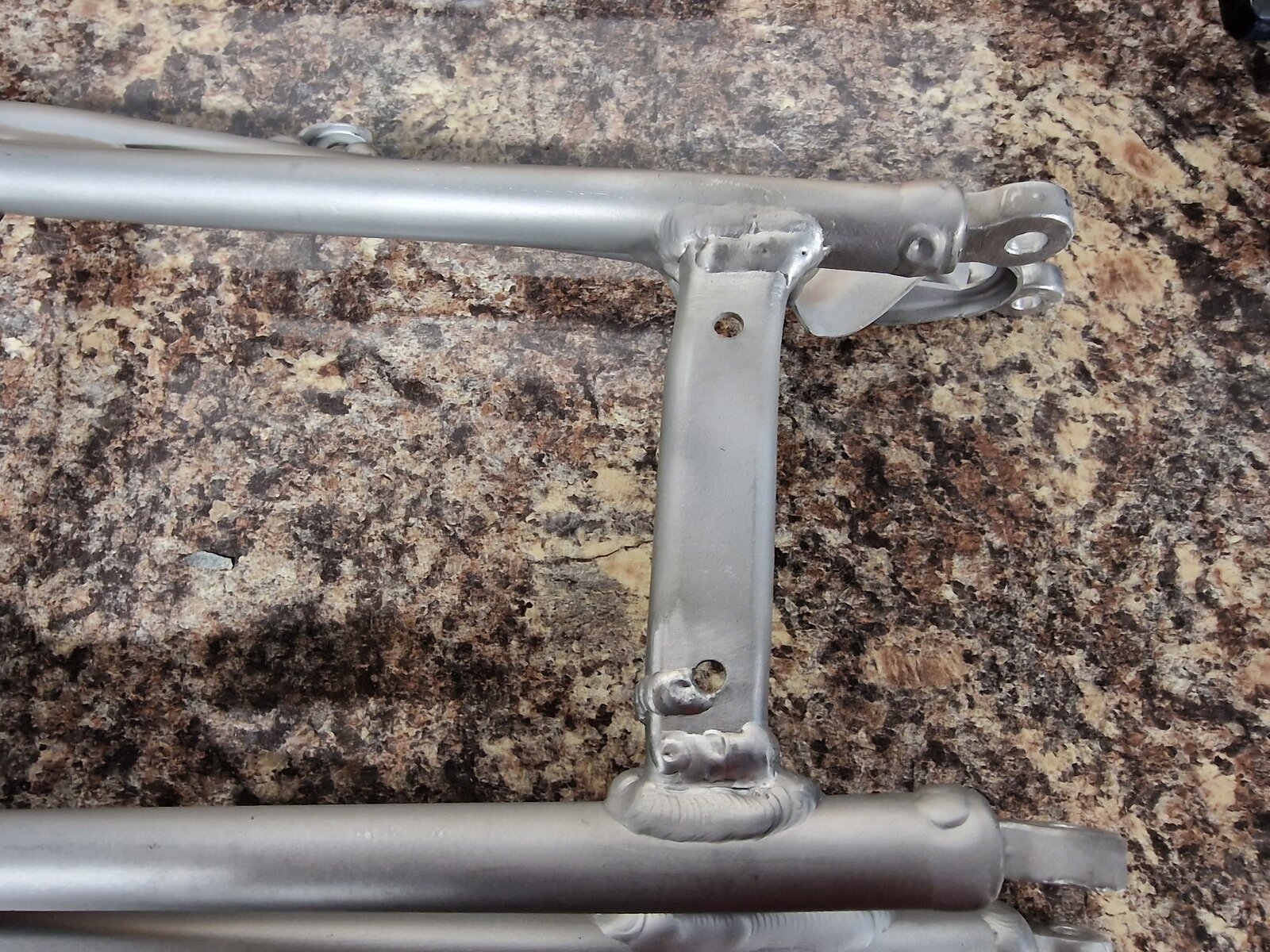

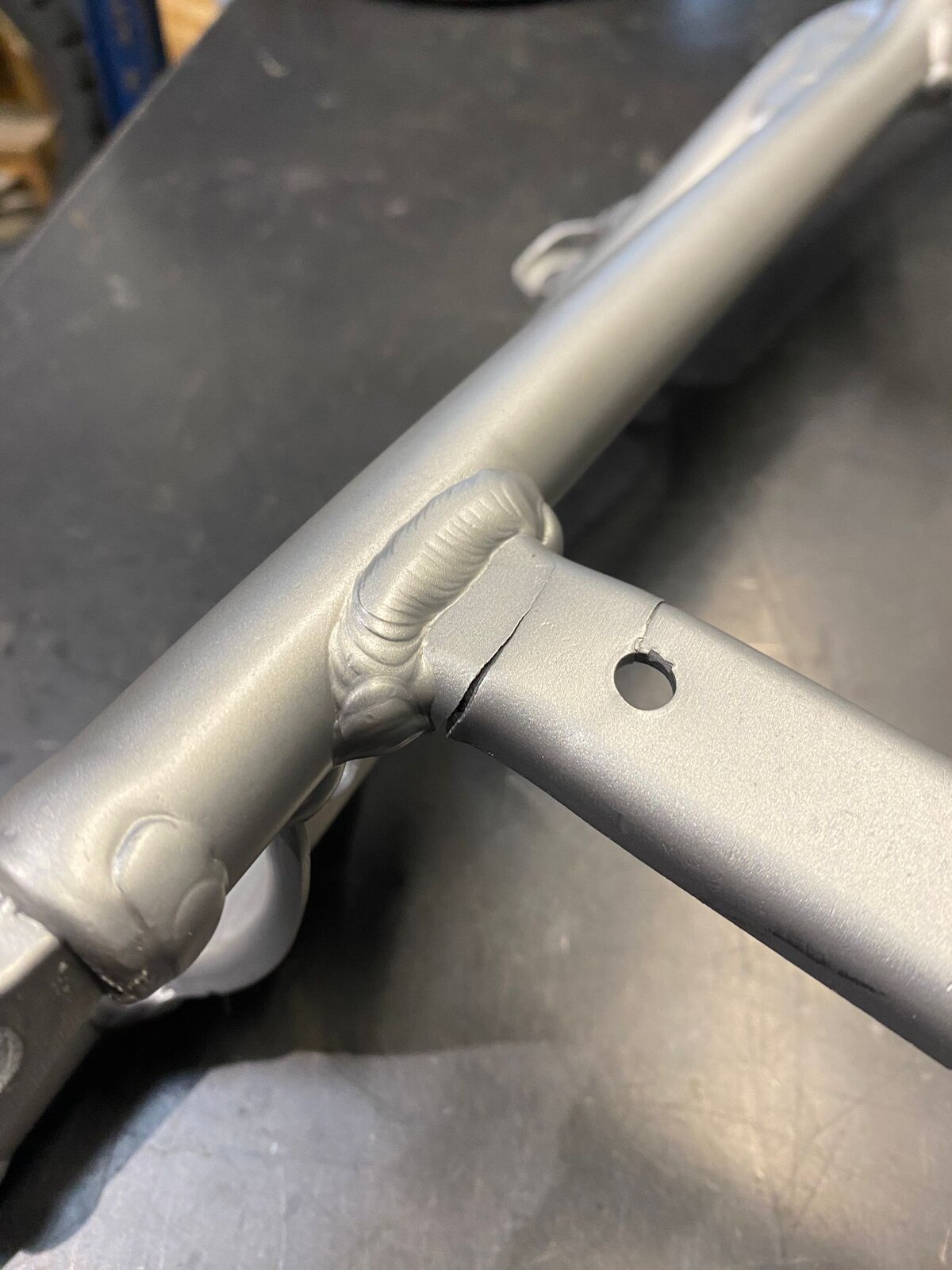

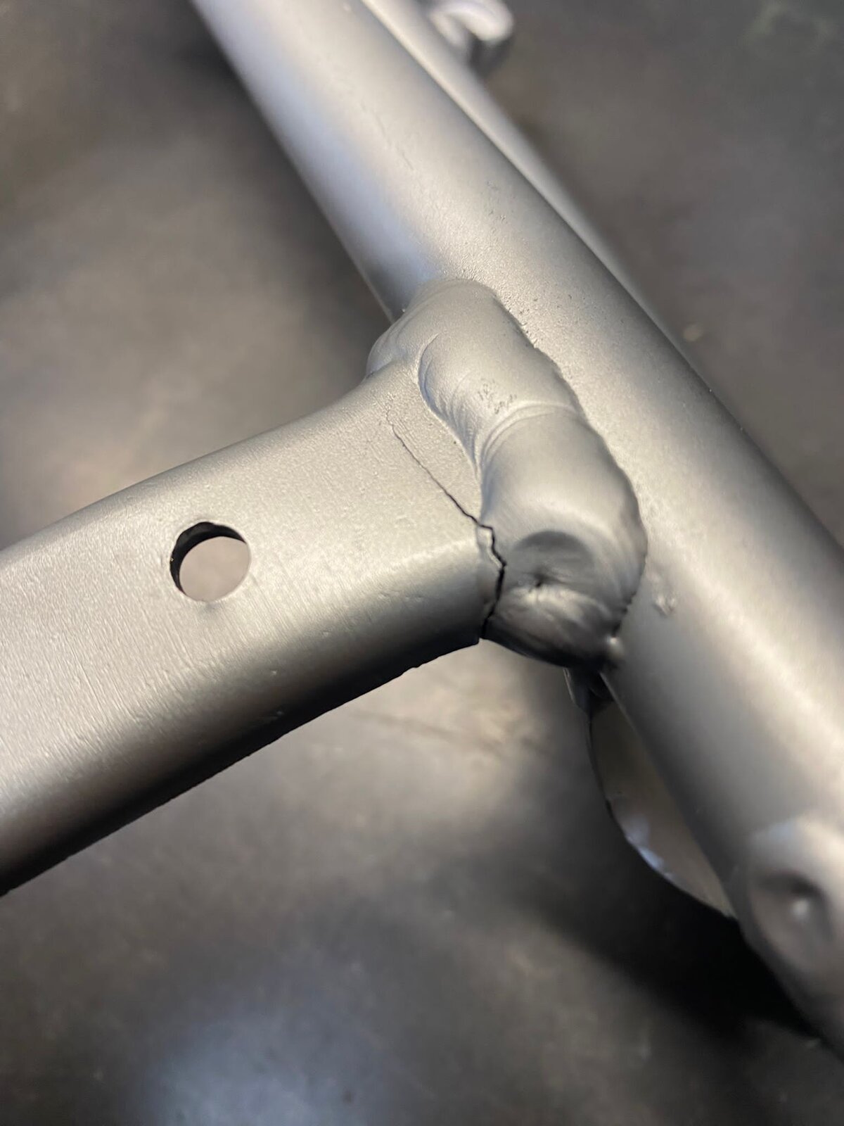

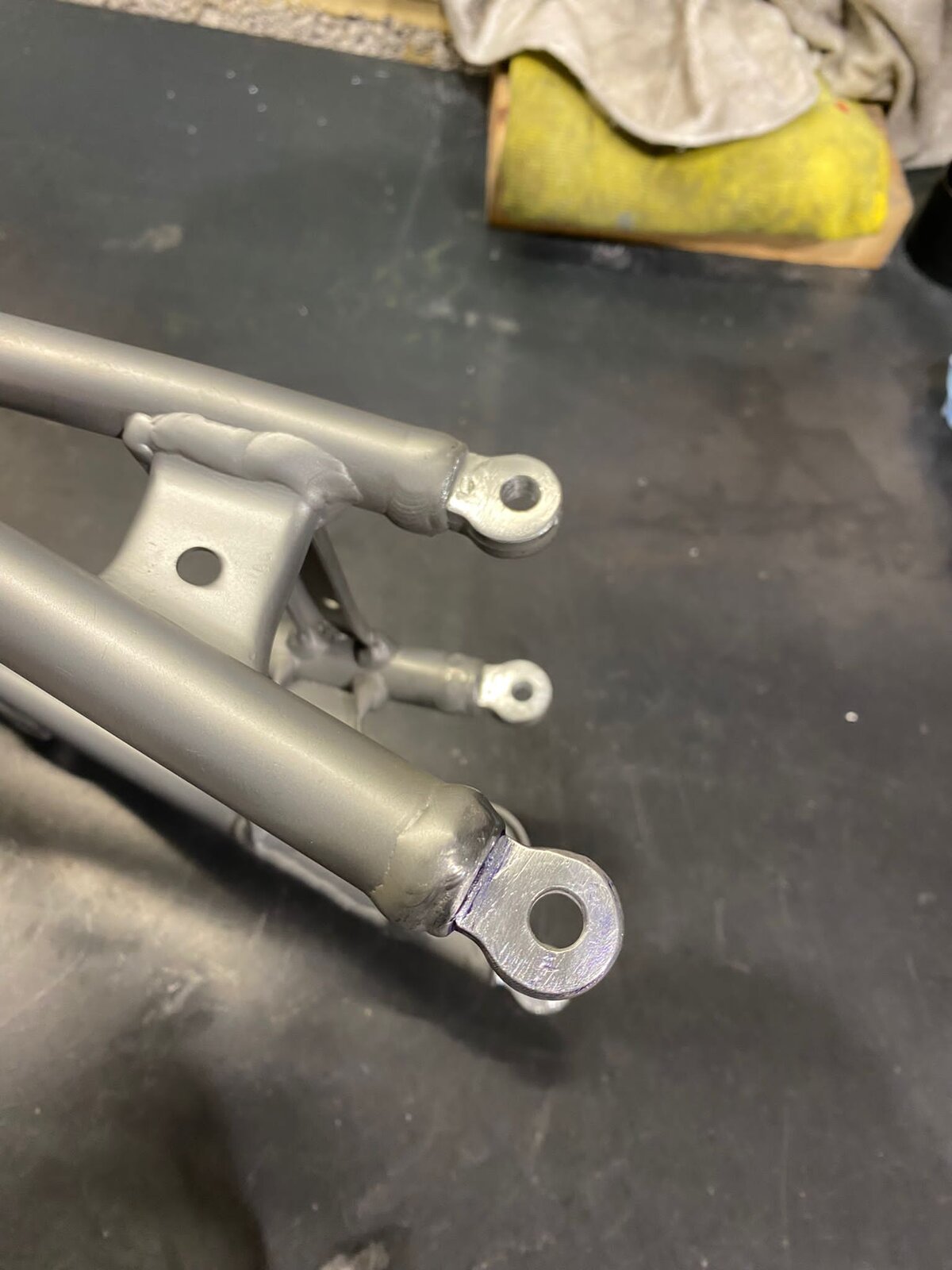

  16. I don't think I shared this update. The subframe that came with the bike was the ali mono version but after it was cleaned, blasted and cerakoted, it came to light that there were some cracks in it.
    I hadn't inspected it too closely beforehand but was still a little disappointed that the coater didn't mention it to me as he did admit to seeing them quite early on.
    Anyway, I asked a local custom place to fix it up and on closer inspection, not only was it cracked, the mounting holes were stretched and it was out of true.
    He welded up the cracks and re-did the mountibg holes while straightening it up while attached to the frame. Turned out quite well in the end.
  17. Looks like that subframe may have been whacked at some point in its life.
  18. Certainly. Probs the same reason the bike has a 96 front end and a different frame.

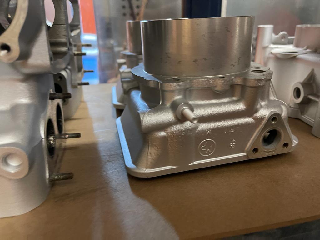

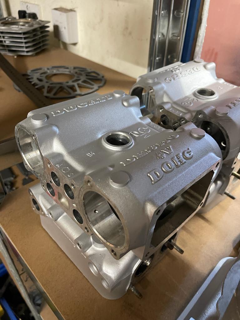

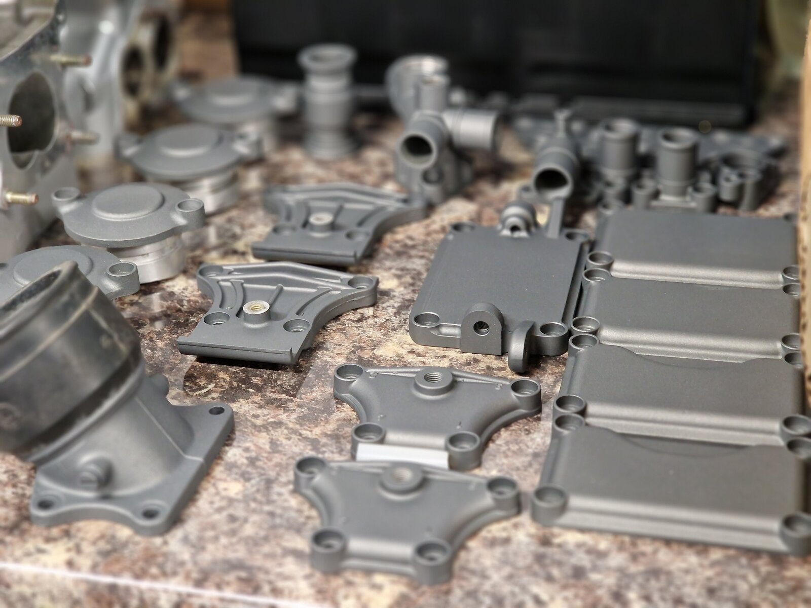

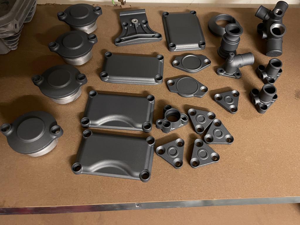

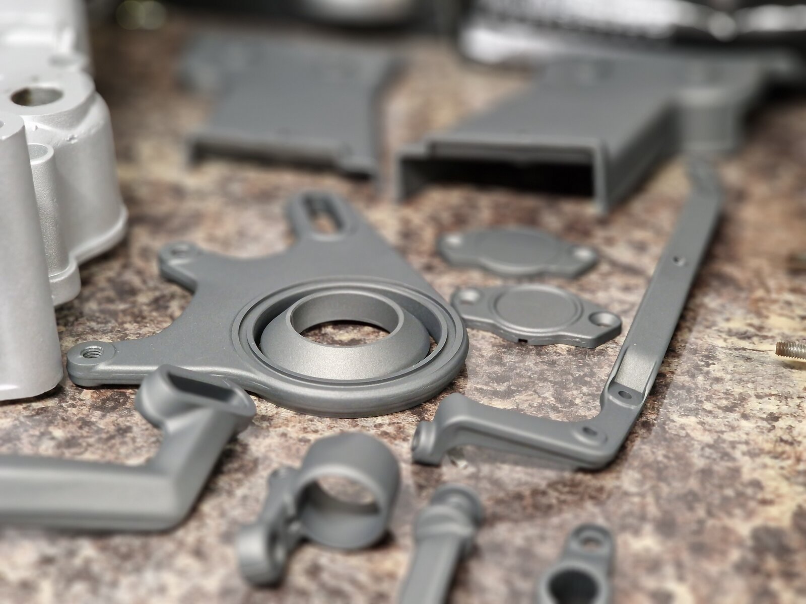

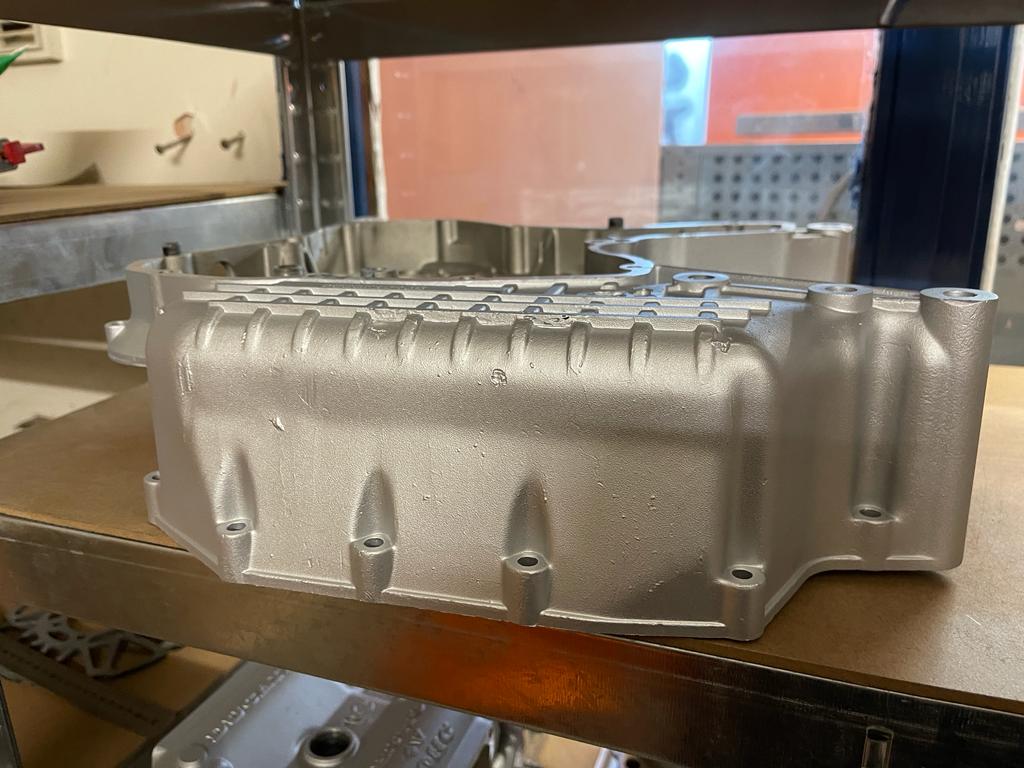

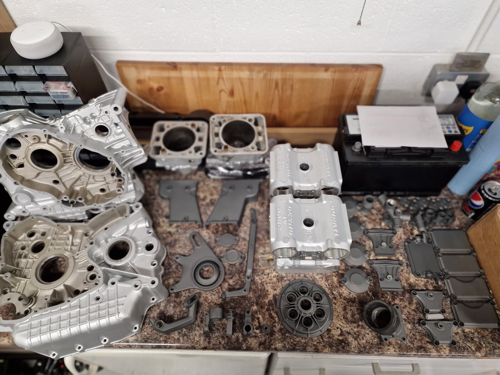

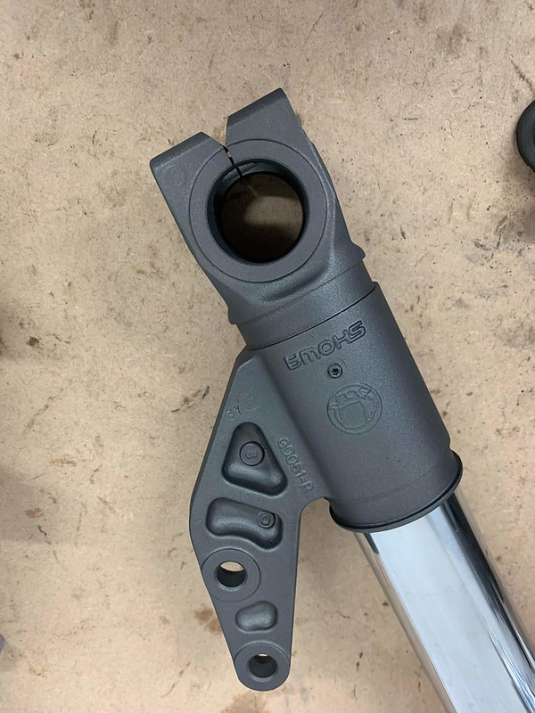

  19. Picked up the cerakoted parts today. I need to get everythingout for the obligatory picture but these will do for now.
    A couple of items were meant to be bare silver and cleared but I'll think about whether they'll do in this colour for now - mainly the non engine parts like caliper carrier etc.
