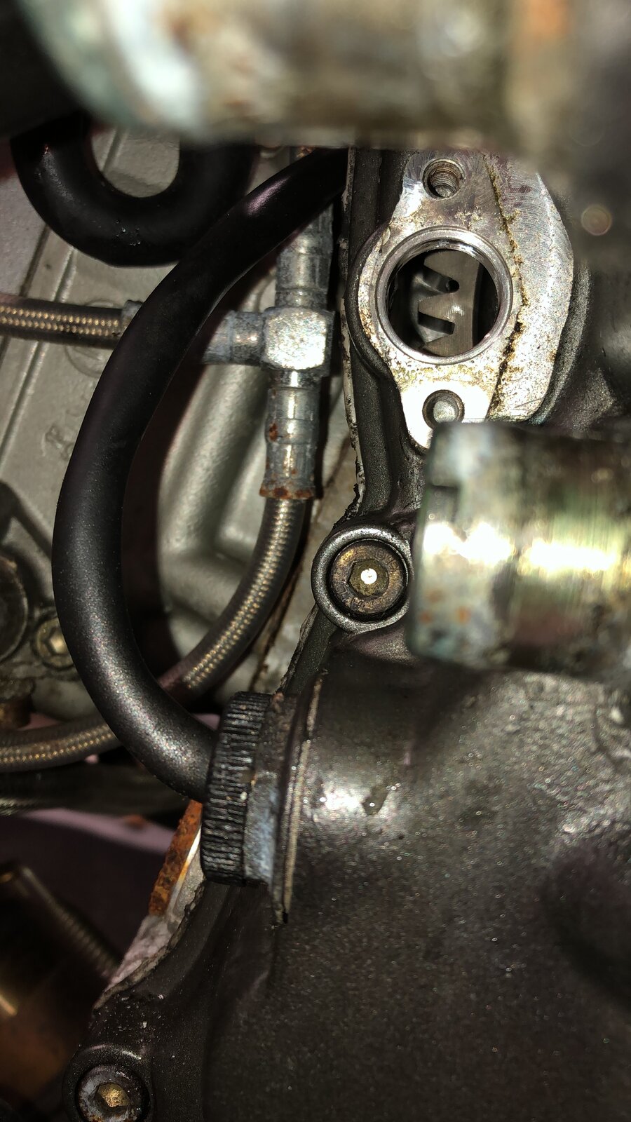

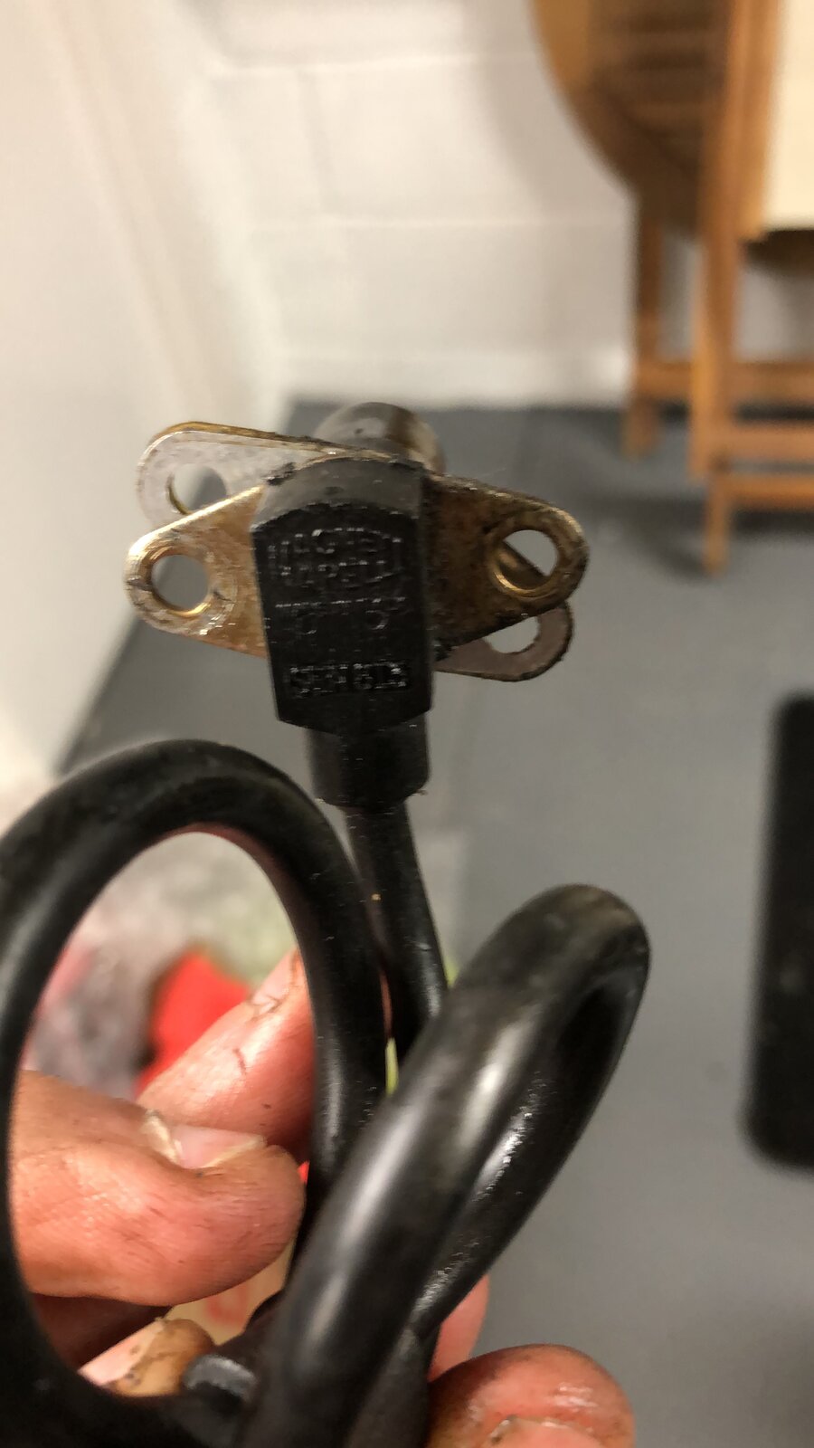

  13. Help guys!
    What is this??
    It has a plastic threaded collar on the front of the crank case
  14. Ignition sensor
  15. Thanks
    Do you know how it comes out of the crank case?
  16. Your first picture is the crank position sensor, it should have a plug on the end. The second picture looks like the alternator cable which is connected to the alternator inside the casing and goes to the reg/rec.
