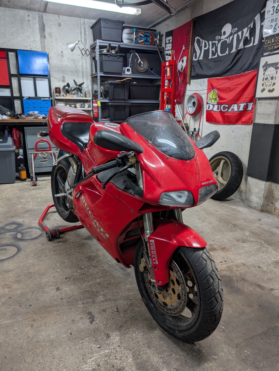

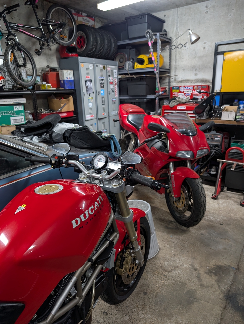

  1. It's time for another Ducati, after selling my S4R I decided on a 916, I figure it's the logical choice to pair with my M900.
    After looking for a short while a good friend and fellow Ducati fan asked if I'd like to buy his, he already has a few projects on the go and was happy to enable my addiction.
    It has 80,000 on the clock and hasn't been on the road for over 10 years but looks complete and was stored inside for the whole time.
    I'll probably try and restore it back to original at some point but first job is to get it running.

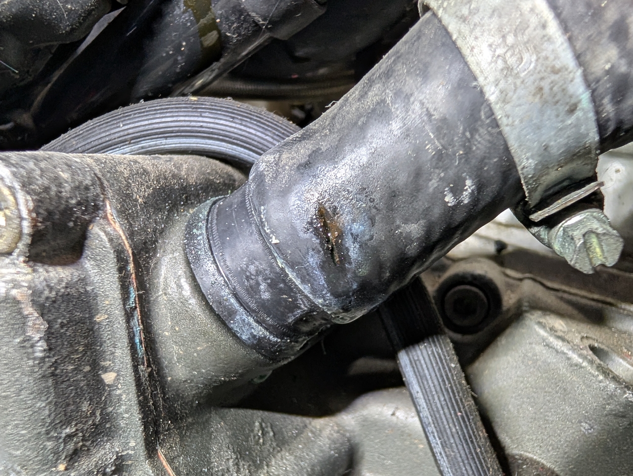

  8. I spotted some coolant drips on the ground, traced it to a split in a hose, easy enough to replace with a good used one.

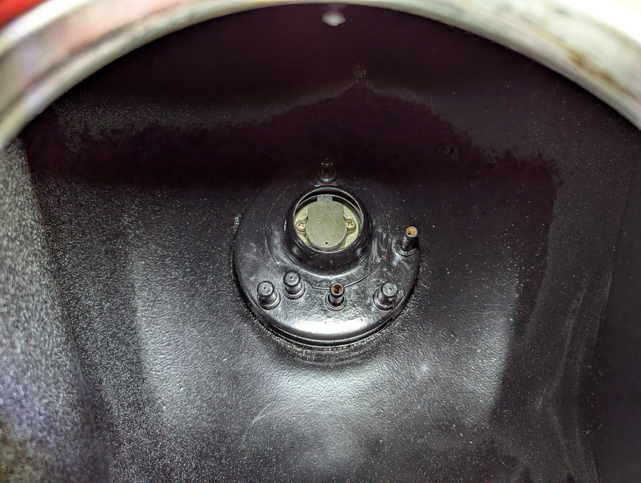

    I have been wanting to get stuck into the tank as the old gas is smelling out the garage.
    Peeling back some suspicious electrical tape revealed this mess.
    No biggie, new plug on order and onto the next bit.
    I didn't get any pics removing the pump plate as dealing with the melted hoses was a bit of a mess so they were relegated to the bin and I changed gloves before carrying on.
    Mostly cleaned up, I need to order a couple seals and a new pump intake filter (thankfully the pump was clean inside and spun up nice when 12v was applied briefly).

  12. While I am still waiting for some of the tank parts to arrive I fixed up the wiring.
    The insulation was hard and cracking so I took it right back to where it comes out of the epoxy. New wires soldered on with heatshrink and a bit of high temp silicone around the base of the wires for some added protection.
    I cleaned out the remnants of the goo from inside the tank, was happy to find it is in really nice condition

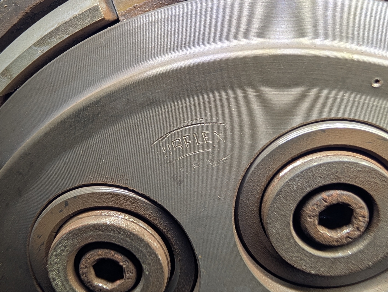

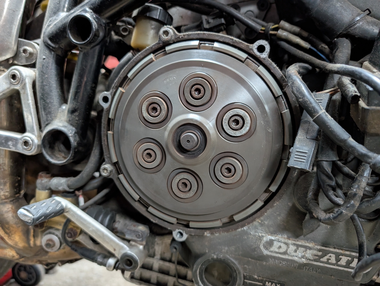

    At some point I had a look at the clutch, I didn't recognize the pressure plate but saw the name.
    I haven't pulled it apart yet as I needed to fix the slave cylinder. I was keen to keep the original one so cleaned up the bore with some 600, 800, 1200, 2500 wet and dry and some autosol then threw in some new seals. The master was clean so I bled it up, fingers crossed no leaks so far.

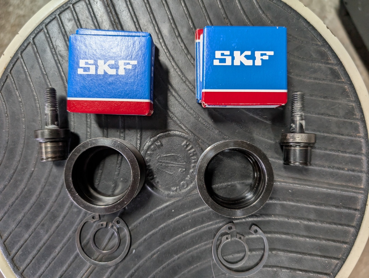

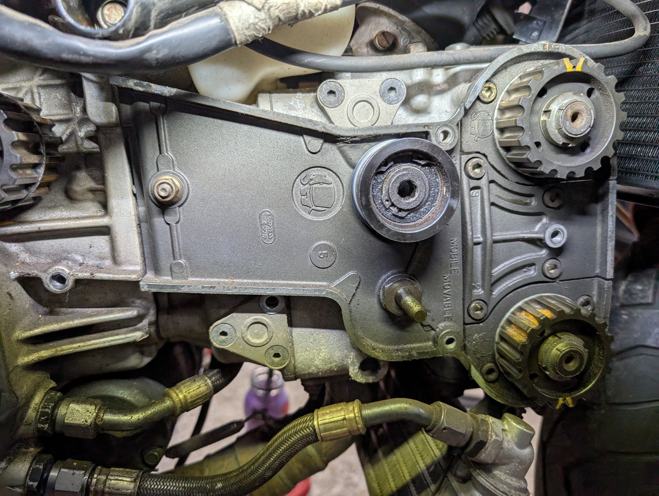

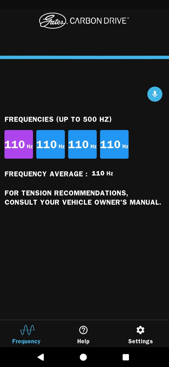

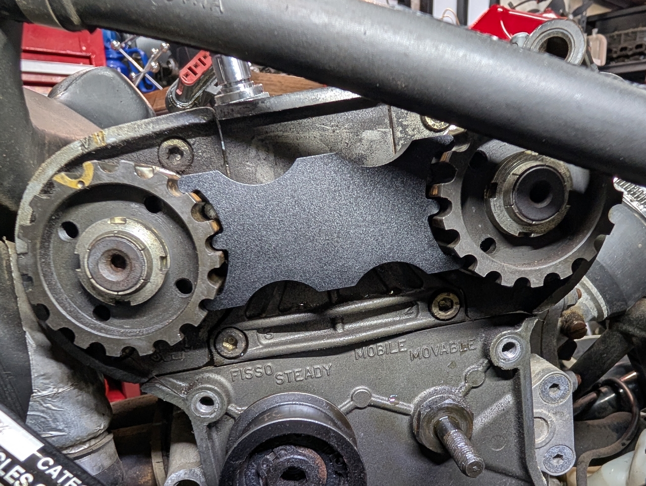

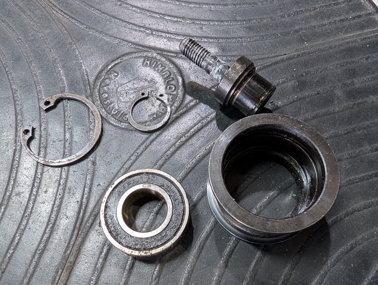

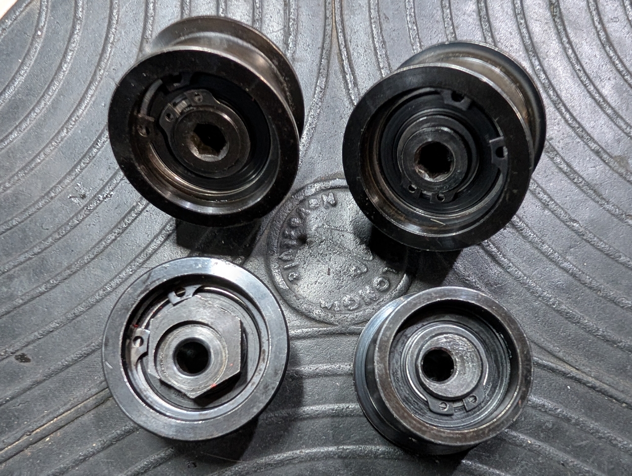

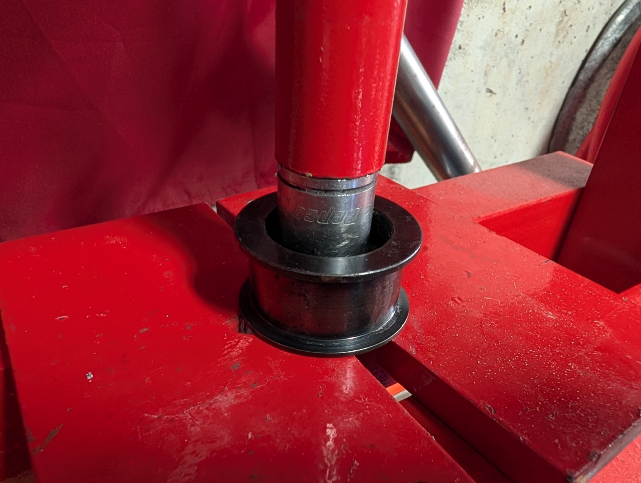

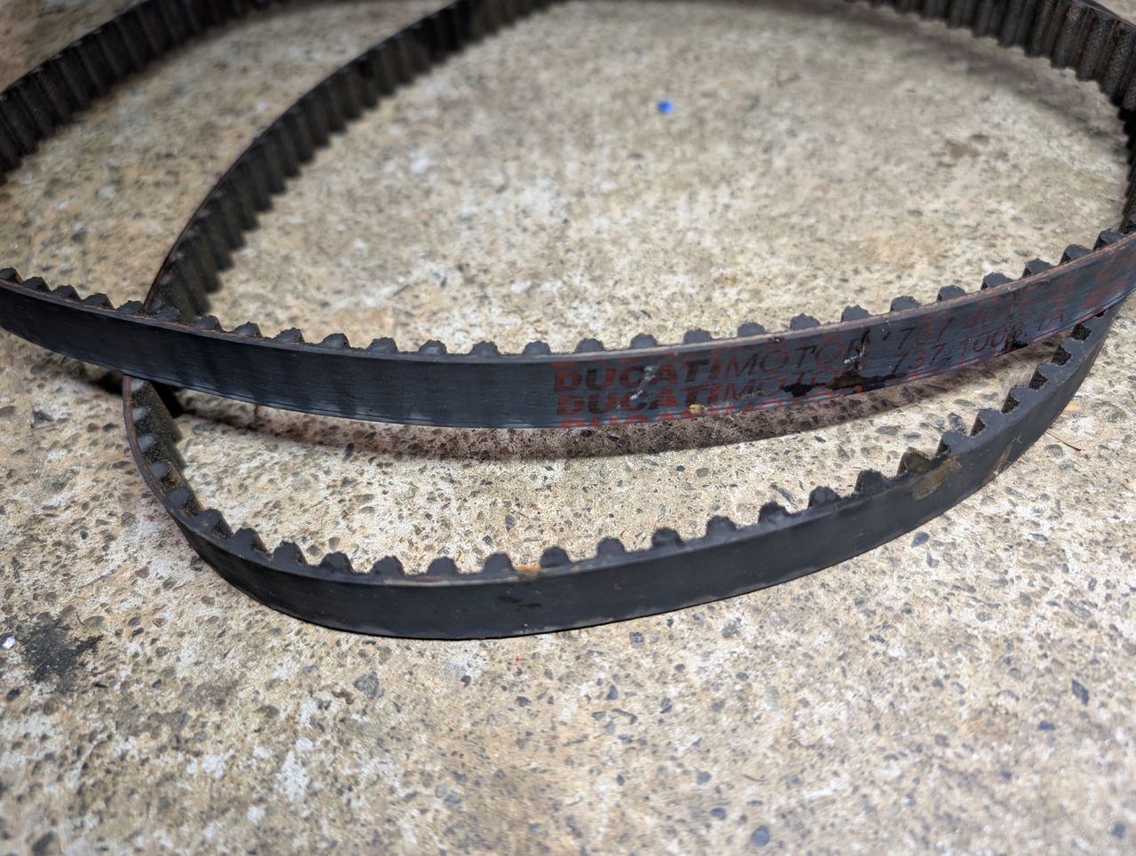

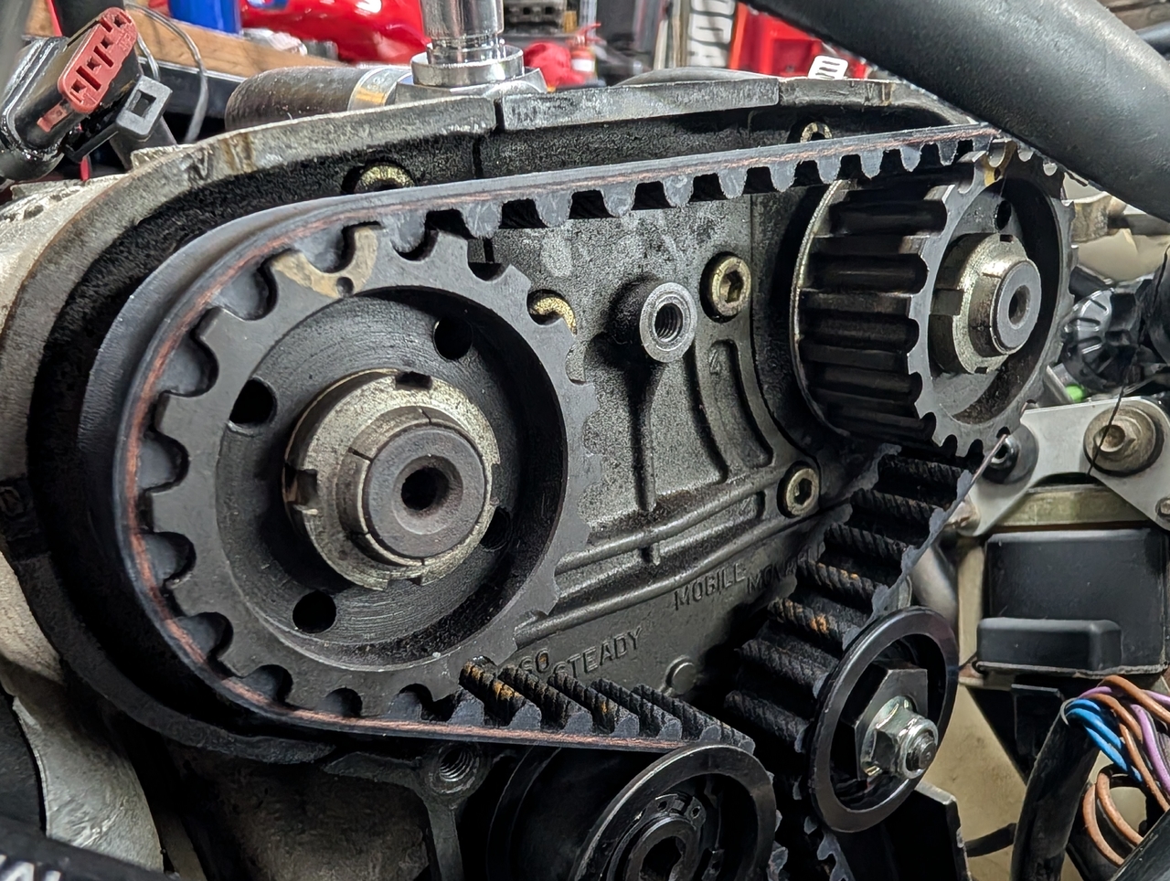

  20. As the bike had no history, new belts were needed. I ordered new bearings for the idlers and tensioners too as I figured they probably need doing as well.
    I finally bought a cam holder for the vertical cylinder, definitely a bit easier putting the new belt on now :)
    The old belts seemed ok as they always do but it's better to know they are ok.

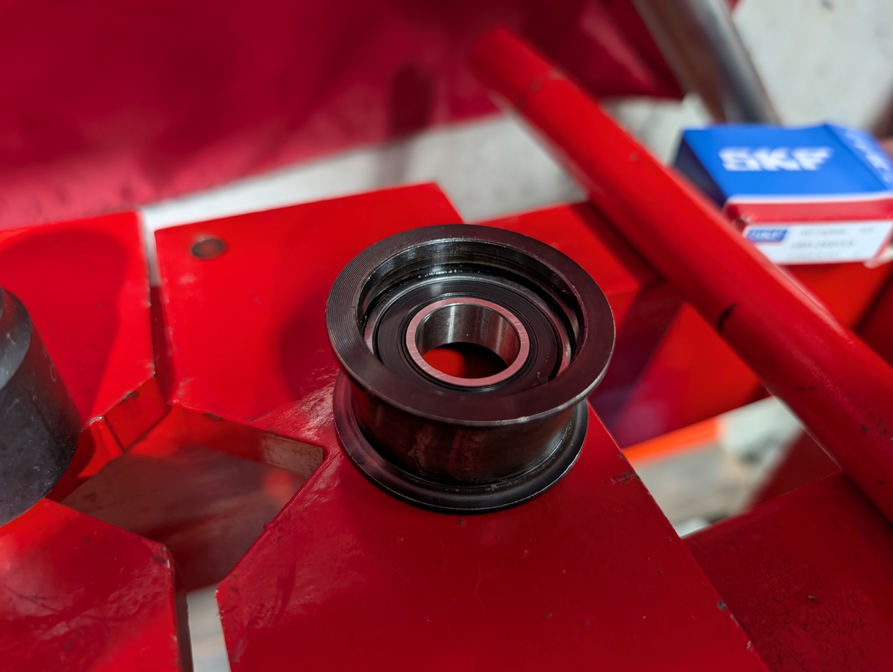

    The idler and tensioner bearings weren't showing any play but felt like they had lost some grease so it was good to change them out.
    Pressing old out
    Cleaned up and new bearings ready
    Pressed in
    Ready to go back on
    New belts on
    Tensioned up (anticlockwise :) )
    Then reassembled whilst enjoying all the little elephants
