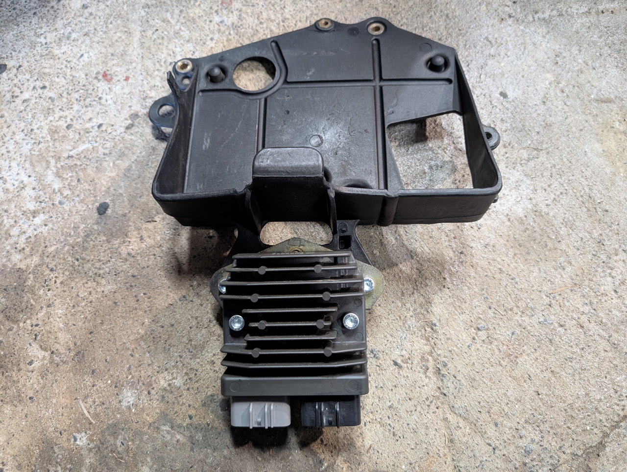

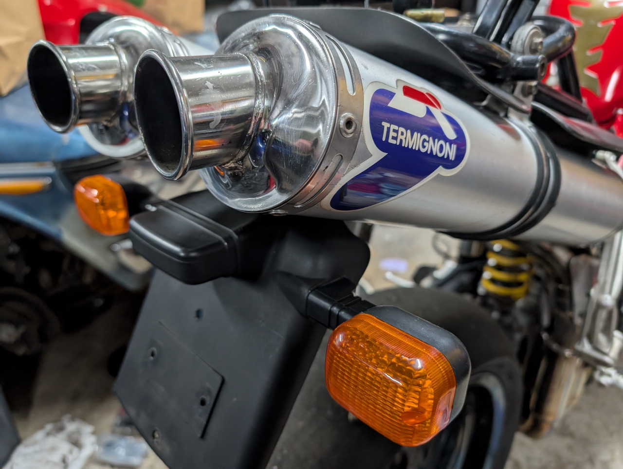

    Replacement RR fitted. I usually keep a mosfet RR in stock, I buy them cheap when they pop up so I have them for any new Duc I buy.

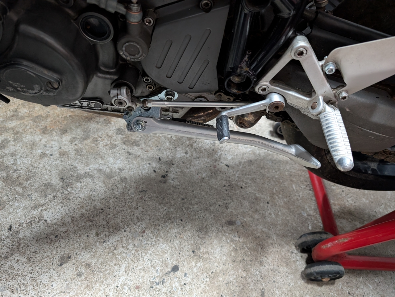

    A new stand was also on the to-do list, the old one was pretty ugly. I found a nice 1198 item and swapped them over.

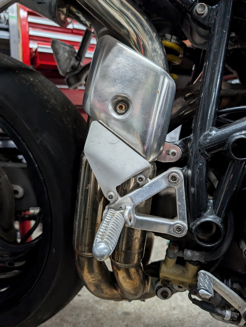

    One of the heel guards was missing so a replacement set were sourced.

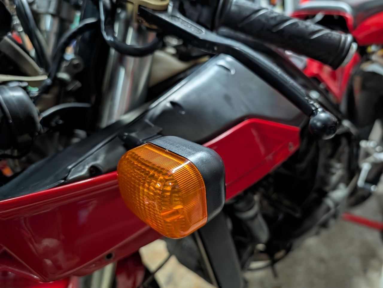

    Two indicators were missing and the remaining two were tatty so reproduction items were fitted.
    The rear guard was also replaced with a non-damaged one
    The main issue I had to address before starting the bike was the fuel system.

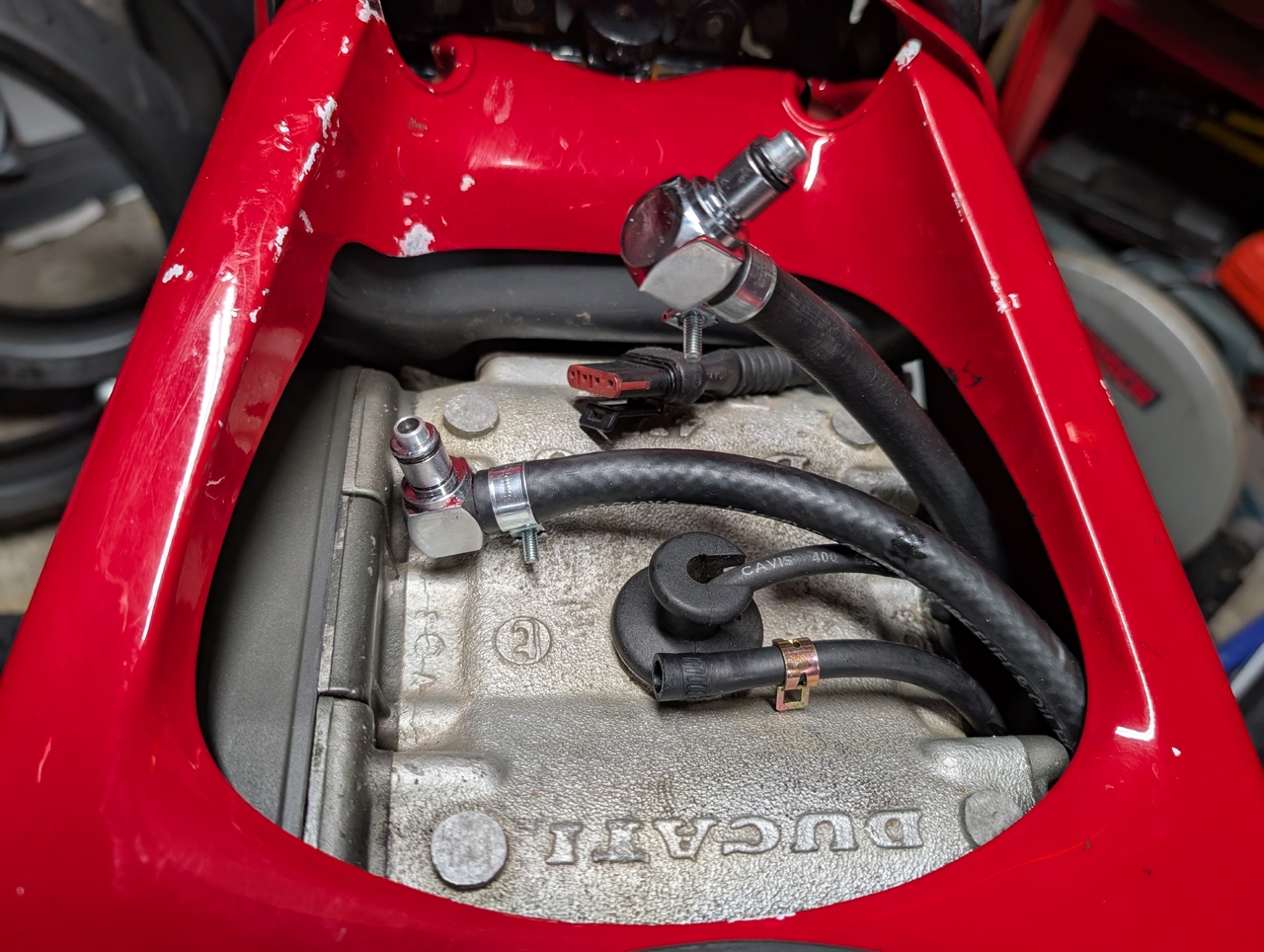

    I replaced the hoses, filters, pump and quick disconnects
