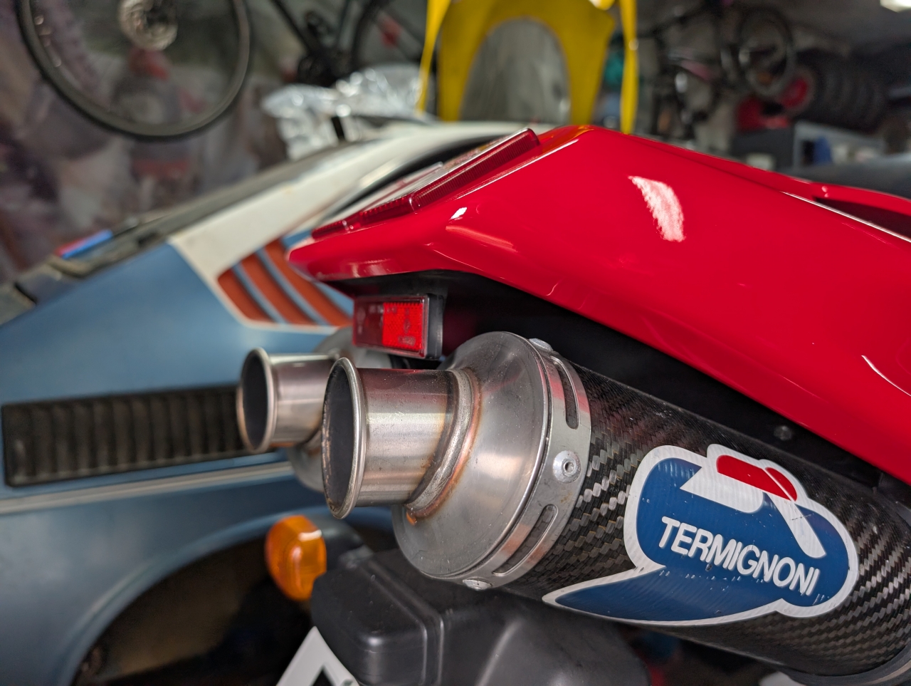

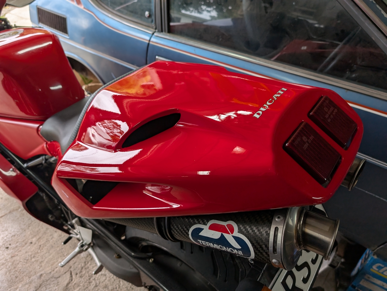

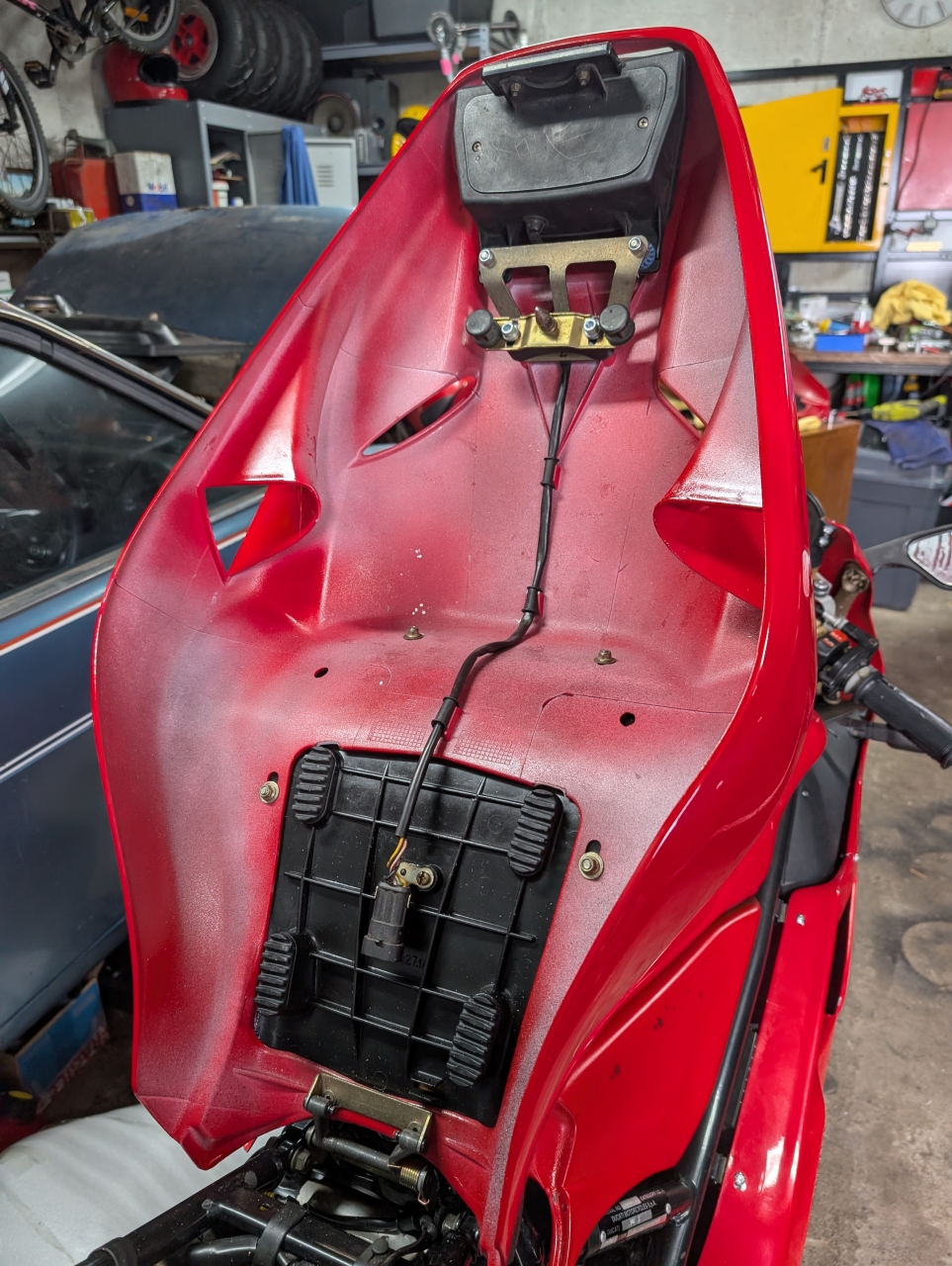

  4. After looking at biposto conversions I decided to give an aftermarket mono seat unit a try. Ordered it straight off AliExpress and took about 3 weeks to arrive. I'm pretty happy with it for the price, it's the right shape and red haha.
    Fitting was pretty straight forward, I had a mono tail light bracket and seat already so after swapping everything over and drilling some extra holes for the seat (the unit came pre drilled for the bip seat only) I just needed to sort a spacer.

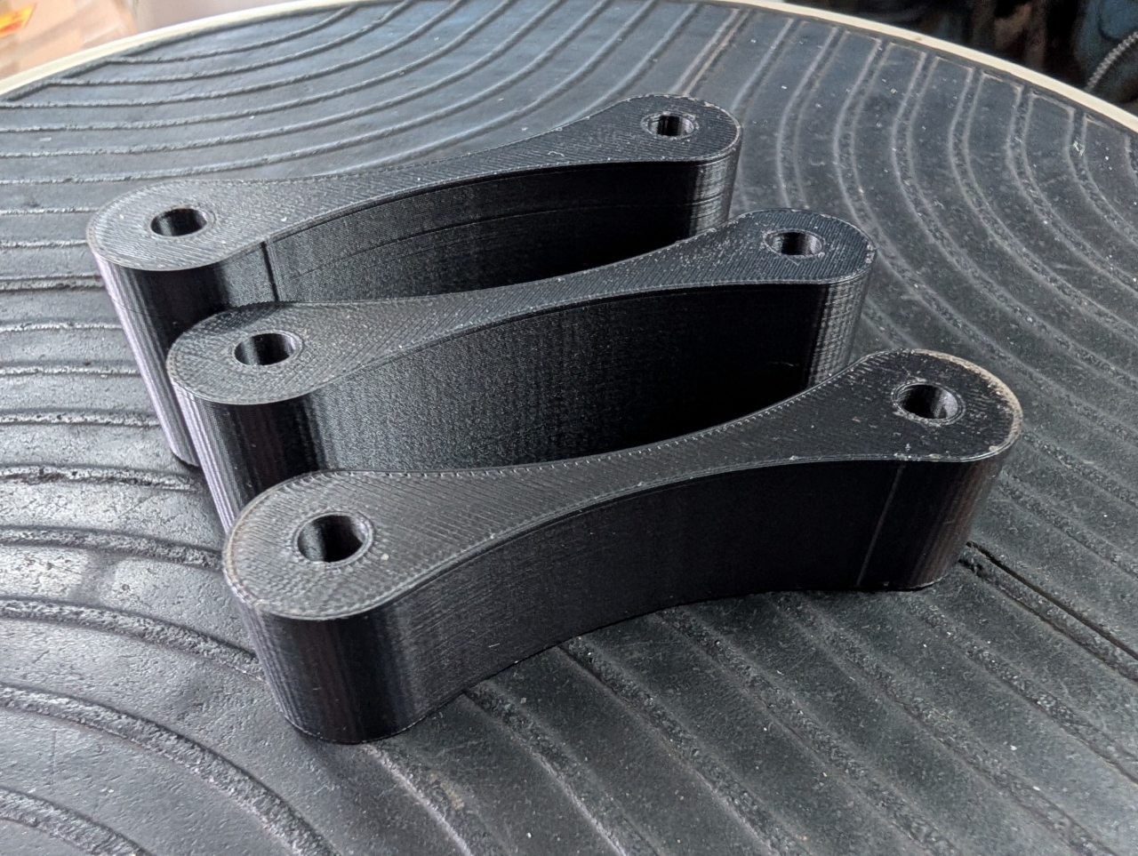

    I had seen a 3d printer file online so I tried that first but at 36mm it was sitting too high so I drew up another one and printed them at 30mm, 25mm and 20mm.
    In the end I made one more at 22.5mm and am now happy with how it sits.

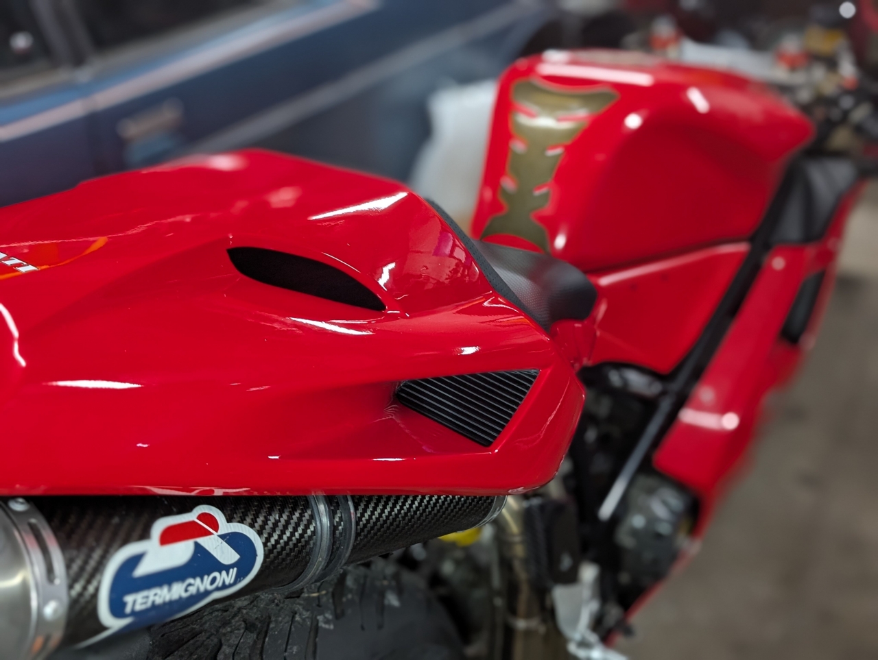

    The last job to do is to sort the vent holes, I have some expanded aluminium mesh but it is slightly bigger than factory and I have been a bit hesitant to use it as I don't love the silver mesh look anyway. If this bike was a pristine example it would be a no brainer to keep it stock but I was tempted to see what I could come up with as an alternative.
    Enter the 3D printer again.
    I drew some louvres up in CAD and was surprised how much I liked them, I'd like to hear others opinions. The bike has black wheels and frame already so these fit in that respect.

  5. Great work, that looks pretty good for an aftermarket piece. I've been toying with the idea too but it's getting hold of a mono seat thats partly stopped me doing it, I didn't realise they come pre drilled for the BP seat. How do you think the BP seat would look as an interim?
  6. I reckon the bp seat is fine to use, I would have done the same if I hadn't found my mono seat.
    Only a 916 trainspotter would know the difference :)
    I forgot to mention the decal on the back is from the factory, I also bought the foam pads that stick on the underside.
  7. Appreciate that thanks :upyeah:

  11. Me too although unfortunately the upper vent was proving too difficult to model for a snug fit so I shelved the idea.
    Maybe I can try it again once I have more experience and even look at 3d scanning to improve the fit.
    Here is where I got to, I could have shaped them to fit with a dremel but it was becoming a bit mickey mouse :)
    So 20mins later with some aluminium mesh and glue I had this
    Which looks like
    As mentioned earlier it's a larger mesh but at least looks tidy.
