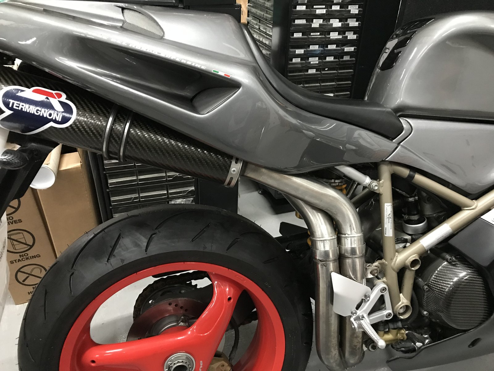

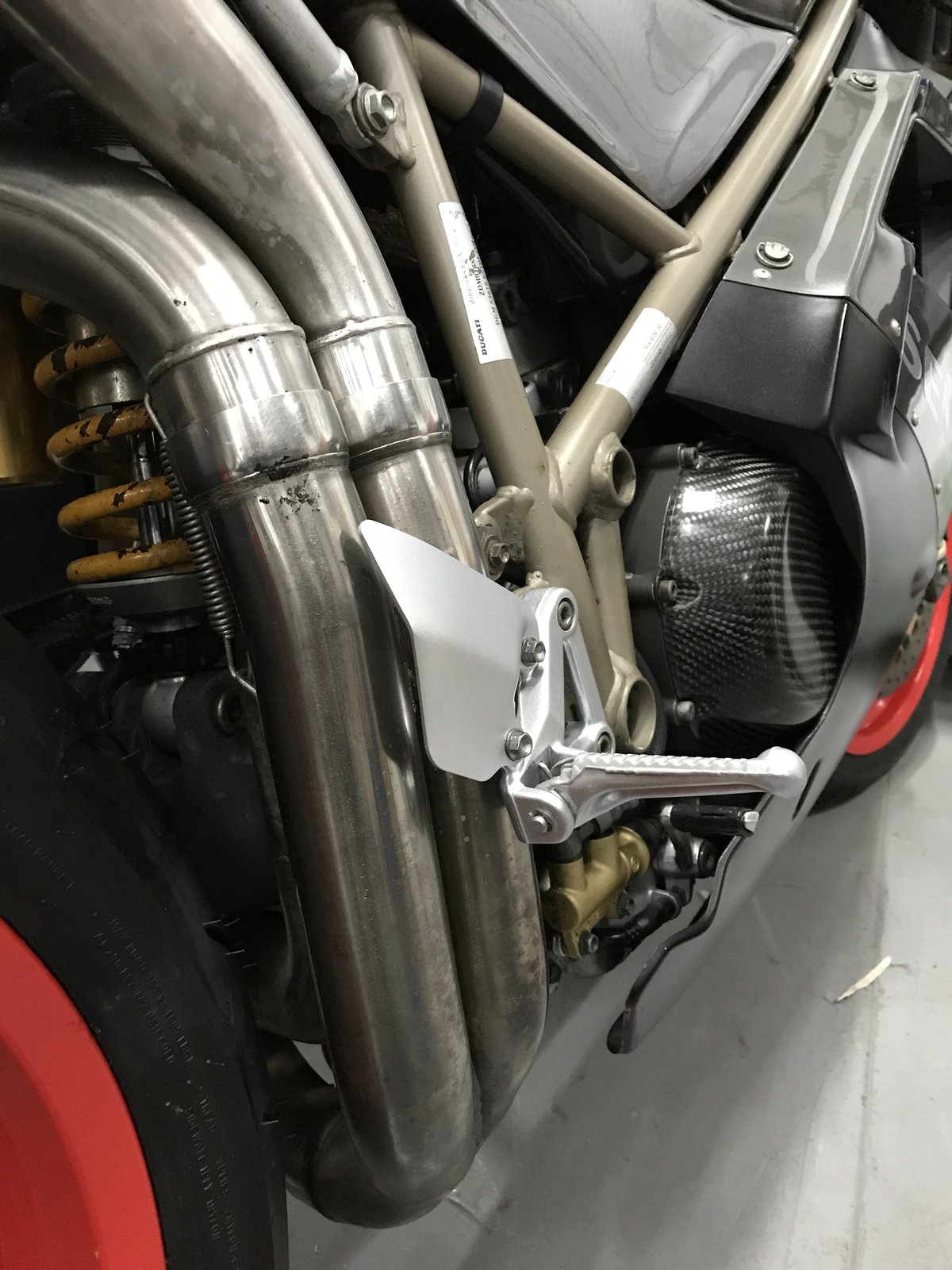

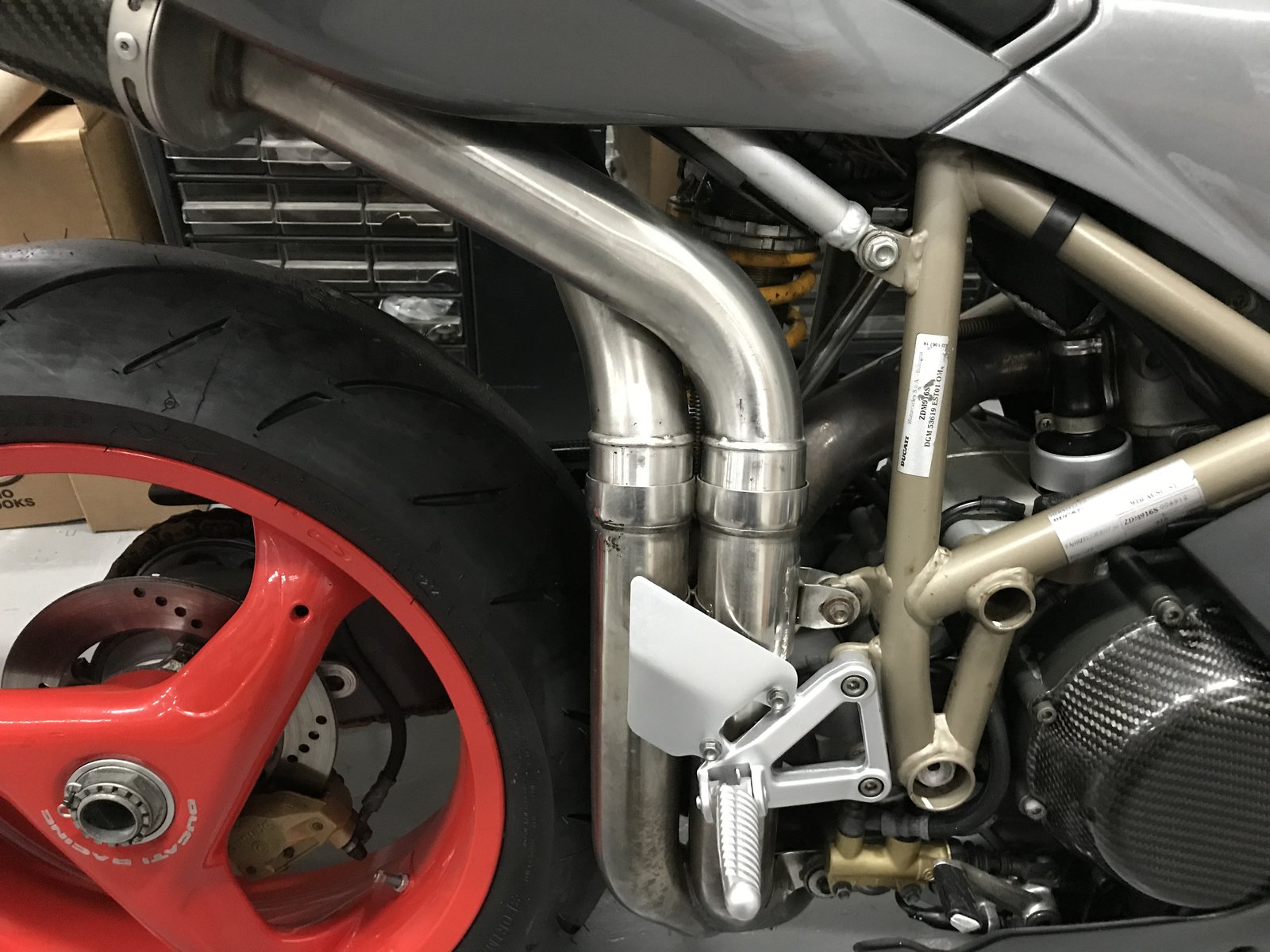

  1. 6ADFFAD8-7E2E-4FEA-8CC5-D01CBD4E5063.jpeg AEF2B857-DDA8-4F52-9E6B-96F698EB0E44.jpeg 488C4704-62DB-4571-A476-728E7DC60F32.jpeg 68E53781-A594-47D9-BBE9-395FFC0BF14A.jpeg Does this looks like standard Ducati termi system? Looks slightly different to Ones I e seen before? For example no mounting points for exhaust heat shield ???

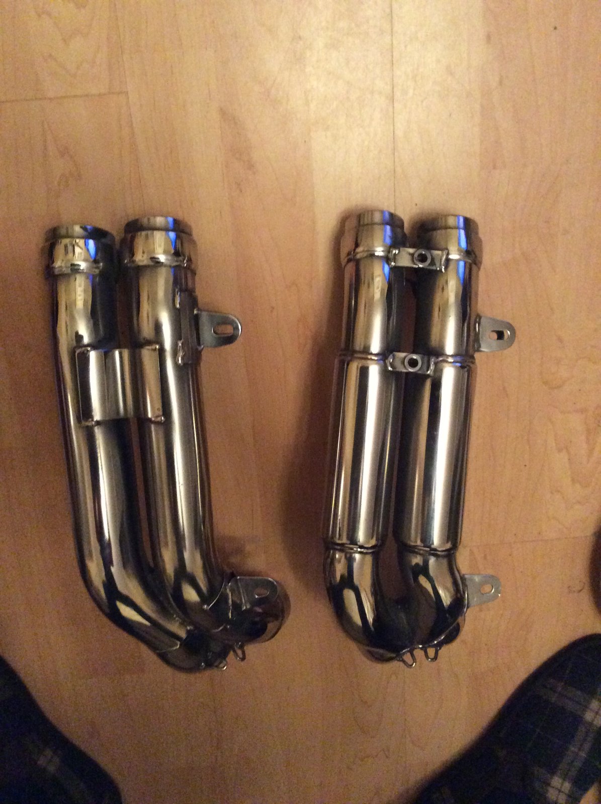

  2. This is a picture of a 45/50 (L) and a 45/45 (R) middle pipe. The heat shield on the 45/50 system on my 748R is attached by a jubilee type fixing that attaches to the end can pipe work. I've not been able to find a clear photograph on the internet to compare. Andy

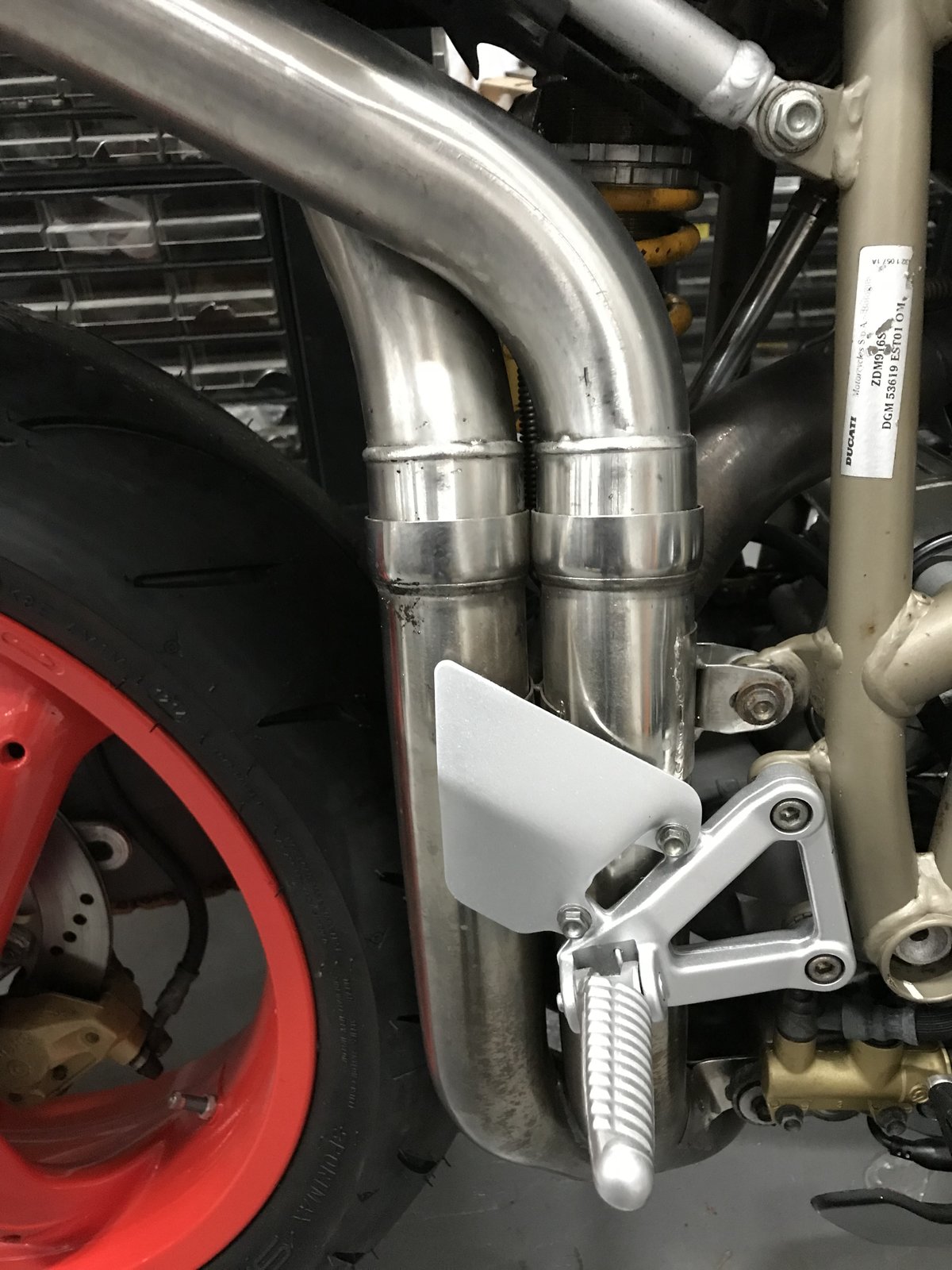

  3. Okay, I've done a bit more looking and I'm pretty sure (might be wrong) but the original 916 Senna Mk1 came with a 45mm exhuast system like this.
    From your picture, it looks like you might have a 45/50mm mid pipe so the lack of heat shield fixing is probably right. If I can find it, I know the type of heat shield fixing you need has been discussed on the forum. I'll keep digging. Andy

  6. thanks, so does it mean that I have 50mm system with 45mm cans??? bit weird? also- my shock it not in the best condition cosmetically, it there places which are recommended for ohlins rebuild?
  7. Aha!
  8. Other way round, 40mm system with 50mm end cans which was a common "upgrade". Someone posted about a shock service very recently so have search, lots do it. Andy

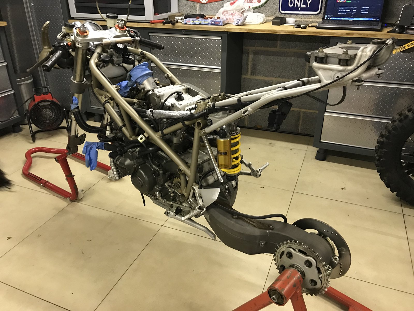

    Mk1 almost ready to go back together - wonder how many bits will be left over :no_mouth:
