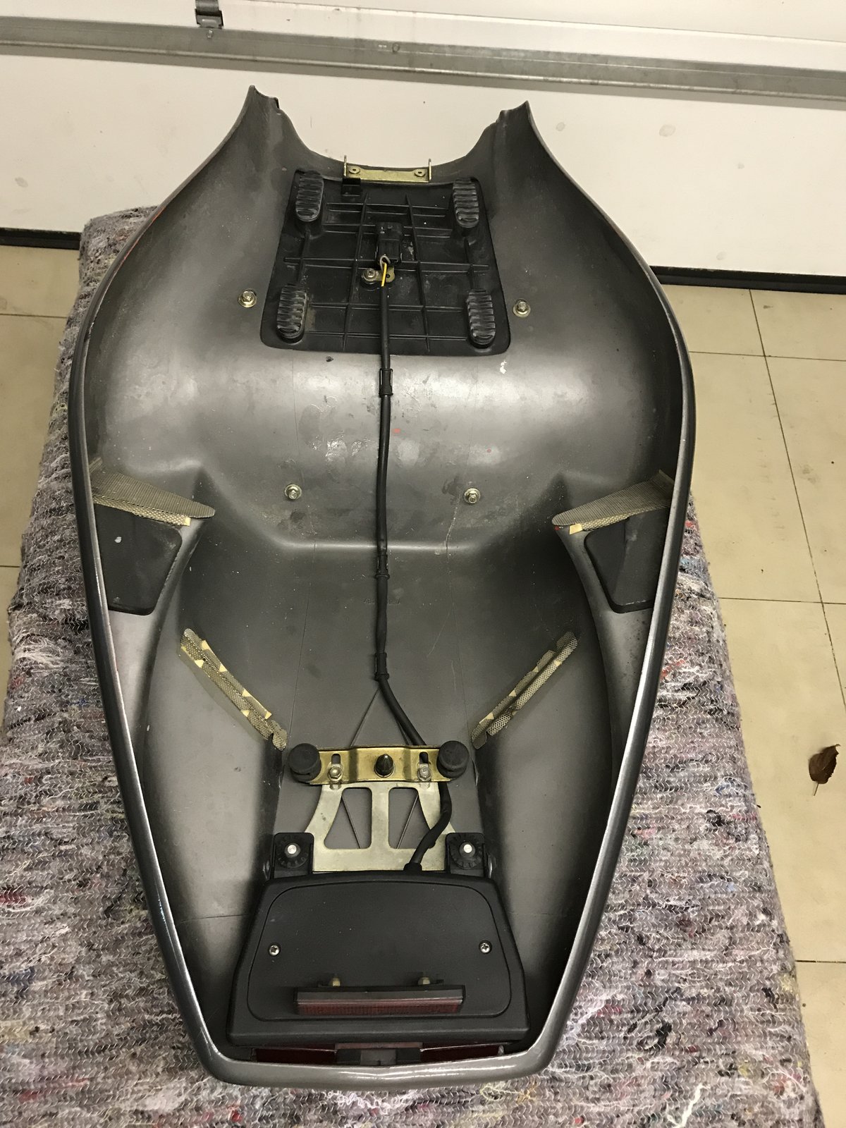

Discussion in '748 / 916 / 996 / 998' started by yev, Oct 20, 2017.
  1. i need to get my shock looking same as yours!
  2. what number is yours? can you check seat fairing for me pls? do you have red under the grey same as i do?
  3. Would have to scratch the paint off to see o_O
    I wouldn't worry re the paint, had several 748's in the "Senna-ish" satin grey and all were originally red underneath - most start out as a std panel and are painted at the factory in the special colour.
    Will put some more pics on here as I go along
    Does this help - does yours look similar?
  5. Top left of the picture on the edge of the seat unit - is that a slight bit of red showing through?
    Is is plastic? Looks a bit rough for an injection mould tool but for short runs it could be an aluminium tool.
    Any date stamps might be hidden under the seat support bracket...
  6. Mine is exactly the same!
