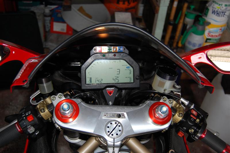

  9. The photo shows 14.2v at 3000rpm yours should be
    around the same give or take a little.
    brian.
  10. Nice set up Brian!
