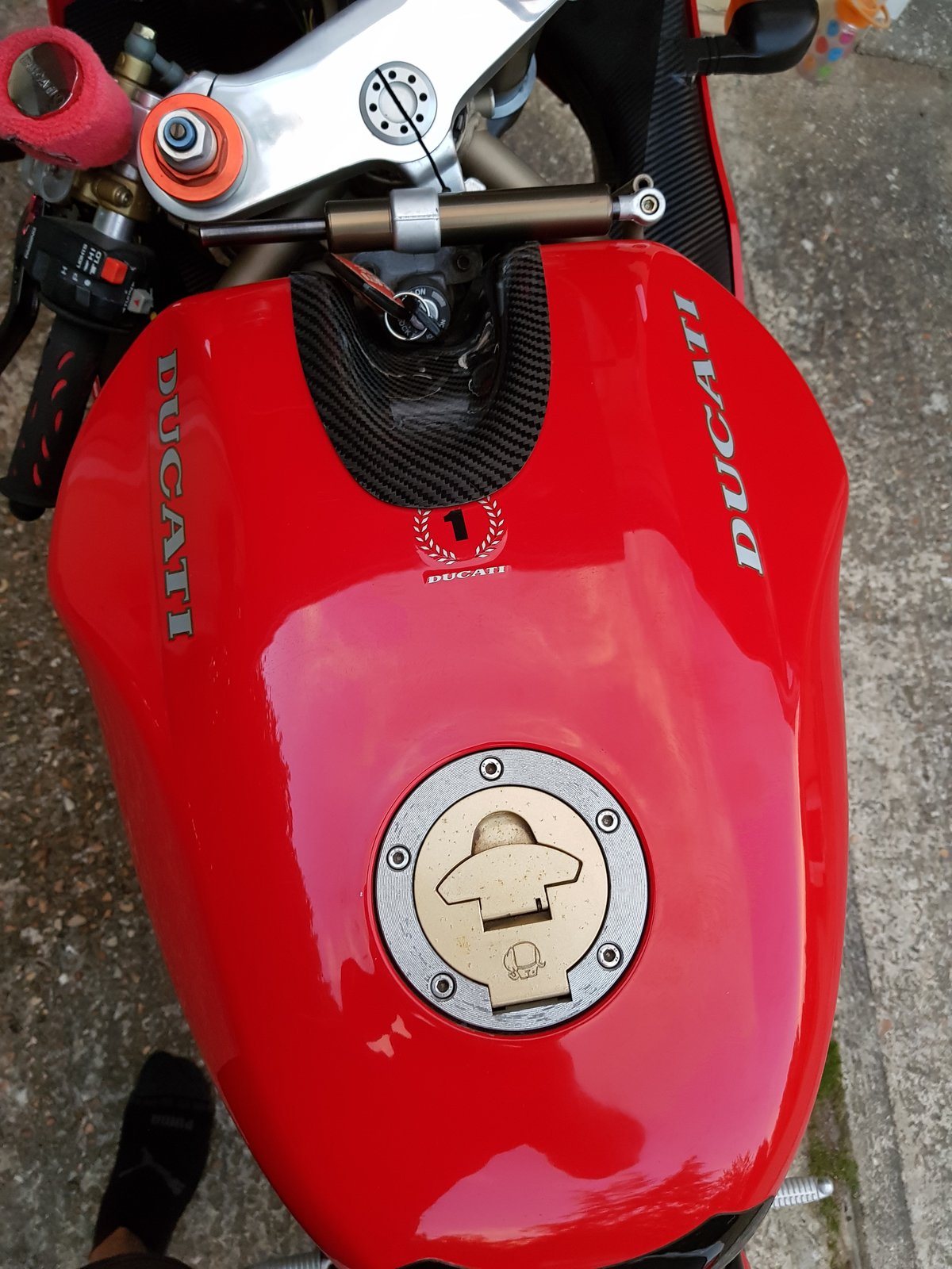

  1. Of course the sting is the original price tag sting and sorry but £1000 Just wouldn't buy it! Lol it came with a carbon hugger with a tube for the pipe too run in, would things like this De value it as well? Are we talking completely factory for the best money? Even tho I never want too sell it!

  5. It's got the logo on the cap but can't find one on the screen anywhere thanks for all the advise I've been looking for this info for 4 days on the net but could really find much just bits really

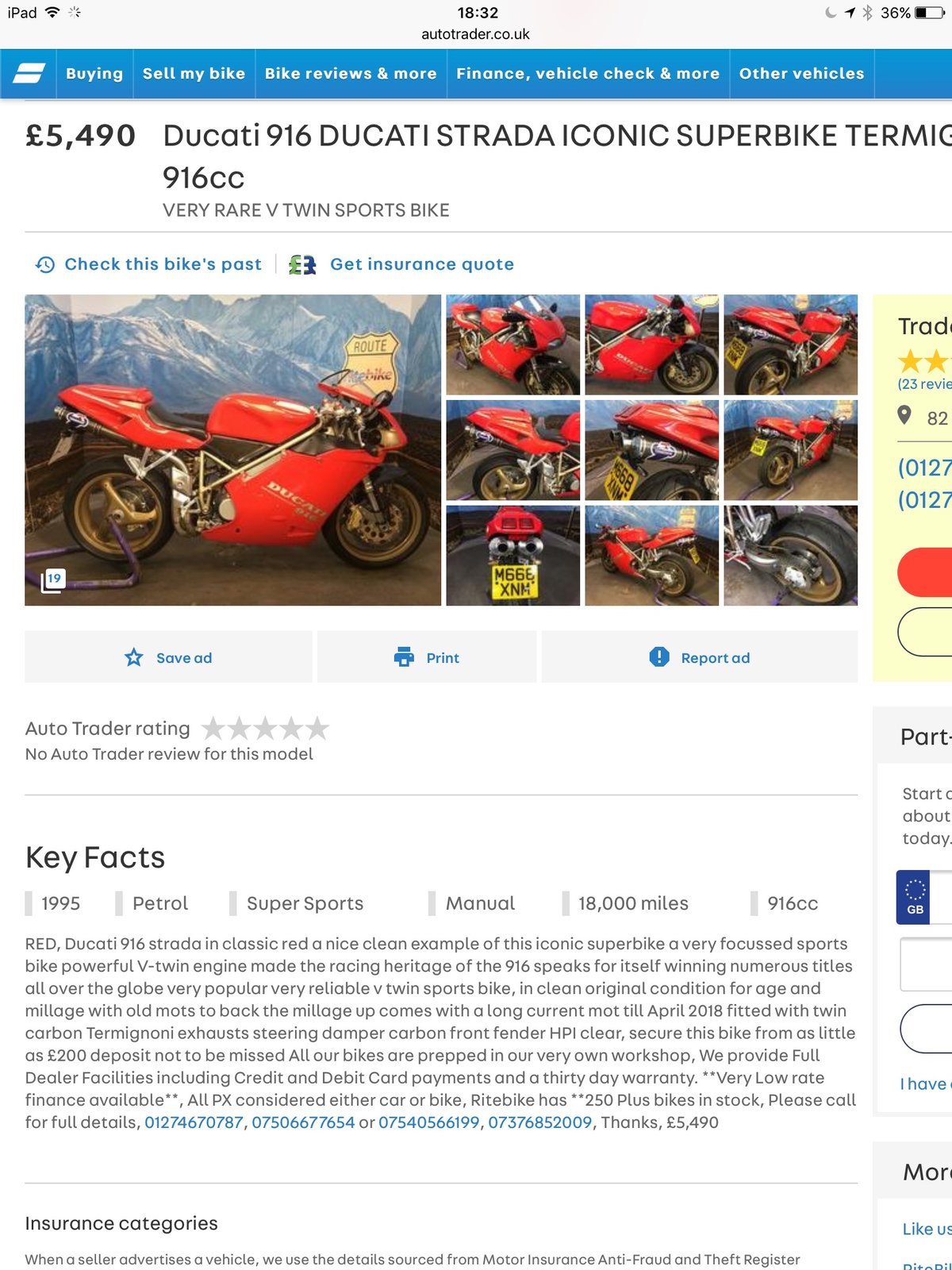

  9. I would have thought all 916's registered in 1994 were Strada's/Monoposto..
    The Biposto was introduced in 1995. You see the occasional 1995 Bip on an M plate but mainly N plate onwards....
    Like this one advertised on auto trader....
