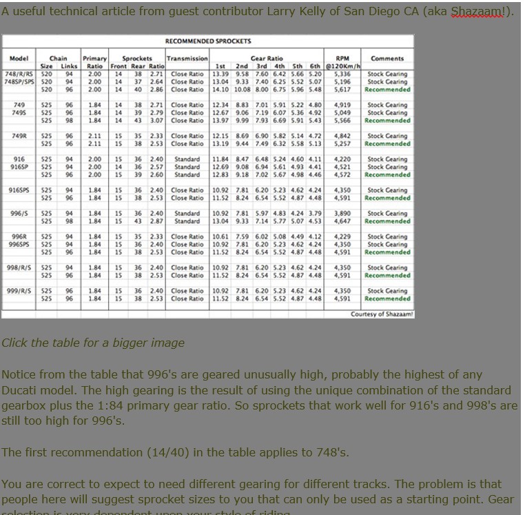

  9. This might help. It's a little small, but you might be able to blow it up to a larger size.
    • Useful Useful x 3
  10. That's very useful Red998 even tells me chain length which was also confusing my tiny brain!
