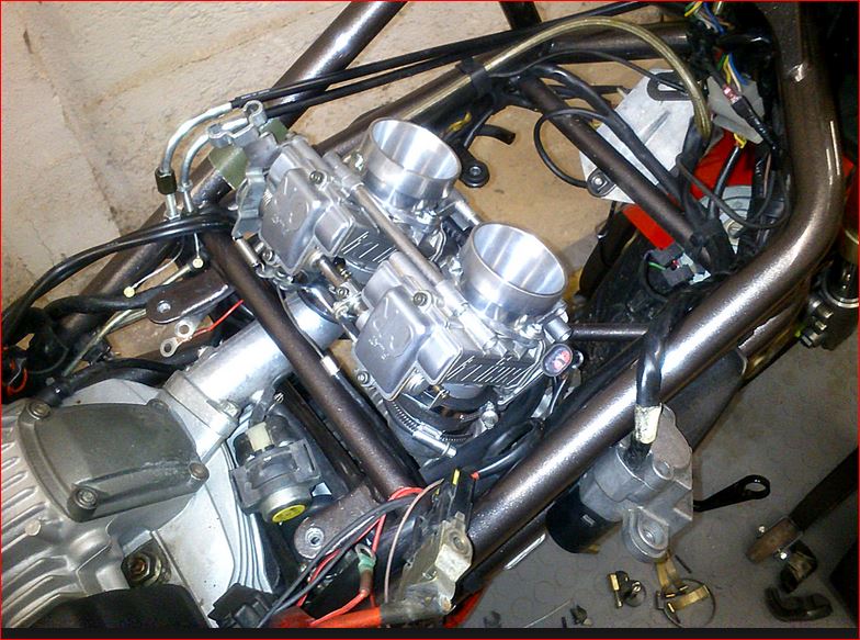

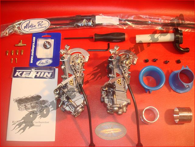

  11. I know plenty, my motor in Ducati Bunburys frame ran high 10secs and was good for105rwhp you know of any other Superlights good for that?
    reangled valves, bigger valves, straightened inlet, modified squish bands, high comp, race exhaust, Daytona cams, 954cc and FCR41mm Keihen carbs, race exhausts
    You are right, I was thinking talking of the only carbs i ever had on a 900ss; the only ones i would put on a 900ss but my description holds for all motorcycle carbs from Amals to Mikuni, Keihin, and was only offered as a quick way to diagnose flooding float bowls
    Tuning them, my method;
    Fit lambda probe bosses on headers,
    mount readout where visible
    disconnect accelerator pump on carbs
    mark throttle drum into 1/4 turns
    ride bike in gear required to balance power
    testing full throttle requires both needle jet and main to be correct
    test for 3/4 to full open, snap throttle lambdas should go instantly lean, but as the bike accelerates (rpm increases) mixture should strengthen to ideal, reattach the accelerator pump and you avoid lean-out but are assured of best power mixture,
    my bikes tuned that way cannot be improved on a dyno because the induction system operates in the exact pressure field as exists when riding, which is not provided by a dyno fan
    this is because: the depression on the jets is equal to the the inverse square of the gas velocity so if you double the throttle area, you halve the velocity, and the mixture goes 1/4 lean.
    this is why we have carbs that are constant velocity?
    the metering is independent of throttle position and only depends on the suck, (vacuum) so the vacuum on the jetting system stays the same, (because the air metering is is determined by rpm) the mixture doesnt lean out like a non vaccum compensated carb does; as the vacuum increases with increases in engine rpm the compensating slide opens to maintain gas velocity. this disconnects the inverse square law and the mixture tracks requirements better.
    The consequence of this is a slower engine rpm response to throttle inputs, Which means the gearbox feels lumpy, because hard to match gear/wheel speeds for down-changing with poor engine blipping, get rid of the CV carbs and you get a much better engine response and gearchanging
    separate carbs have straighter inlets and produce the most power

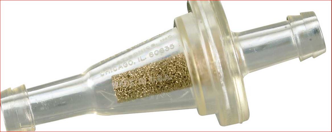

  20. Yep, I know bootsam;).......I was just adding onto your bit for the benefit of breakout..........a bit like adding that there is a tiny very fine mesh filter in the fuel system on the carbed SSs (but that wouldn't cause an overflow).
