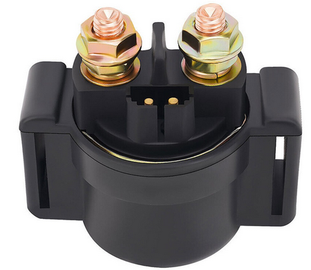

  1. I recently replaced a 7 year-old AGM battery which I assumed was the culprit since the engine would not crank even with a full charge. Although the new Lithium iron battery was charged to 13.7V, the engine still would not crank. The starter relay would "click" when the starter button was pushed. There was also an audible "click" in the starter itself. I assumed that this was due to the starter engaging with the flywheel since I could see the clutch trying to turn slightly.
    I cleaned the electrical terminal on the starter itself, as well as the 2 terminals & the pin terminals on the relay. The problem still persists.

  2. Put a short across the relays high current terminals with something capable of carrying the starter motor current. Don’t short these to earth or you might get more sparks than you bargained for and shit load of other problems to fix.

    As per Macca's post, let me be sure that I understand. If I short the large terminals on the relay (with, for example, a pair of pliers), I assume that I am bypassing the relay & providing power driectly from the battery to the starter. If the starter engages the flywheel & turns the engine, I can assume that the problem is the relay. Is my thinking correct? As 98 SPS recommends, should this test be done with another battery?
    To answer GAZ's question...the small wires to the 2 pins on the relay were tight. As a precaution, I unplugged the connect & cleaned the pins & the plastic connector.
    One other question...several YouTube videos suggest checking the resistance between the terminals on the relay in order to see if the relay itself might be defective. Should the relay be removed from the bike & tested on the bench?

  11. The easiest quick check is shorting the relay contacts if the starter doesn’t spin , then either the starter has got a bad earth, its duff , it’s jammed , or engine is ?, it could also be a duff battery with insufficient Cold crank amperes left in it. Good battery volts doesn’t mean good current & I’ve had batteries show green on reputable chargers that were still duff.

  13. ...and be firm when you short across the high-current relay terminals with spanner/pliers/whatever. There will be sparks otherwise and hopefully a chugging engine ;)

  16. OK, here is what I have so far. First, I "piggybacked" a 2nd battery to the bike's battery. Still engine would not crank.Next, I ran a heavy jumper wire from the battery to the relay & another jumper from the relay to the starter. Engine would not crank. Next, I ran a separate wire from the battery's earth to the bike frame. Still no cranking. So I think that I have eliminated likely problems with wiring between the battery & the starter motor.
    Next, I "shorted out" the high tension terminals on the relay with a small metal bar. Still, no engine cranking. Similarly, I connected heavy jumpers from the battery terminals directly to the starter's positive terminal & starter's ground (thus, bypassing the relay altogether). And, again, no cranking. However, the starter seemed to engage the flywheel since the engine barely tried to crank.

  18. Quickest way to check if the relay is shot is to swap it for the headlamp relay.
