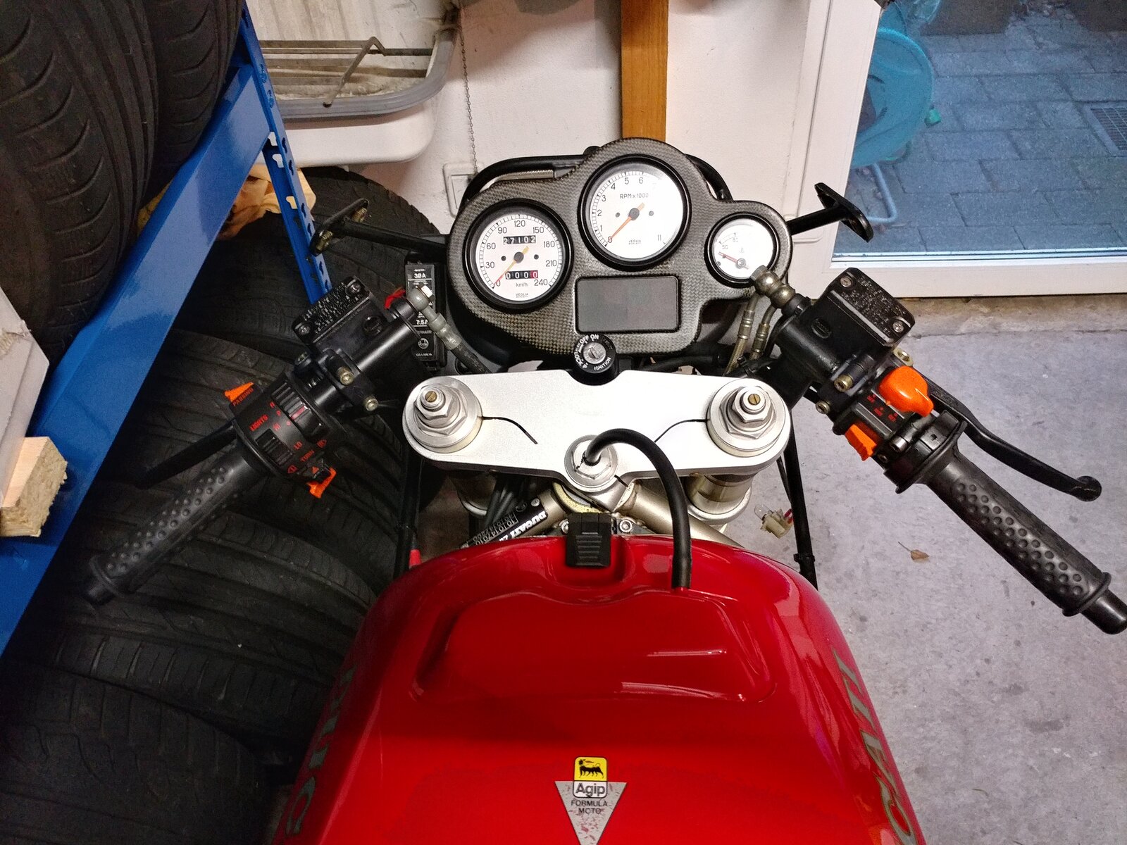

    Wiring along the frame done, all connectors cleaned and new shrink-wrap where necessary. There is oil visible on the exhaust header, it's from the oil-temperature sensor which I didn't tighten up to spec until then.
    Shiny copper-nut. Saw new ones for the first time when I bought them, they are a bit oval.

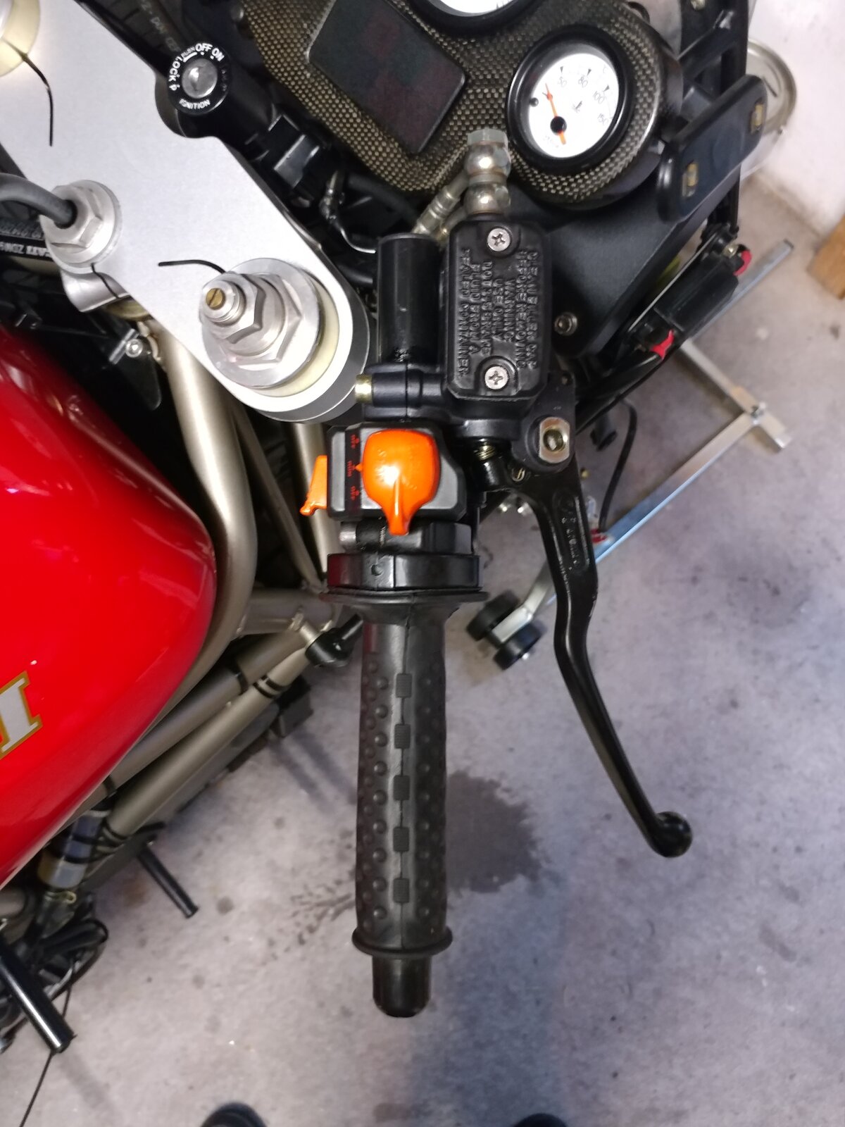

    Set the angle of the grips to something that might be comfy, will have to test while driving.
    The position of the fuel filter on the frame was setup by the previous owner. As the fuel lines are relatively new and have no cracks I'll leave it as-is for now.

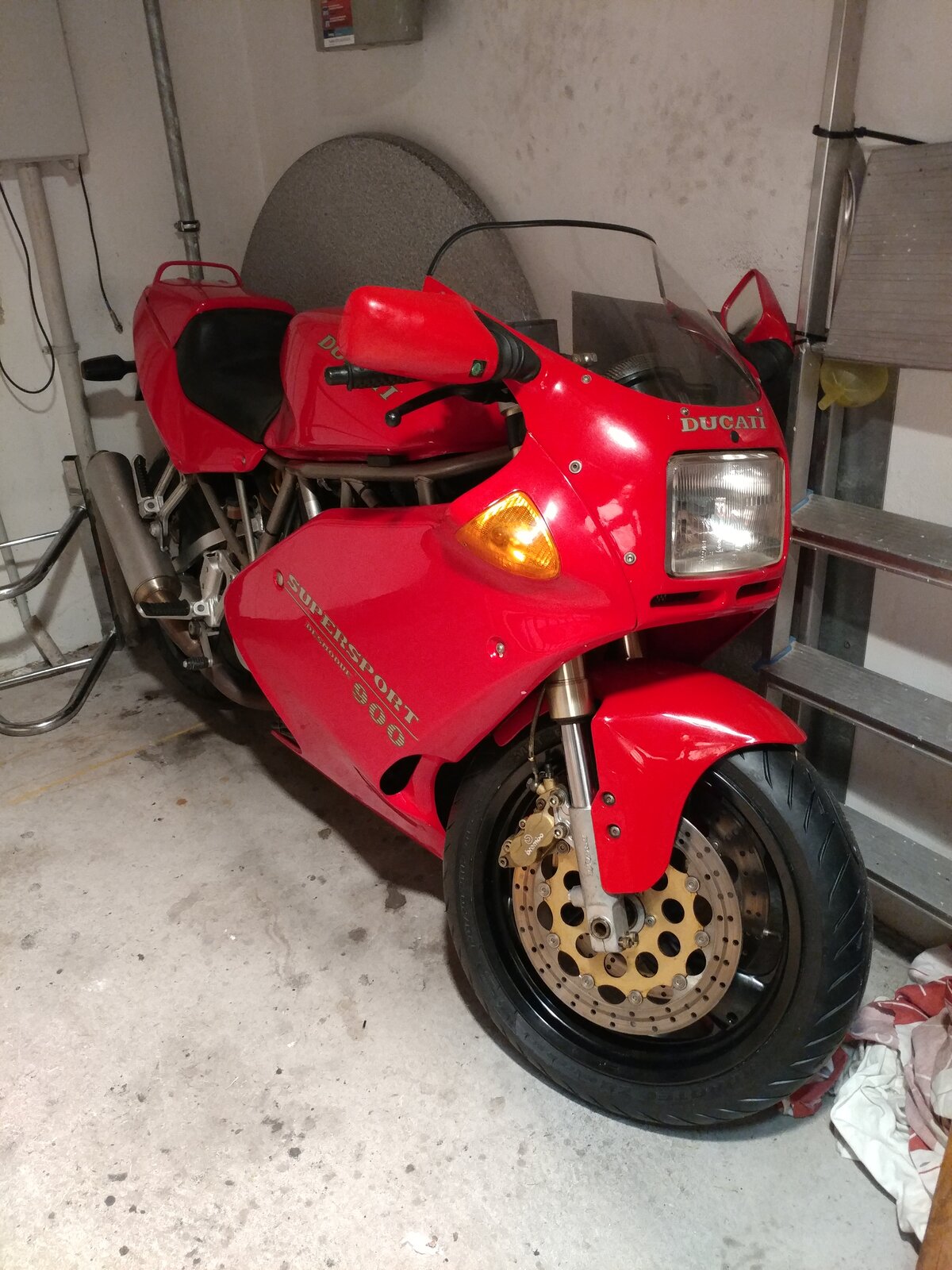

    The front exhaust has a little leak and, as you can see, the gap between the head and the flange is smaller than the other one.
    My idea of this "project" is to make it reliable first and pretty later on, so I only replaced what was necessary and did a proper service, cleaned (up) all the wiring and connectors. It's from 1994 and it can have a bit of wear (until it will be powdercoated, refinished and put into the living room in a few years later on :eyes: ).
    It starts right up now after three twists of the throttle and runs very smooth. Oh the magic of clean carbs, 102 octane fuel and new plugs. :D

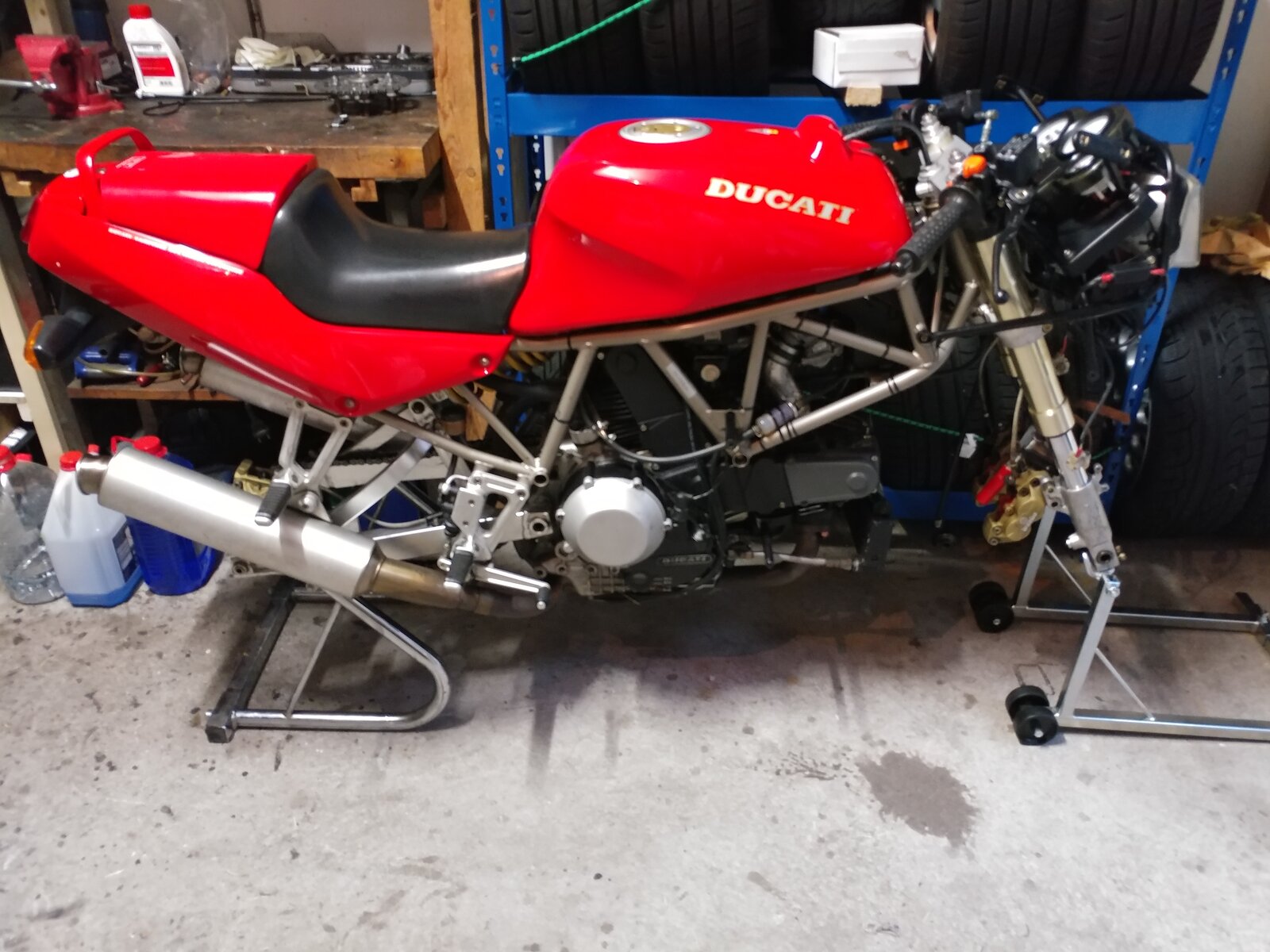

    Wheels are off to get new rubber, will be going back on Wednesday.
    Looking much better then before.
    New rubber hoses on carb and tank.

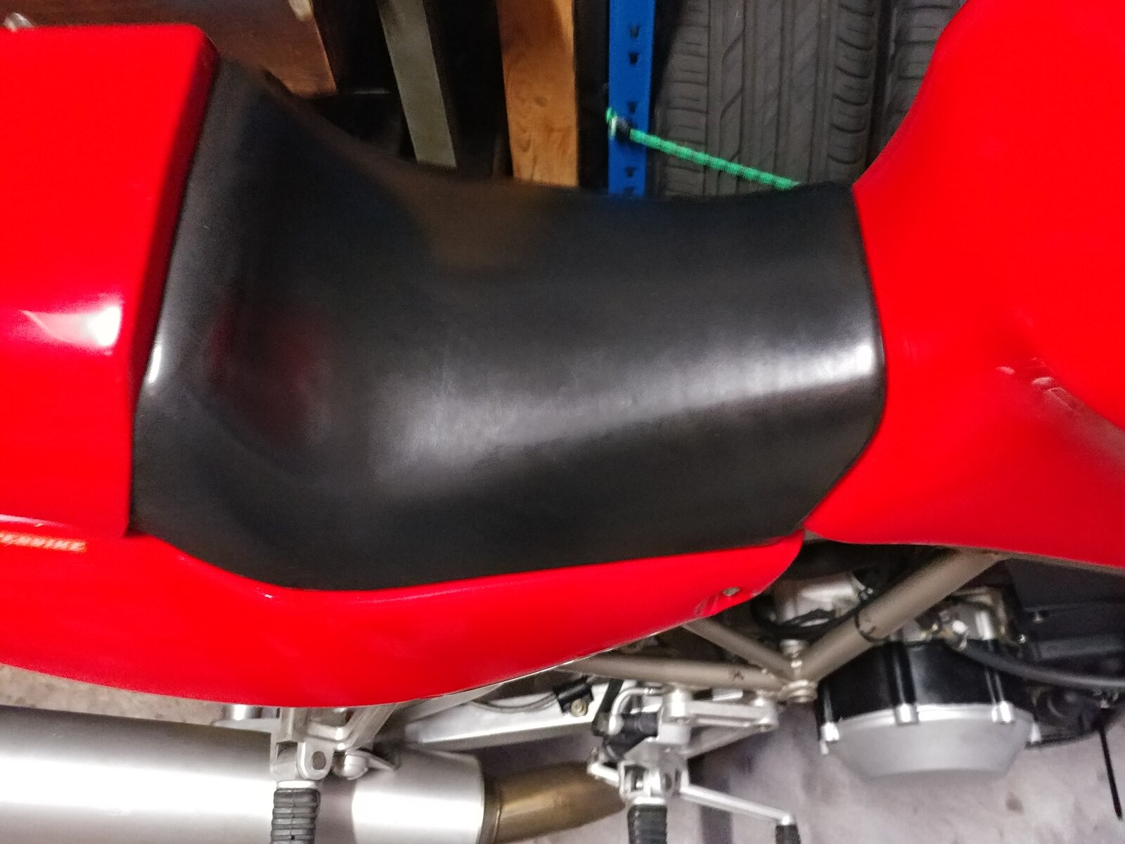

    Seat looks good, material is still squishy, no cracks.

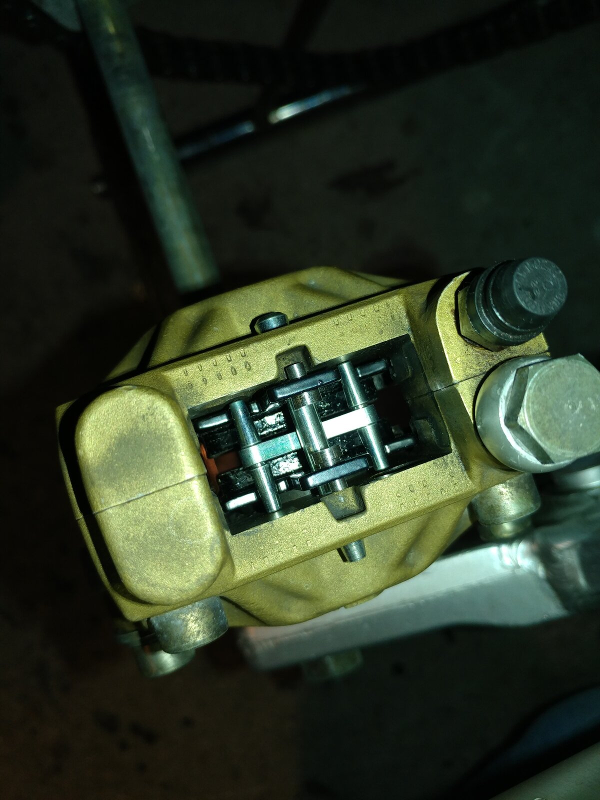

    The pin on the rear brake is a bit strange: it has a bit of play, about half a millimetre. The shop I bought it from says it's the correct one for my bike.

  10. Sorry to say this but to me, that rear brake doesn't look quite right.......and has the pin got a groove for a circlip? It should have, although I didn't just trust that and I drilled a hole for a small R-clip as well.

    I thought the same thing, as the pin also has some play in it, it's probably the wrong one. It has a groove with a springy-type thing that keeps it in position, but no groove for a circlip. I will replace this part.
    The previous owner had replaced the original with a "rolled" pin, so had no idea what the original looks like and I probably ordered the wrong one..

  12. Those anti - rattle springy things don't look anything like my OEM/stock rear brake stuff.

  16. Could you post a picture of your rear brake so I can get an idea of what the original parts look like?
    These are the parts that I bought:
    https://www.stein-dinse.biz/product_info.php?products_id=38
  17. Sorry, I sold my 750 about two years ago.......maybe the OEM part was uprated, but it looks odd to me, because your brake pads appear to have been changed as well to accommodate the springy things.
    Still, if it works OK, forget I mentioned it.
    AL
  18. If you can wait till the weekend I can see if I get a decent picture of the rear caliper on my SS
  19. The correct part for your rear caliper (which is the same across the 750SS - 900SS/SL carbed models) is:
    612.4.013.1A . That includes the anti-rattle spring thing and the retaining pin (and I assume the pin circlip).
    I just checked in my parts manual and the steine-dinse website for confirmation.
    It looks to me as though the parts you have may be for an Aprilia (which might have the same brake caliper - I don't know) but they are probably OK (if you can retain the pin to stop it coming out).
