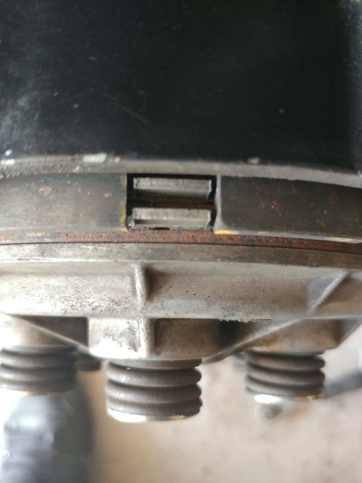

    Never looked at the clutch plates until now, I think they might need replacing. Perhaps the squeaking will be gone with new plates as well. :kissing:

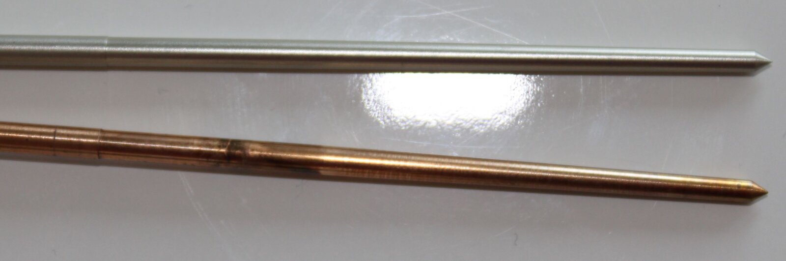

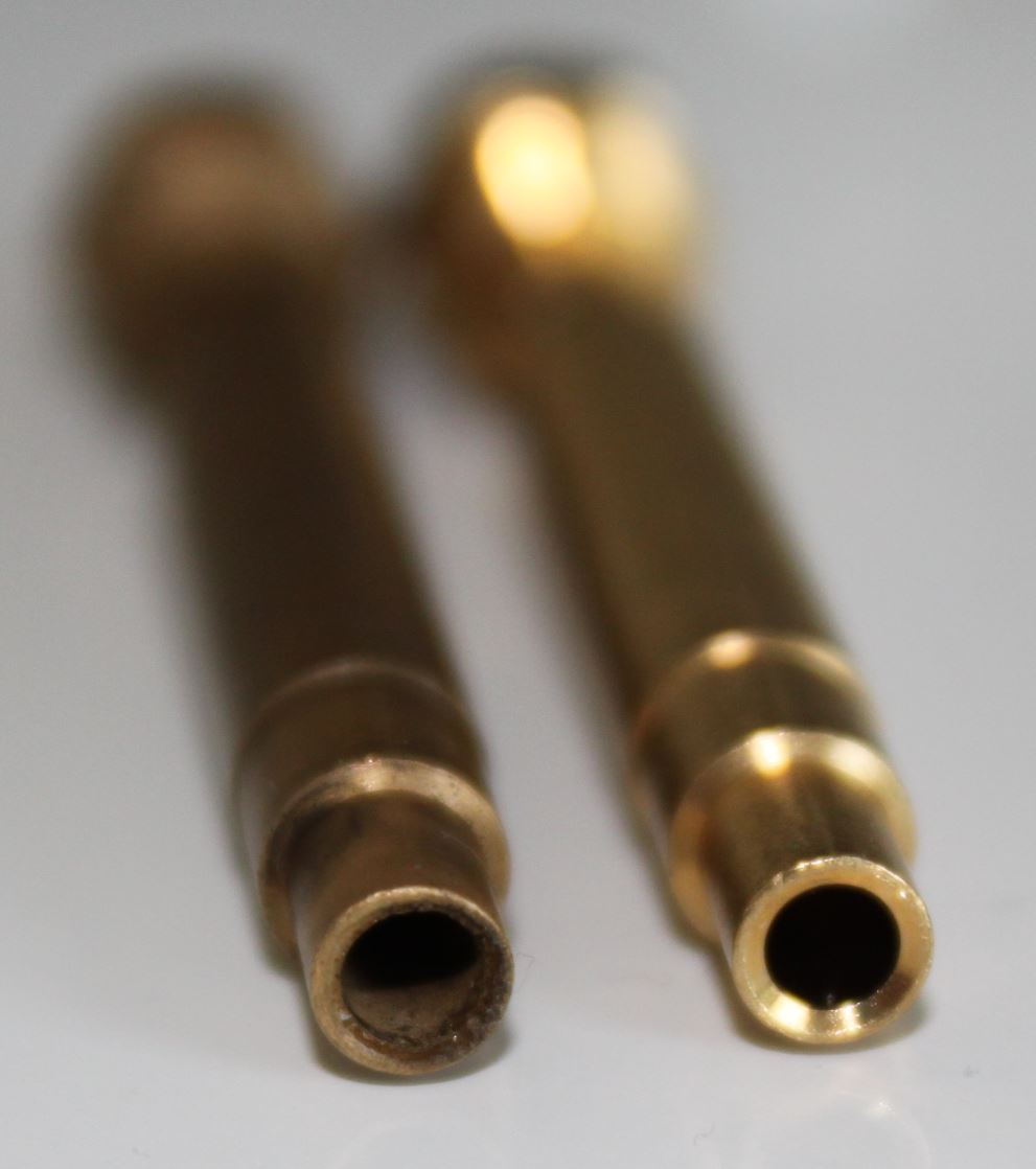

  20. Someone on here gave me the advice to change a few probably worn parts on the FCR and BOY THAT WAS SOME GOOD ADVICE.
    Parts came in today and after size / fitment comparison I took a look at the wear on the old parts.
    The needles have tiny marks from rattling inside the needle jets.
    The bore on the needle jets is pitted and probably wider then it should be.
    (At least they aren't oval like in my old FZR)
    Also ordered the main and an air jet.
    Should be running a bit less rich now. :kissing:
    So I'll be busy on the weekend with a bit of cleaning and putting the puzzle back together.
