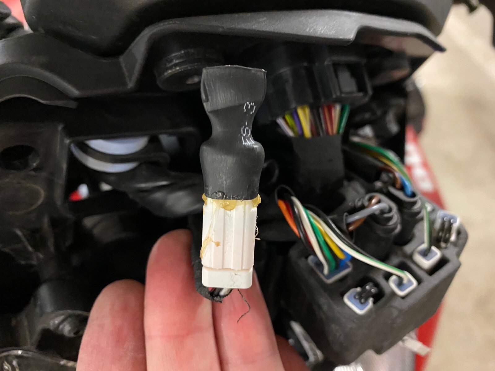

  2. Thanks, but still can't figure where I should look. My ride is Hypermotard 950 and already removed front parts, found electrics, but nothing where I could connect module.
  3. Thanks. I found one short circuited wire and connector behind the front panel. It's not marked like other wires are, but looks promising. Though I won't take risk without reading wiring diagram.
