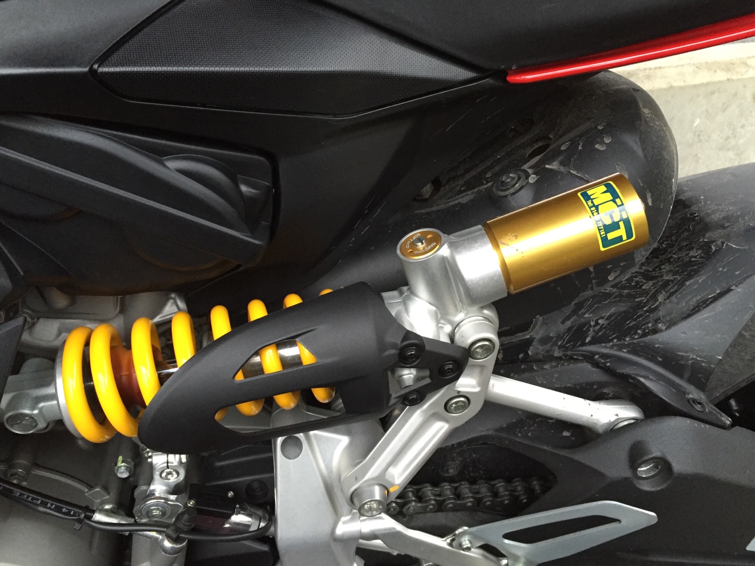

  18. [​IMG]
    The sticker has to be worth £200 ;-)
