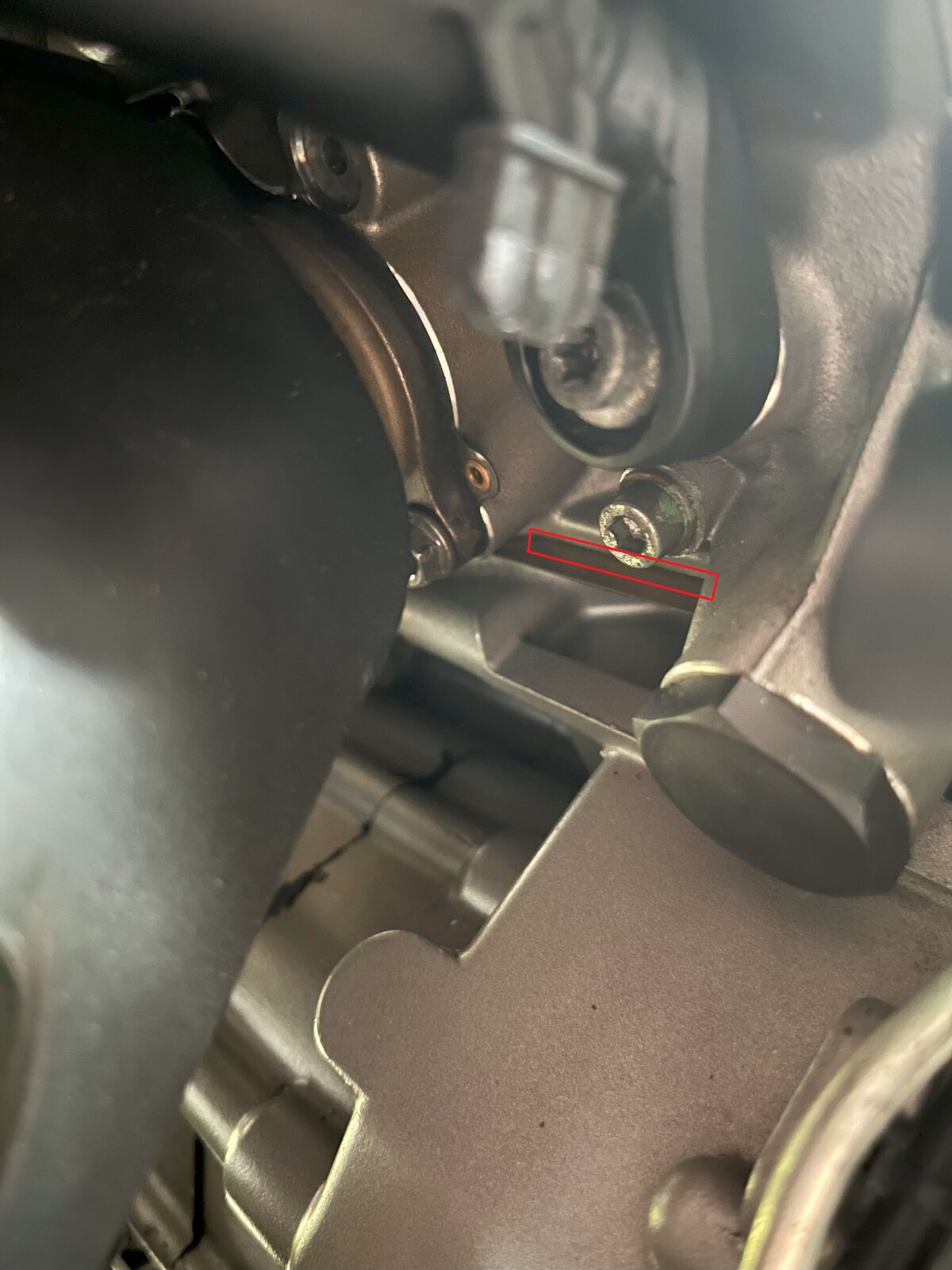

    I've been doing some work on my 959 to try resolve all the oil leaks. Whilst doing this I've noticed that the vertical head has tiny bubbles coming from between the head and head gasket. The image below shows where this is (to the right of the exhaust port when looking from the rear).

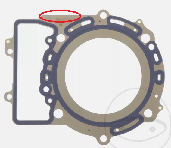

    The image below shows where these would be on the gasket.

    It doesn't seem to be leaking any fluid from here. The bike runs fine. No over heating. No mixing of fluids.
    1. Is this early head gasket failure?
    2. Has anyone seen this before?
    3. Should I get it sorted now or leave it? (I'm probably kidding myself here)
    4. Has anyone on here done a head gasket on a superquadro? If so, how bad a job is it?

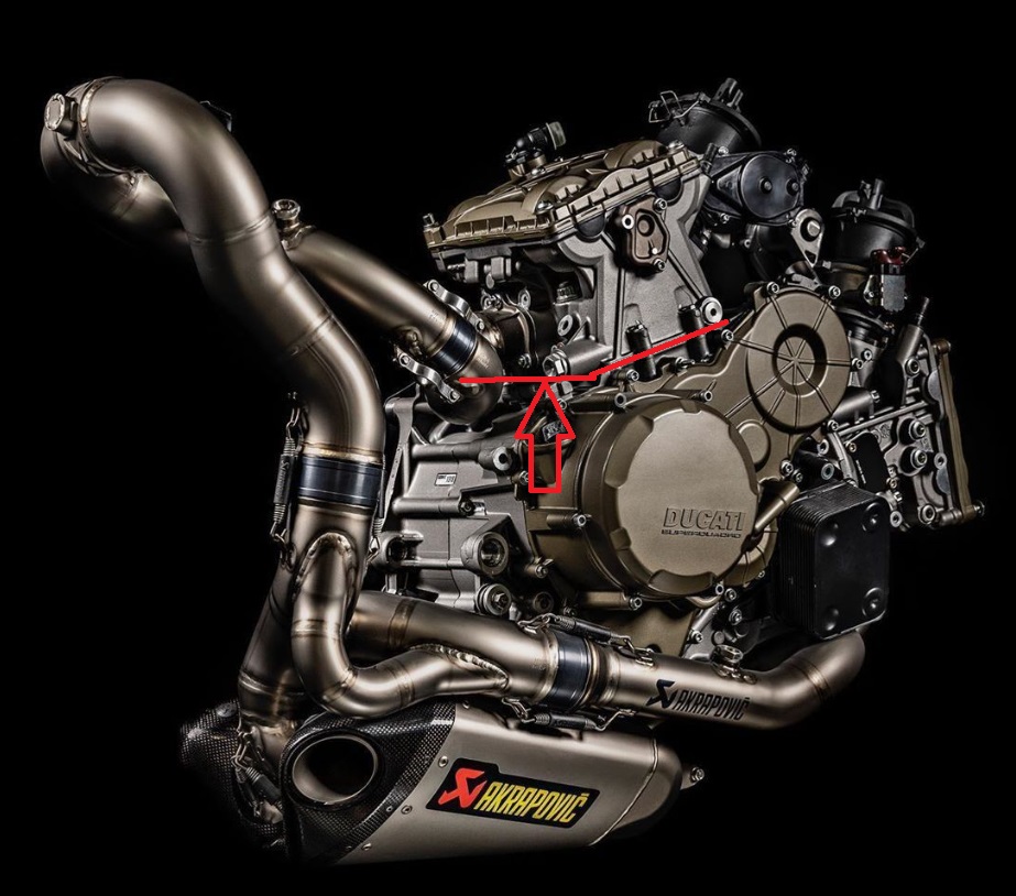

    The red line on the following image shows where the gasket is located. The arrow is the rough location of where I can see the bubbles. Is this the same location you're seeing them? How many miles have you done since you noticed it bubbling?
  4. Yes thats where they are coming from on mine. Tiny bubbles almost like a slow fizzing and only when it’s hot? My bikes on about 37,000 miles! So I’ve probably done 8000 ish since I noticed it I don’t even worry about now.
