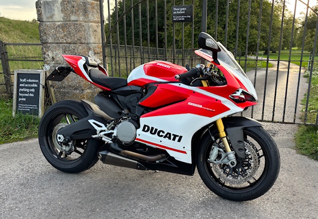

  12. IMG_6438.jpeg The 899 is a little ‘lighter’ than the 959, and tbh I was someone who used to say I preferred it, having owned 2. However I’ve recently been exactly in the same position as you and bought a 959 corse.
    the RS660 is fantastic, absolutely fantastic and I still want one, but the 959 is more complete, better built and more scope for growing into the bike as such.
    Speaking of the 959, reliability is absolutely fine, the only weakness with all these bikes 89/1199/959/1299 is the water pump, I know quite a few have had to replace them including me on both my 899’s. Don’t let that put you off but just look for coolant drips on the left side of the bike down the crank case when you stop the bike from hot.
    remember also the desmo service is a big one but it’s not age related it’s miles, so my 899 for example had 11,500 miles on and I was getting nervous for resale value, but if you pick up a low mileage 959 and aren’t commuting as such you’ll be at standard yearly servicing which is oils and filters, at a good independent that’s not the end of the world
    im used to my 959 now and although mine has Akrapovic’s, the midrange is great and deffo a step up from the 899, the clutch is way lighter, the fairing is bigger and more comfortable to be sat behind, and it has a slipper clutch. It would be my pick.
    here’s mine! And a pic of the RS660 I tested which was beautiful as well but as you say for similar money the 959 wins.
