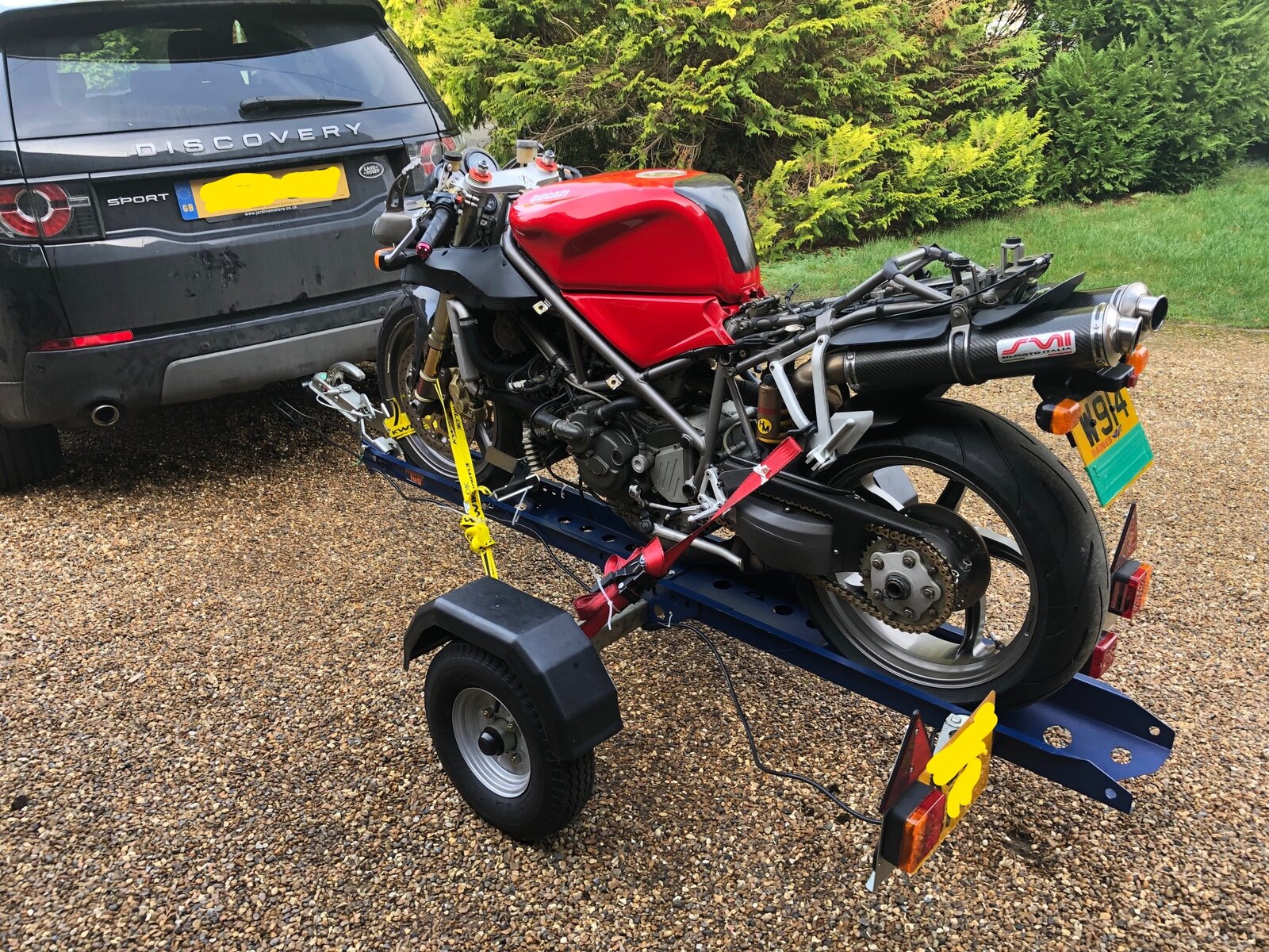

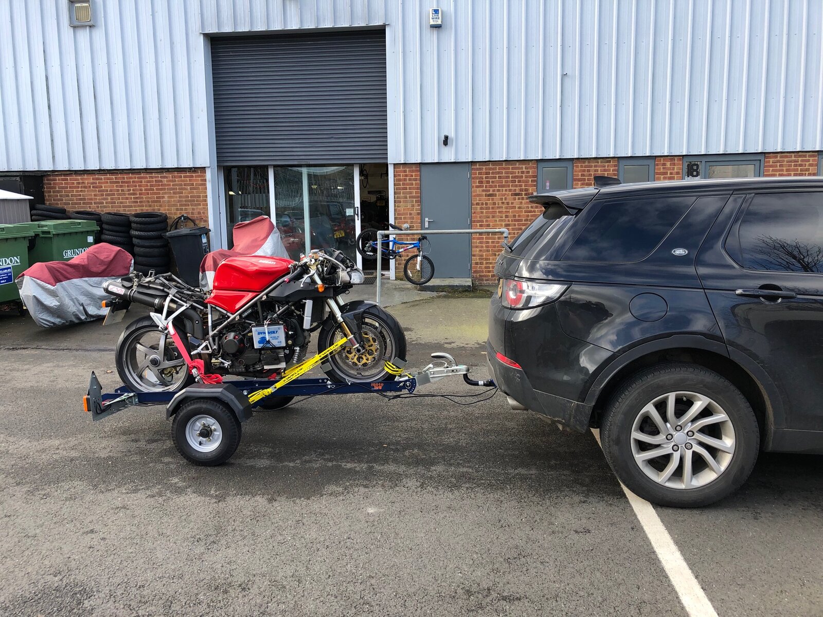

  4. BIke stripped off and onto the trailer to take to Baines. I had the paperwork file of what had been done to it as any information would help Geoff with his work. I was shitting myself that i had bought a heap of trouble. Mind defaulting to Mains gone, starter and sprag to do etc. I discussed this with Geoff and had a plan B if it was going to be a money pit (I would have terminated the project and possibly broken it or done a deal on something else, taking a small loss probably).

  5. That’s a neat little bike trailer, what make is it?
  6. Its a Motolug SE. Dismantles and goes in the boot. It can carry one or two bikes. I got it off a forum member. Tows well.
  7. Made in the UK, Morton in the Marsh, very useful, thanks :upyeah:

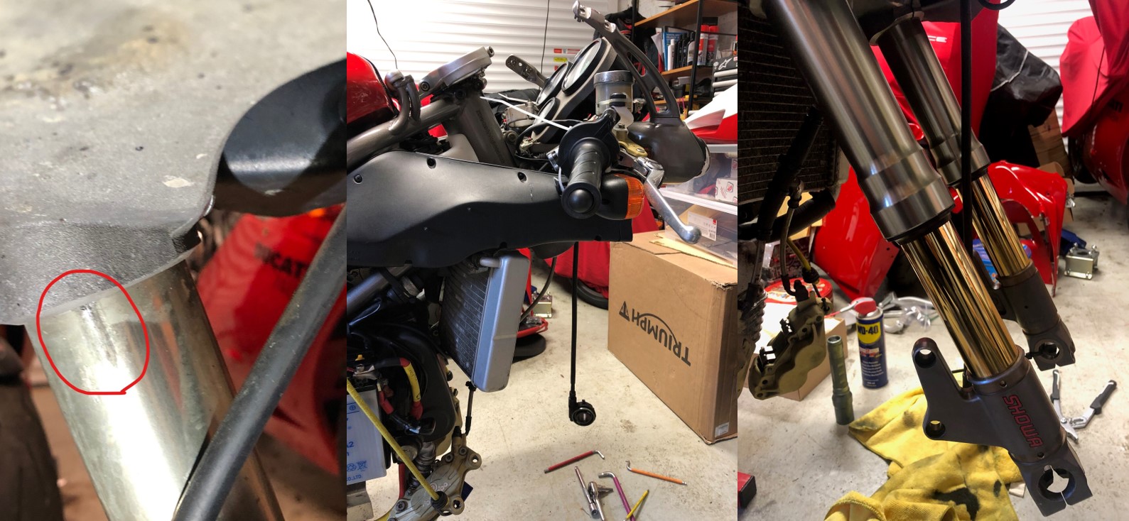

    Next job, now that we know its not a money pit was to sort the clunky forks. I am only 7 miles from a suspension specialist (Ohlins/Nitron/Ktech etc), so off with the forks and dropped them off. As previously mentioned, I had a spare set and the idea was to strip both down and make one really good set for this bike and spring to my weight. Fill up with Ohlins oil (being closest to the std 7.5 wt oil available).
    Here's the before, during and after pics:

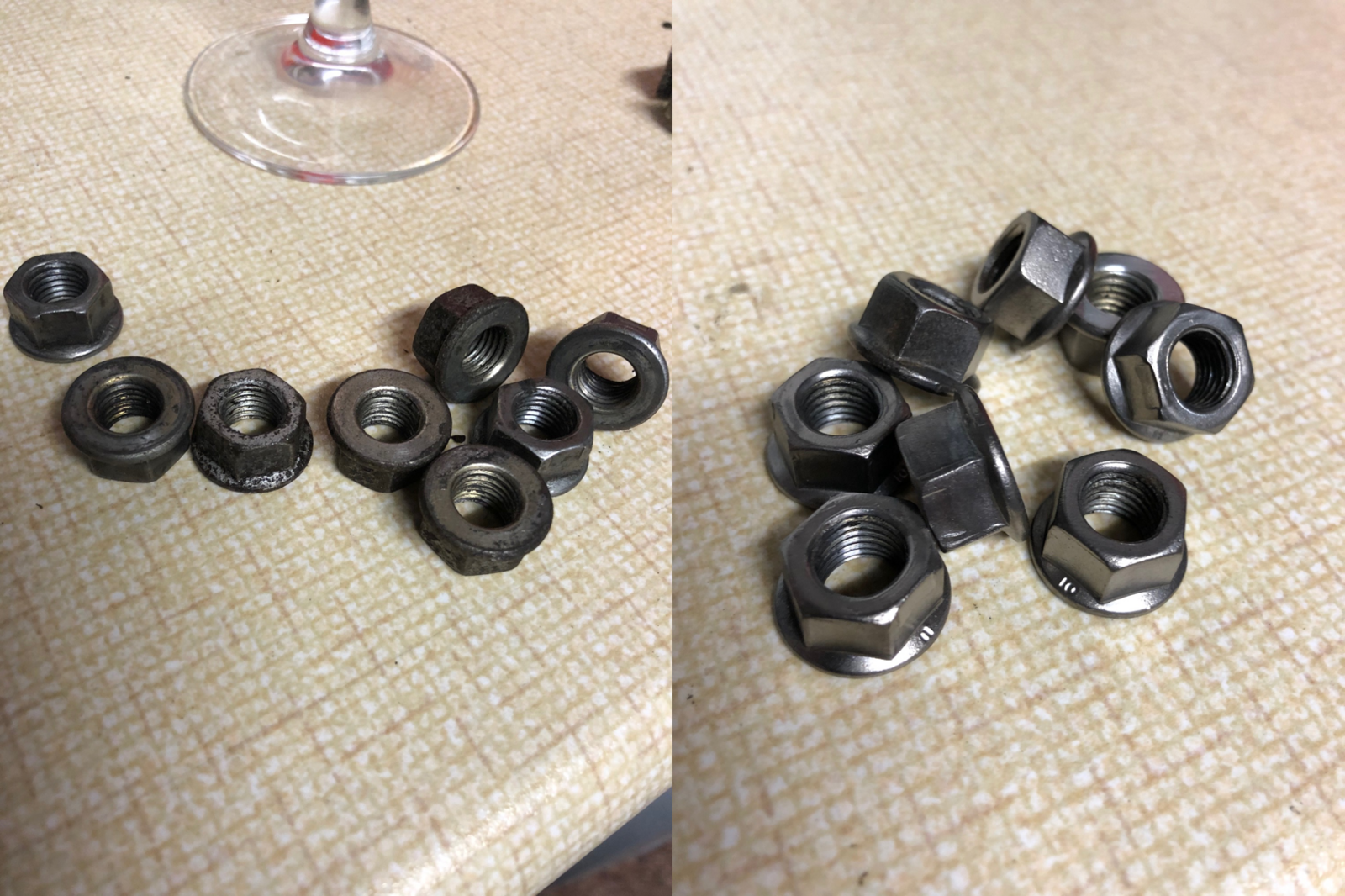

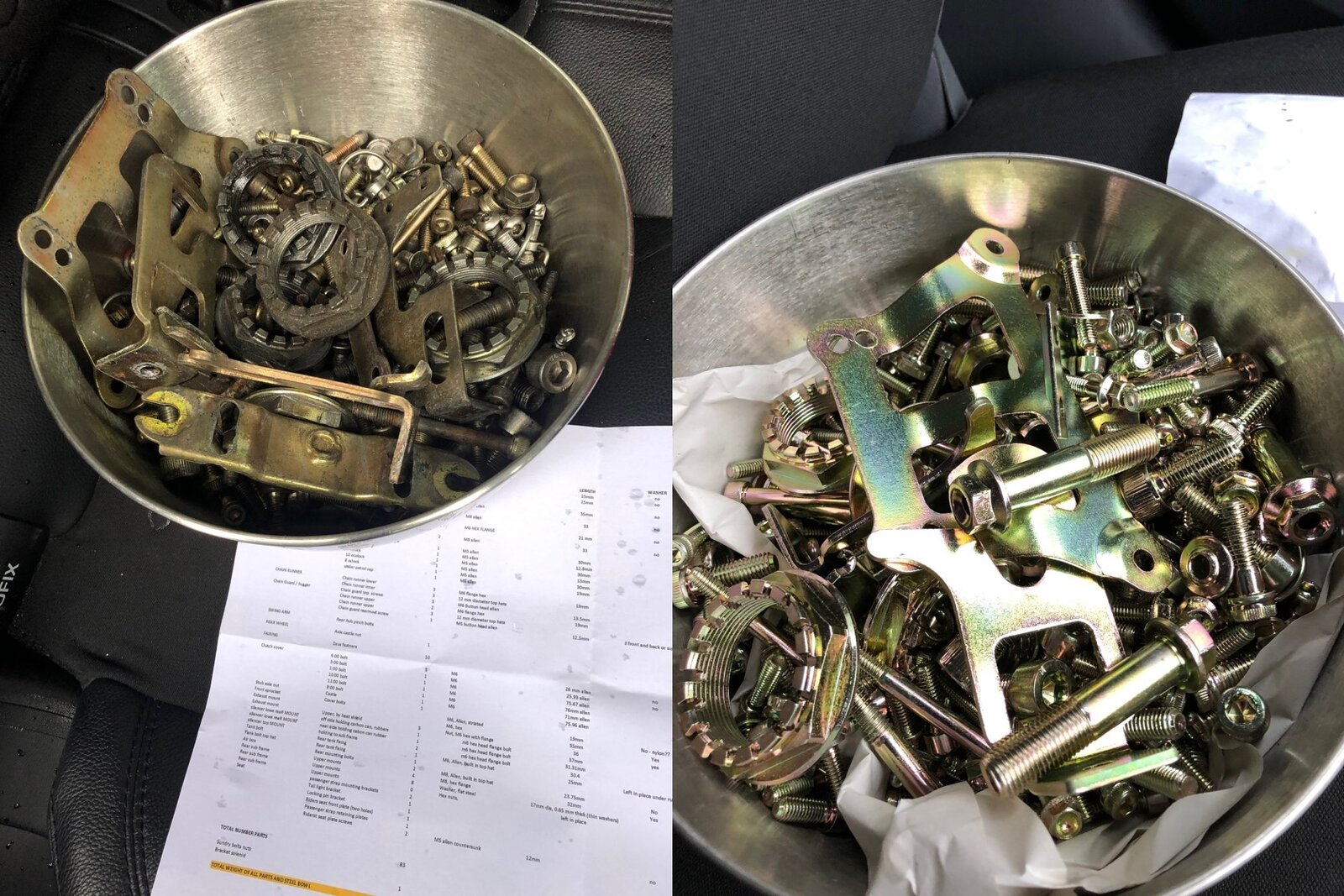

    Whilst removing the nasty cheap bolts that came with the bike, plus the remaining originals, I only had one difficult bolt to remove. That had to eventually be drilled out. The bolts all went off to my local zinc platers (I did a job lot as have amassed a fair number of OE fixings over time) ready to bling it up.
    Those that did not go got the benefit of a polish at home:

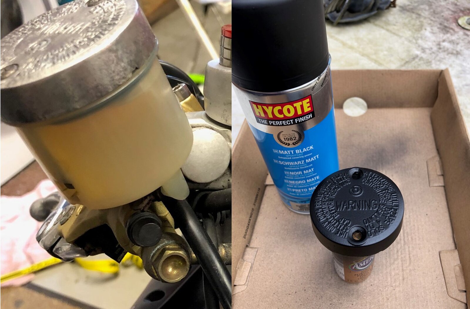

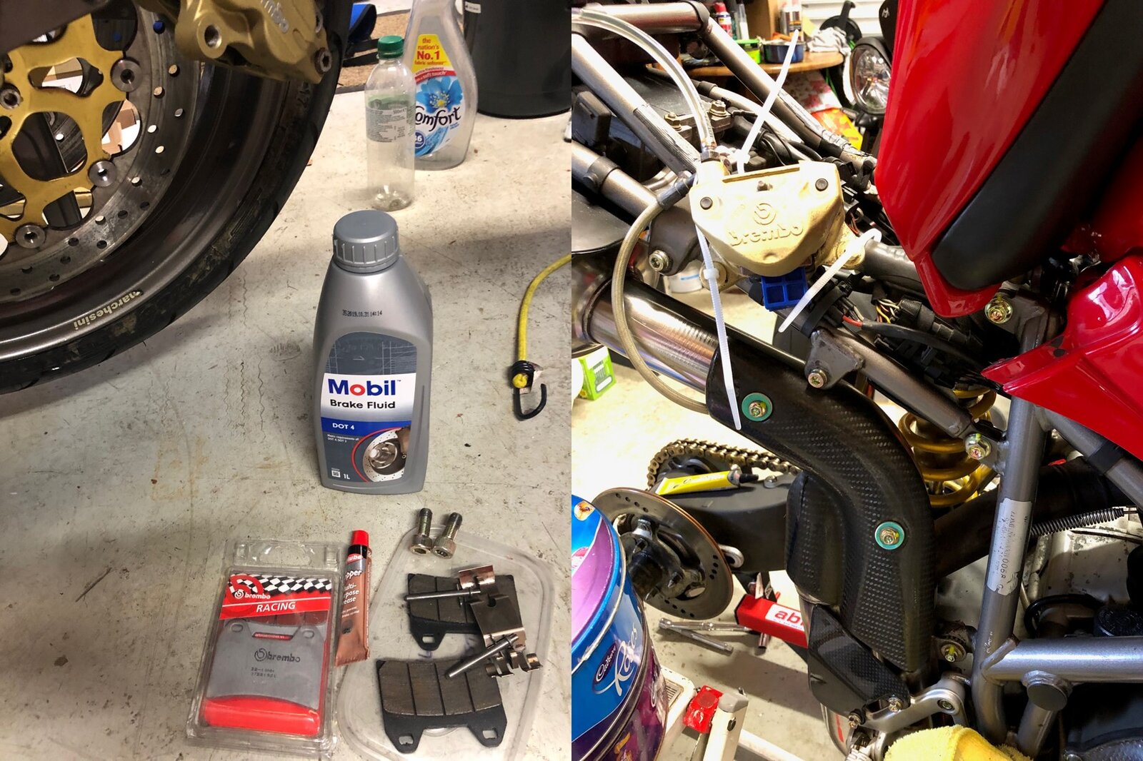

    I also set about sorting the brakes. New Brembo SC's went in, plus fresh fluid all round including the clutch. I was staggered at the amount of air that came out of the front especially. Both front and rear brake levers now are good and firm.
    The brake reservoir cap was put back to how it was meant to be.

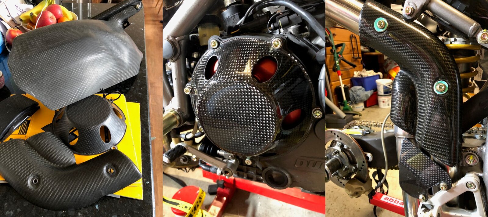

    The carbon fibre was taken off and rubbed down (400, 800, 1200 grit). Then lacquered in a very special spray booth (dont ask). Then wet and dry 1200, 2000, 2500. Then cut back, polished and waxed. Items were exhaust heat shield, clutch cover, tank pad, hugger (more later).

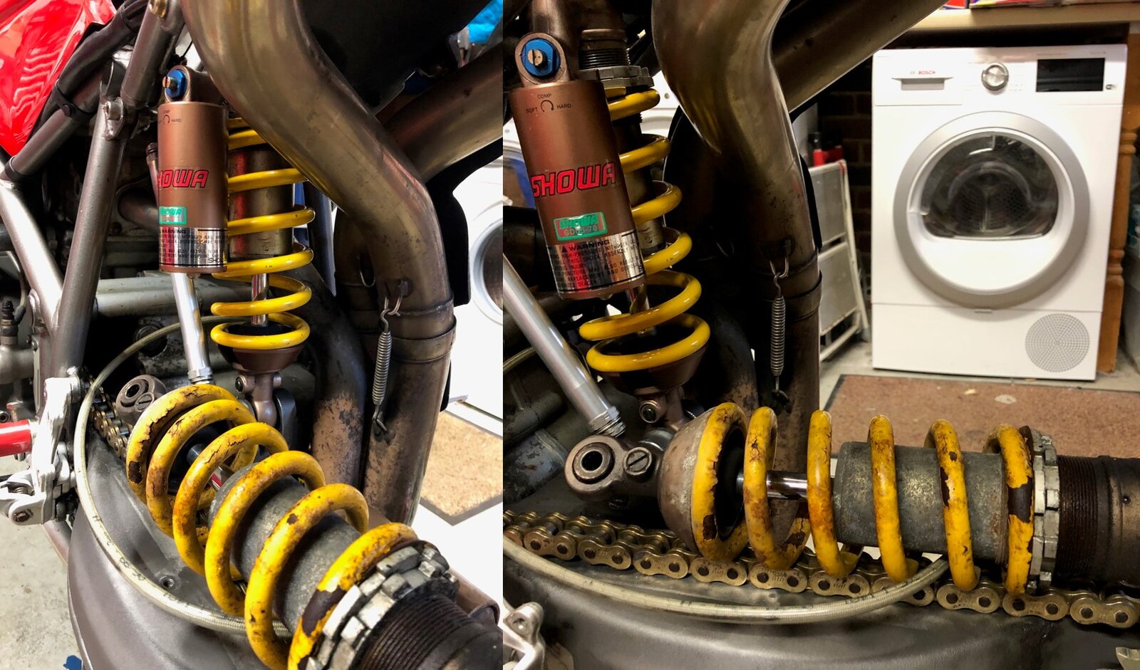

  13. Forgot to show the shock which I think I might upgrade to a Nitron when times are better. But, its a lot better than it was for a bargain price too:
