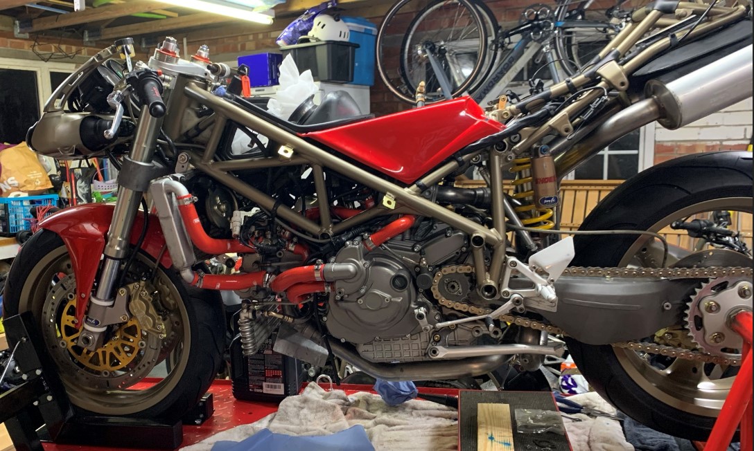

  4. plumbed up the coolant and unfortunately it had more leaks than a Welsh market stall, do i need anymore justification to order a rather fetching set of red Samco hoses, no i ffing dont...
    oil and airbox now finished, only set back is when i emptied the coolant after trying the old hoses a shed load of crap came out so erring on the side of caution i've ordered more which i'm waiting for to arrive,
    throttle body in but for some reason, i'm not sure why so if anyone has any ideas they would be gratefully received, the throttle isnt snapping back, more a slowish return. i've tried all sorts of adjustements to the cable at both ends but no joy,
    brakes and clutch bled and ready, rear was a bitch, especially when i started to lose my patience and forgot to fill the reservoir taking in a load of air so having to start all over again, a fag and cup of tea sorted the patience which then in turn sorted the bleeding!
    exhaust on, and got bored due to the standstill from waiting for the coolant so sorted the fuel tank, new filter and good clean out of the pump etc. the tank has a ding which i'm not going to sort for a while, think i've spend enough so far, but i'll definately get it done before the end of the year. last thing done was to soak a rag in XCP and give it a good wipe all over, would hate to see any of the cleaned up parts go shitty again anytime soon :upyeah:
    once coolant has arrived (and a couple of the heatshield fixings) then it's new airfilters in and go for the start up! o_O

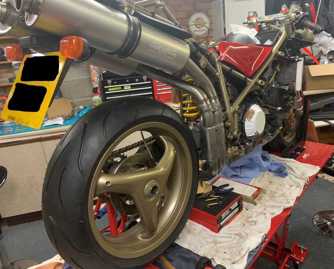

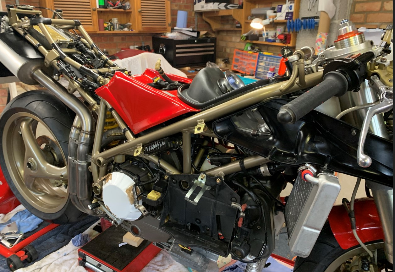

    plastic cover on the clutch cover is coming off last, the grand unveiling!

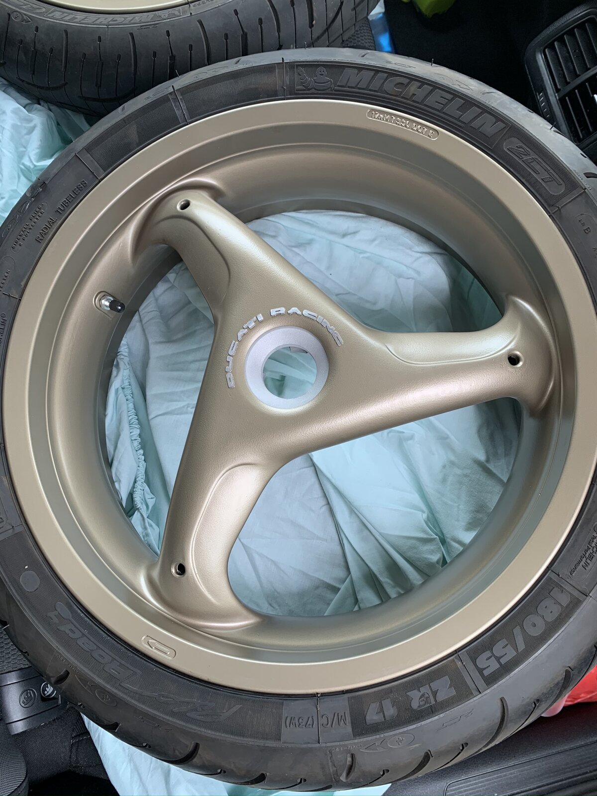

  18. Here’s a pic of the finish he put on the wheels of my 916, look lovely with the Ducati Racing text
