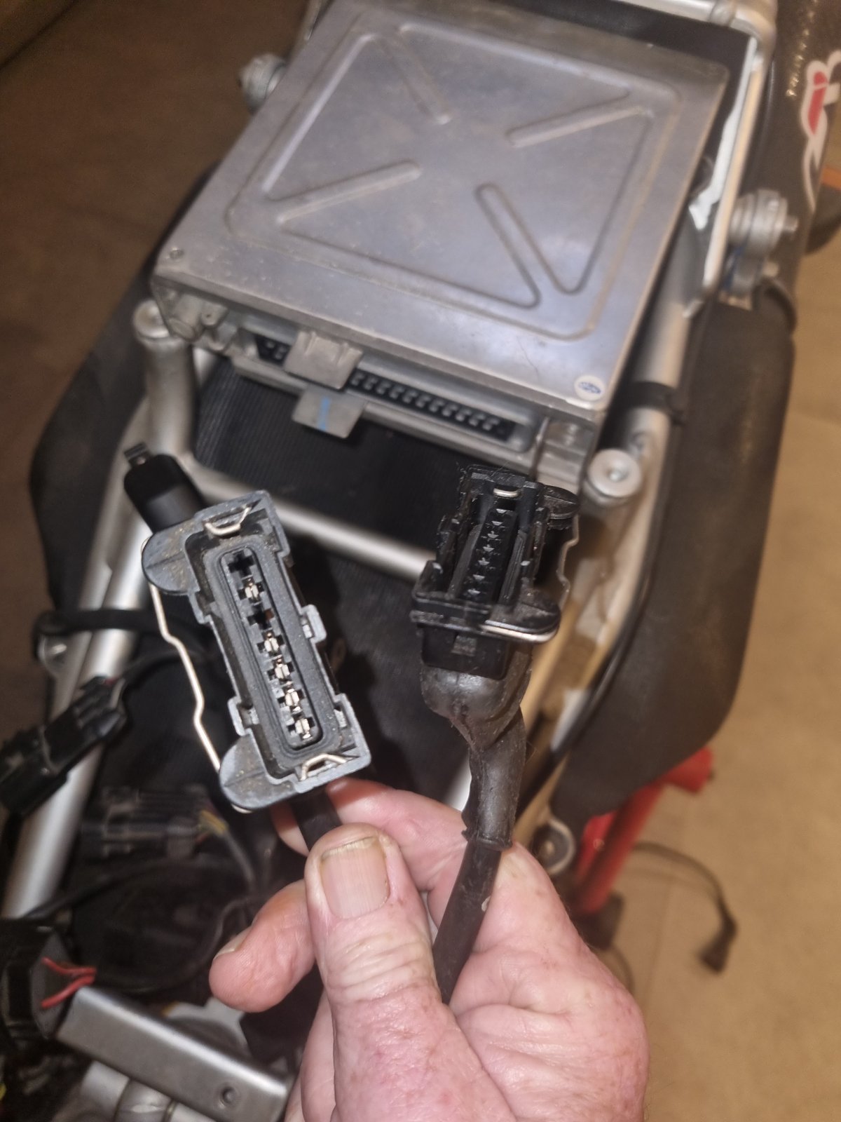

  9. Looks like i just need the amplifiers and associated mounting brackets.
  10. View attachment 349883

  14. Not sure whether this is any use but Bosch make single, dual and quad channel modules with the same plug. They look different to the Ducati ones but if mounted to a heat sink, may work. You would need to check that the wiring is the same. I can dig the pinout from my MoTeC drawings if you are interested.
  15. This may of no use whatsoever - please do some more homework, but those connectors for the amp look very much like what I used to run on an old race car, which also used Bosch (dual channel) amps....they were getting rare even 10-12 years ago, but I'm sure somebody then told me that they're also a (dont laugh) part used by Volvos, and I believe had an equivalncy p/n....obviously lots of cross-checking needed but it may give you a steer when searching.
    ETA - I just dug out a doc for the same modules I was planning on using on a later car project (which is when I probably heard they were getting hard to get). This is the PDF I found, which may help with cross-comparisons...I was using the Type A package, 2ch on race car, 3ch on the follow on project (hence yellow highlighting - ignore that)
