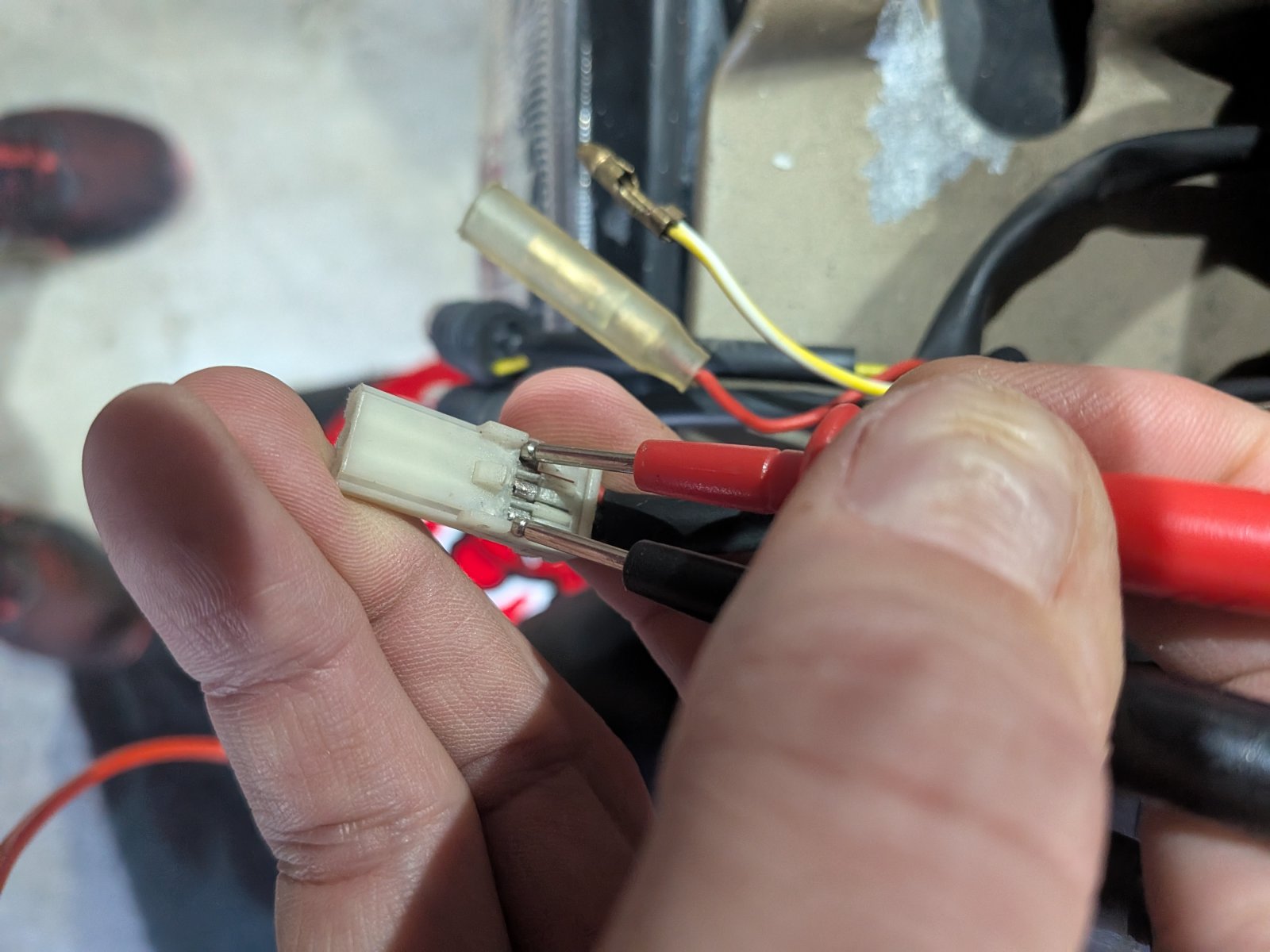

  1. Depends where the other end of the wire goes ?

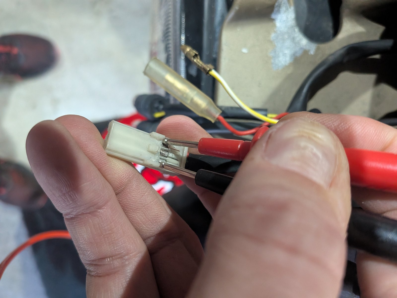

  2. Can you try this with your multimeter set to V
    1. Key ON (engine not running)
    Touch:
    • Black probe → tach connector ground wire
    • Red probe → battery negative
    Expected: 0.00–0.05 V
    If you read:
    • 0.1–0.5 V = poor ground
    • 0.5–2 V = VERY bad ground
    • 2 V = ground not connected at all
  3. Good test, thanks!
    I got a reading of 0.017, so within the expected measurement
  4. I was hoping you would get poor ground and above readings.
  5. Every time I go out there I hope to find something definitive that's wrong....other than it's not working.

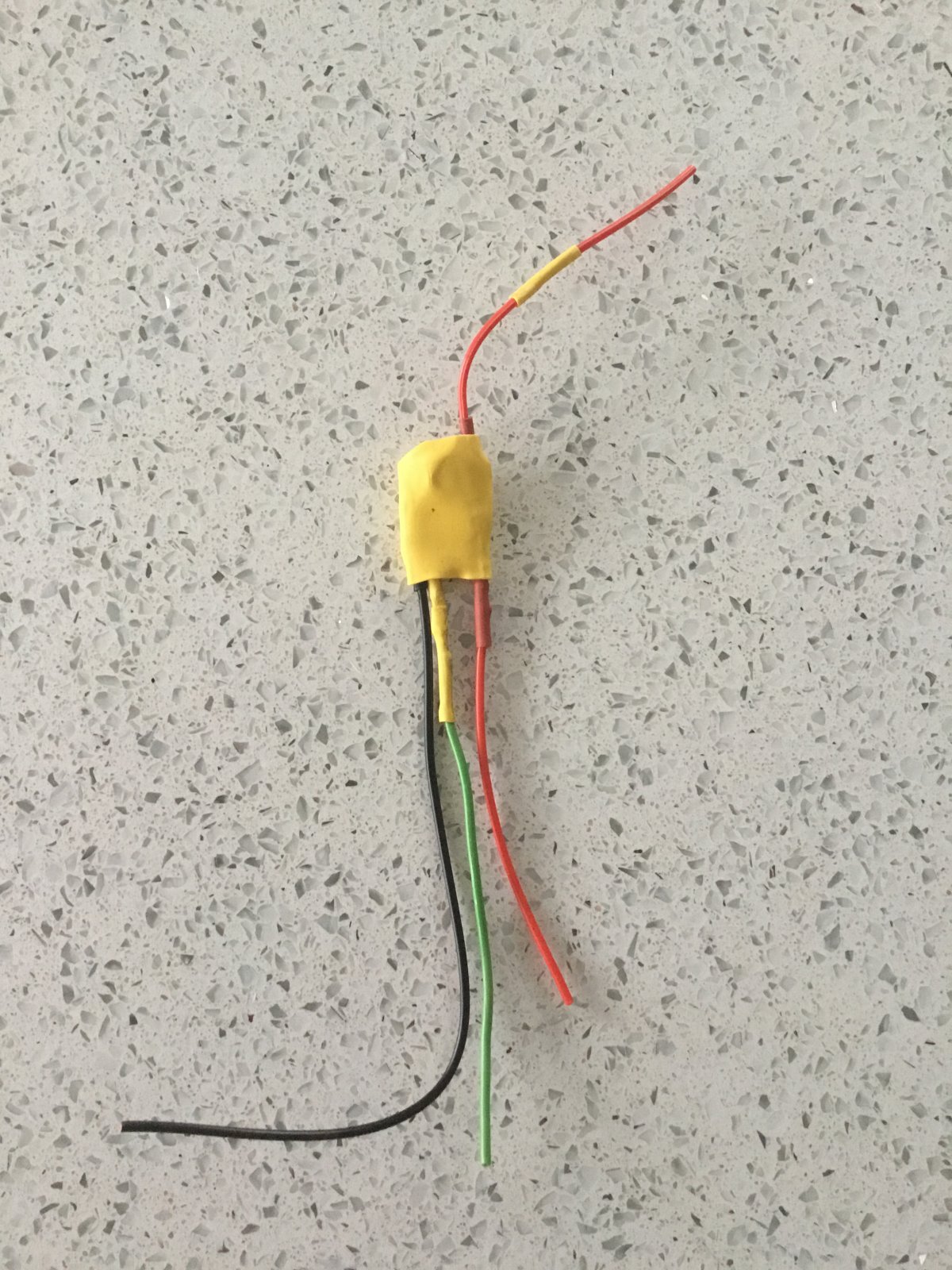

  11. I have built a prototype buffer device. It is built around a 2N7000 mosfet and two 1 resistors.
    The wire into pin 24 on the ECU will need cutting.
    Wiring
    Green wire to pin 24
    Red/yellow to the tacho
    Red wire to pin 35 for +12v
    Black wire to the earthing bolt on the ECU case (there should be an earth fly lead attached here)
    The idea is the tacho output wire is boosted to correct voltage on the square wave signal to the tacho.
