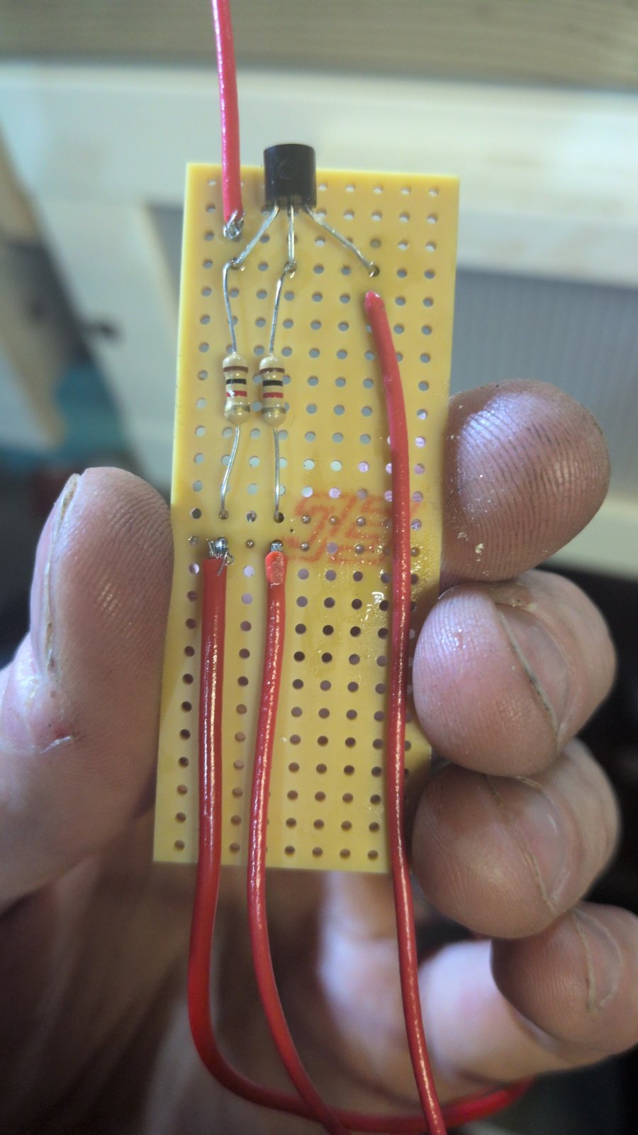

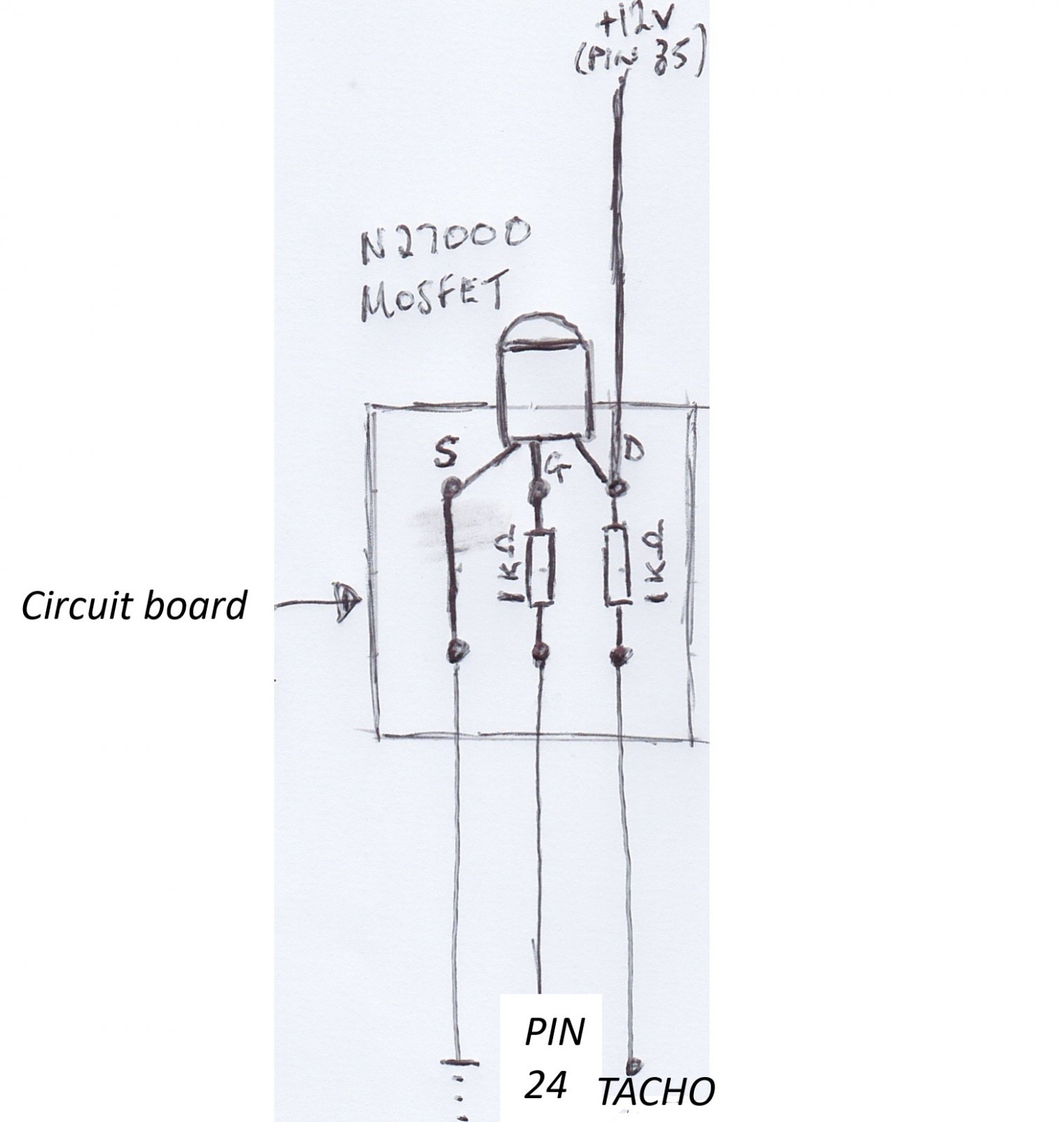

  4. @El Toro is there a way to extract this and make it a sticky in the technical section.
    The circuit was developed to address an issue on an IAW16 ECU but it may work on other ECUs that use a square wave on the Tachometer signal.
    The idea is that the square wave signal is boosted to 12v.
    Components needed
    1 x N27000 Mosfet
    2 x 1 KOhm resistor
    Copper backed circuit board to solder components onto
    4 x lengths of wire
    The only wire from the ecu that needs cutting is from Pin 24 on the ECU to the tacho

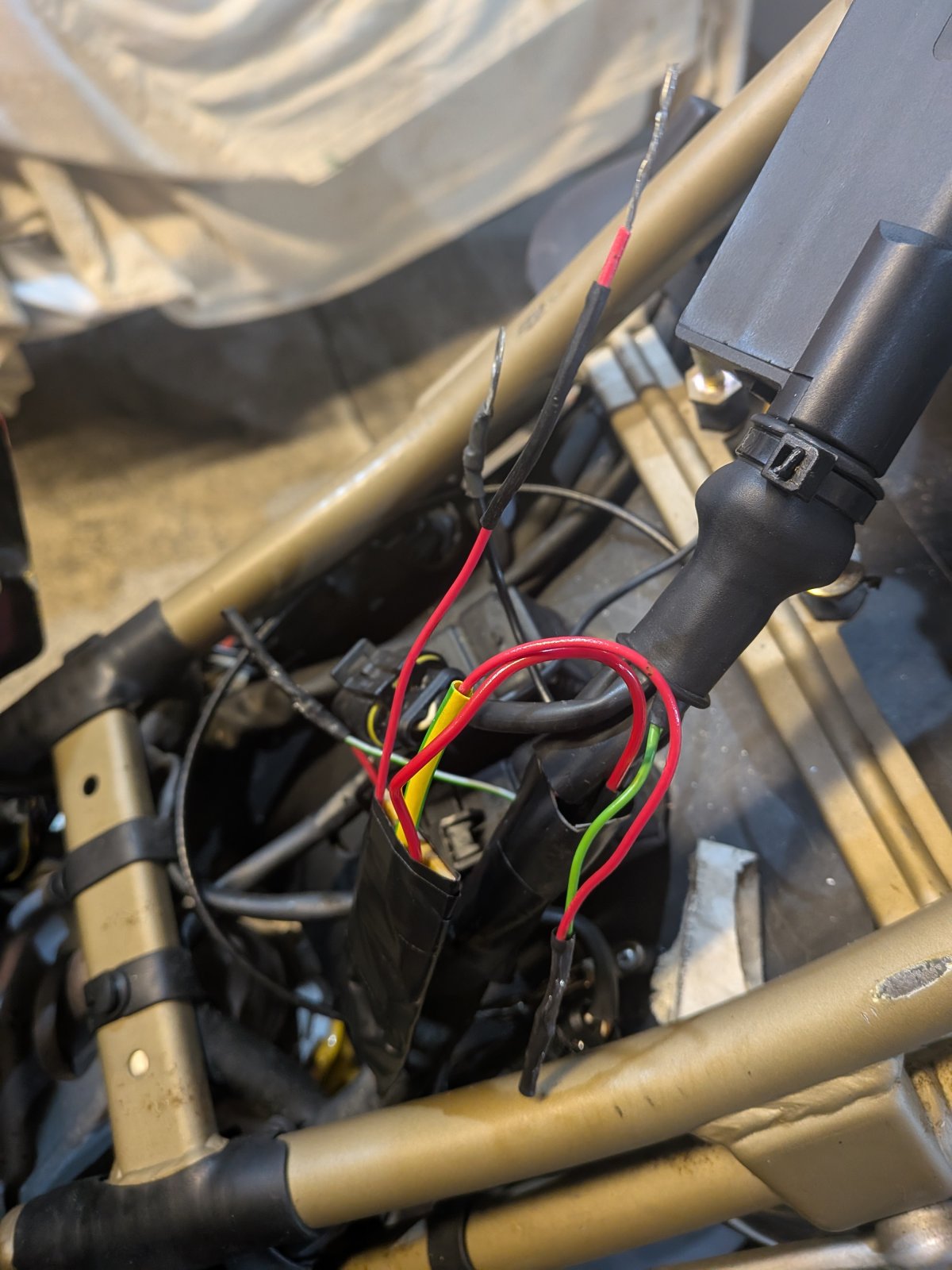

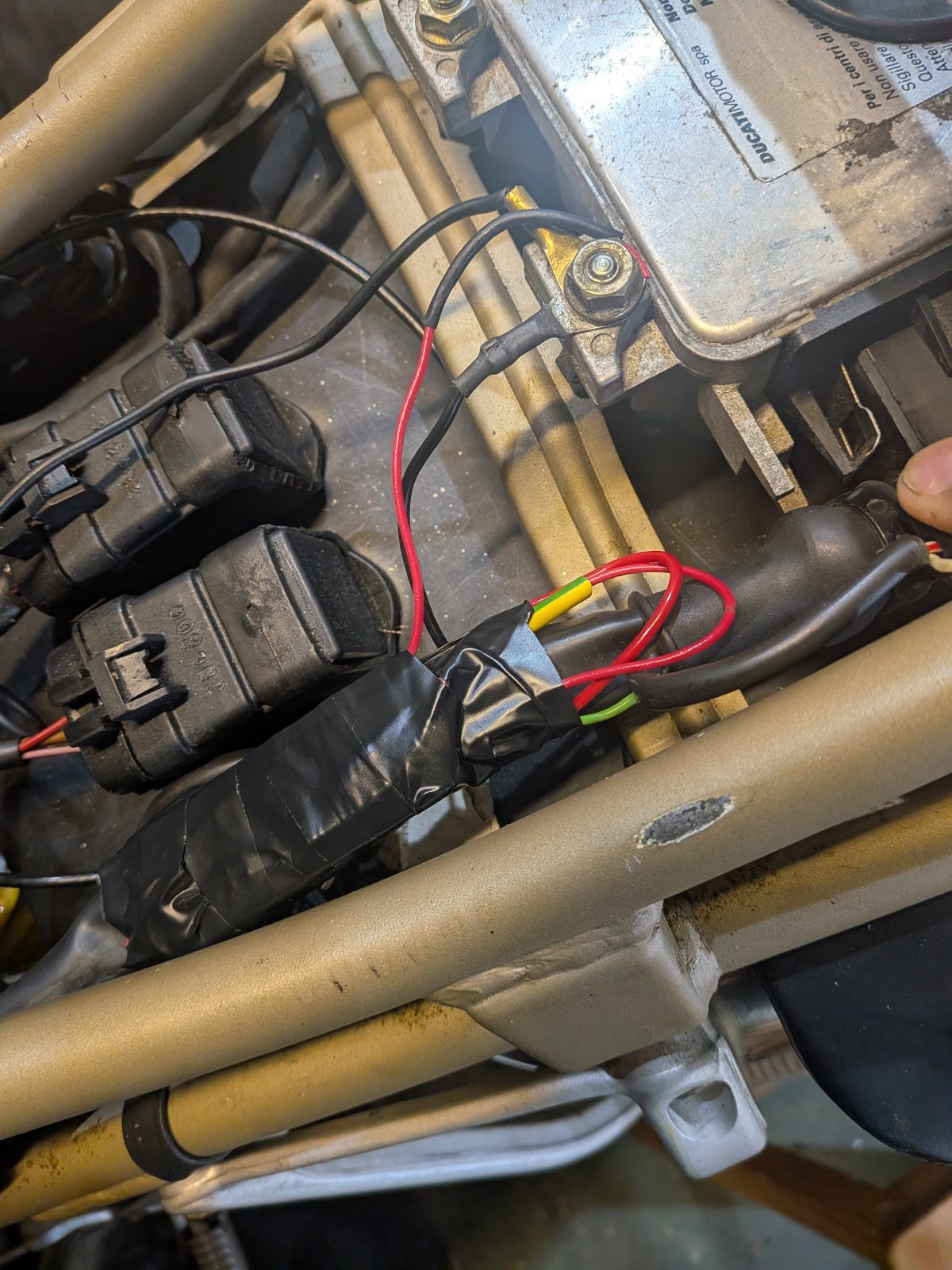

  13. Evening all
    I thought I would just finish up by showing the final result on the bike (see pics)
    Apologies to ChrisW in advance. He is going to notice that neither of his have made it onto the bike. This is purely because I'm a ham fisted moron and broke them both.
    So.....I bought the bits and made a third one exactly as he has described.
    To fix to the bike, I disconnected the ECU plug and stripped back the loom covering. I then cut the green/grey and the brown wires
    The gizmo was then soldered in, and then everything was bound up onto the loom so it's tidy (ish). The earth is the ECU fixing.
    Tacho is 100% working and we are away.
    Thank you once again to everyone on the forum, and absolute Kudos to ChrisW and his electronics knowledge!
