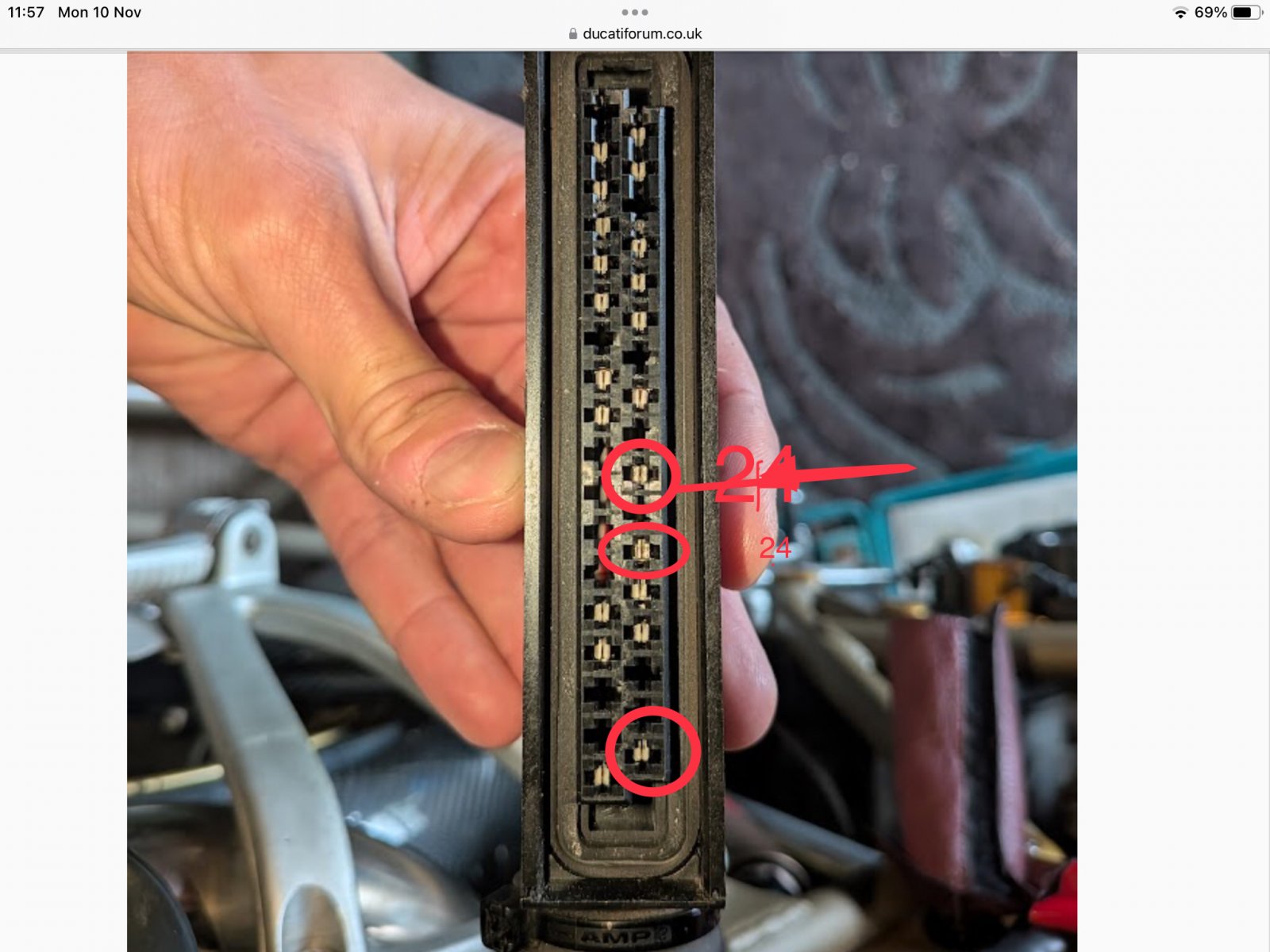

  1. Did you take the plug boot off? Terminals are numbered.
  2. and if you look with a strong light and maybe magnification, I think the numbers are moulded into the body?
  3. I replied but deleted as it was confusing things
    Ok, 100% the Tacho is coming from PIN 24 not 12
    I was counting them the wrong way
  4. Snip the cable ties get the boot off and look other side of plug.
  5. Ignore my picture. (Trying to do this on my iPad!!!!)
    The counting goes bottom left pin 1. Then down to bottom right for pin 19.

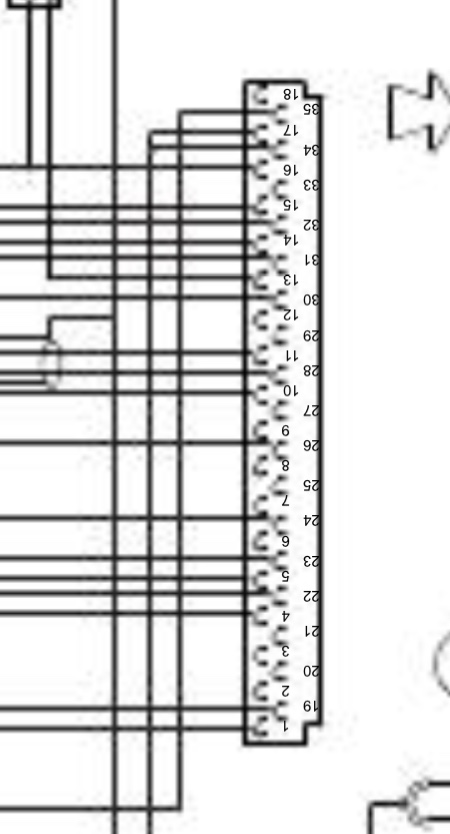

  9. I'll take it back what I said about wiring diagrams, sorry Haynes!

  11. While your waiting for parts, you can now test the circuits correctly, so you can prove it?
  12. Wiring diagram in .pdf
