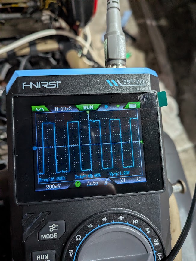

  1. Whilst I've got absolutely nowhere so far with the tacho, I have on my travels so far managed to fix the oil pressure light which also wasn't working.
    There is a 6 wire connector behind the headlight that feeds the tacho and oil pressure guage. The pin for connecting the yellow wire had been pushed in and was no longer making contact.
    Id deffo check the pins on that connector.
