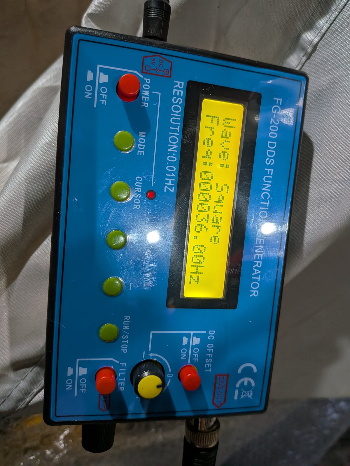

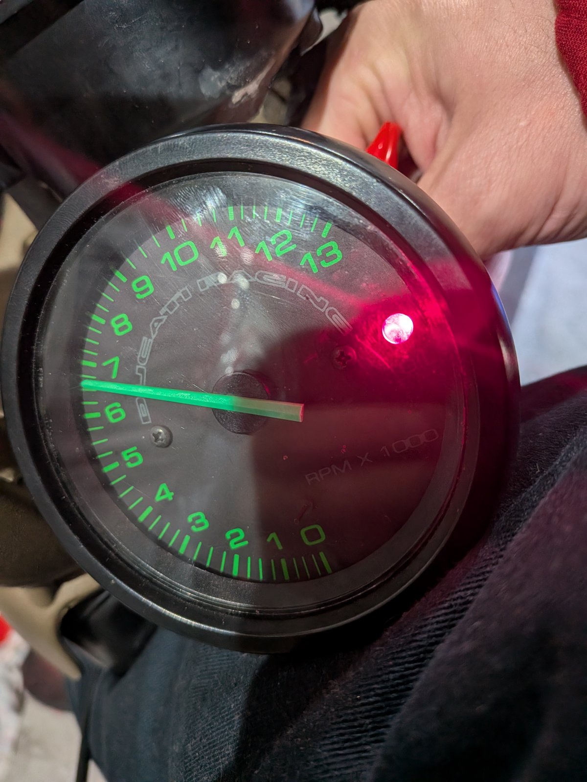

    Anyway - I have now bench tested the tachos. In simple terms, they work. No if's, no buts, 12v signal at 36Hz is around 1000rpm, and various other frequencies checked. They work exactly as the specs say they should (see pics).

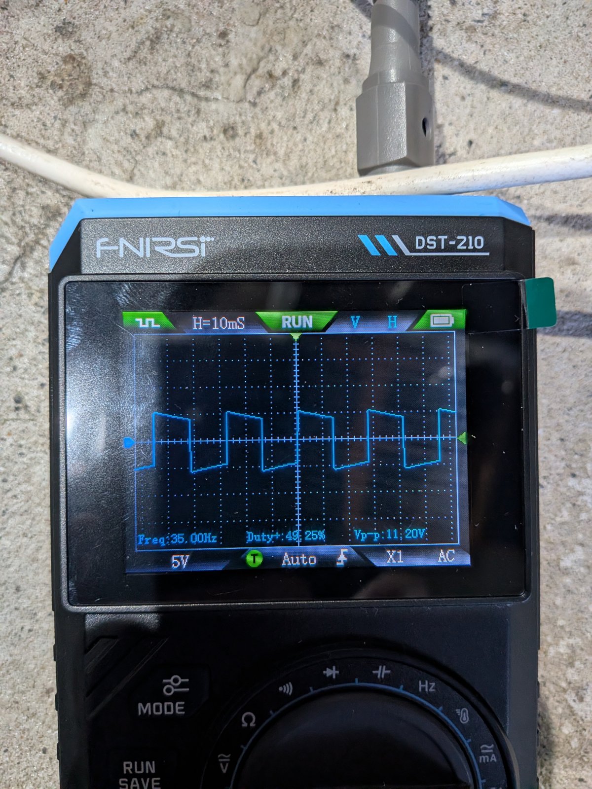

    - The signal at the tacho connector is square wave, 12v and identical to the ECU.
    - When the tacho is given the signal from a signal generator it works, when getting the signal from the bike it does not.
    I just don't get it. I set the signal generator to a signal that was as close as I could possibly get to the bike at idle. No problem.
    Pics attached so you can see what i've been doing. Ignore the RPM on the clock - i was messing with the frequency to make sure it worked at various RPMS. The pic of the signal generator and Oscilloscope are related.

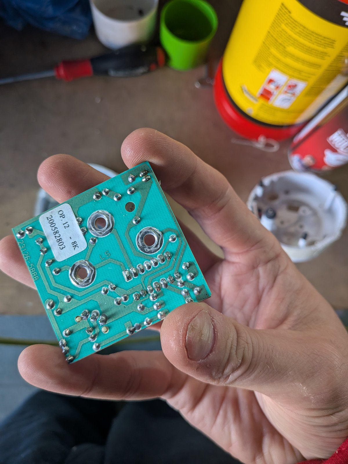

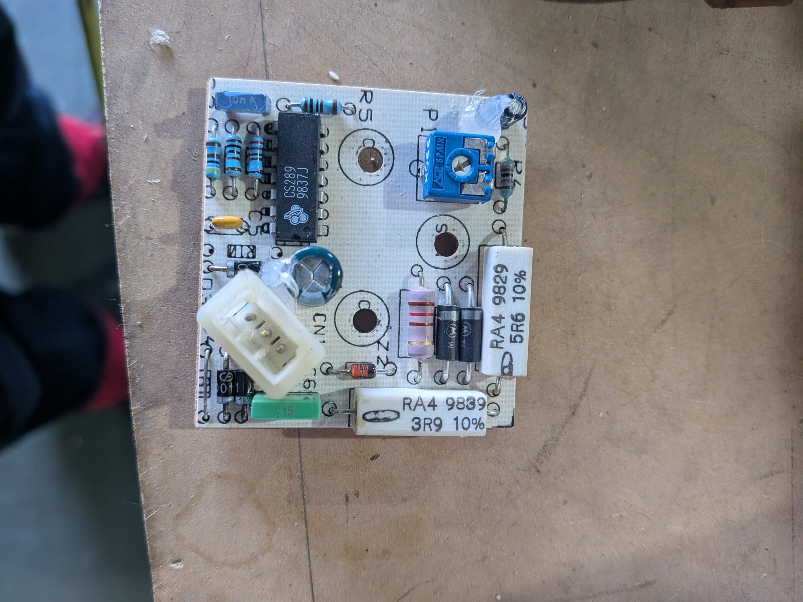

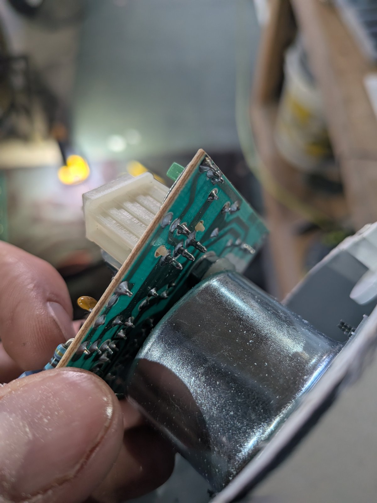

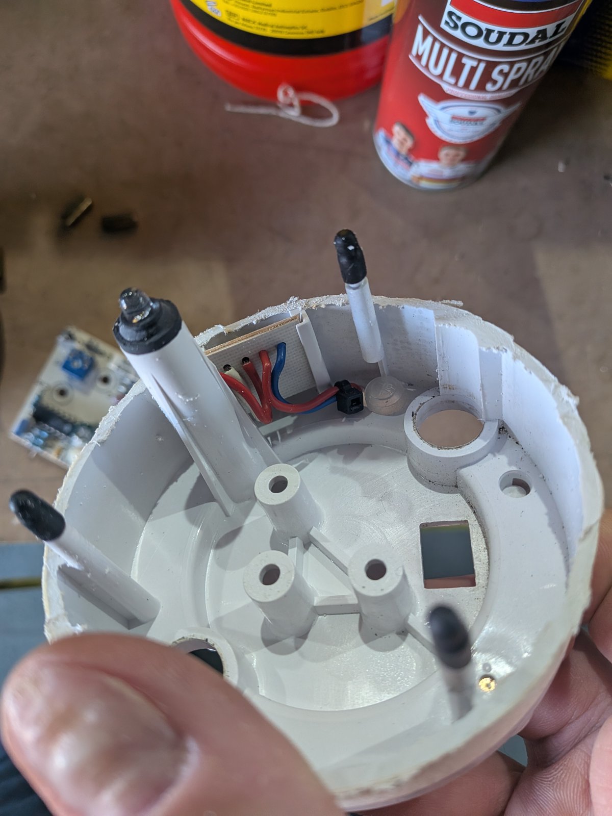

    I've escalated things a bit. In short, I damaged the middle pin on the second tacho that I bought, so thought 'stuff it' and cut it open to see what they are like inside. What I found was lots of dry solder joints. A few pics attached, but if anyone wants more for future reference let me know.

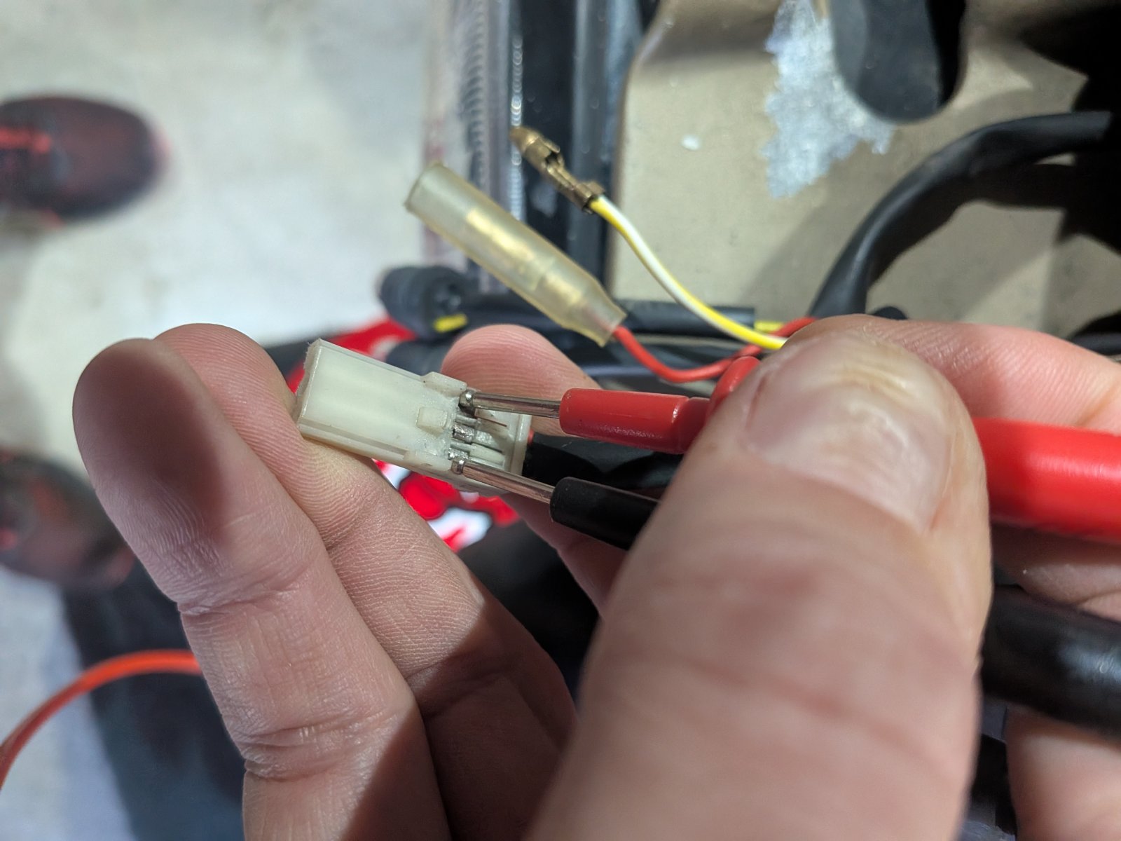

    I used this opportunity to check the connector, and I think it is making sound connection with the tacho.......however.......
    Whilst in the process of checking continuities at the connector, I noted that I have continuity between the black wire and the red wire on the connector (see the pic of me holding a multimeter against it)
    PXL_20251130_122420434.MACRO_FOCUS.jpg PXL_20251130_122427282.jpg PXL_20251130_122435590.jpg PXL_20251130_121513244.MACRO_FOCUS.jpg PXL_20251130_122358390.MACRO_FOCUS.jpg
    Am I wrong in saying that there shouldn't be continuity across this connection? I'm so baffled by it all now that I'm starting to lose track. Let me know, and as always, thanks for the continued support with this.
