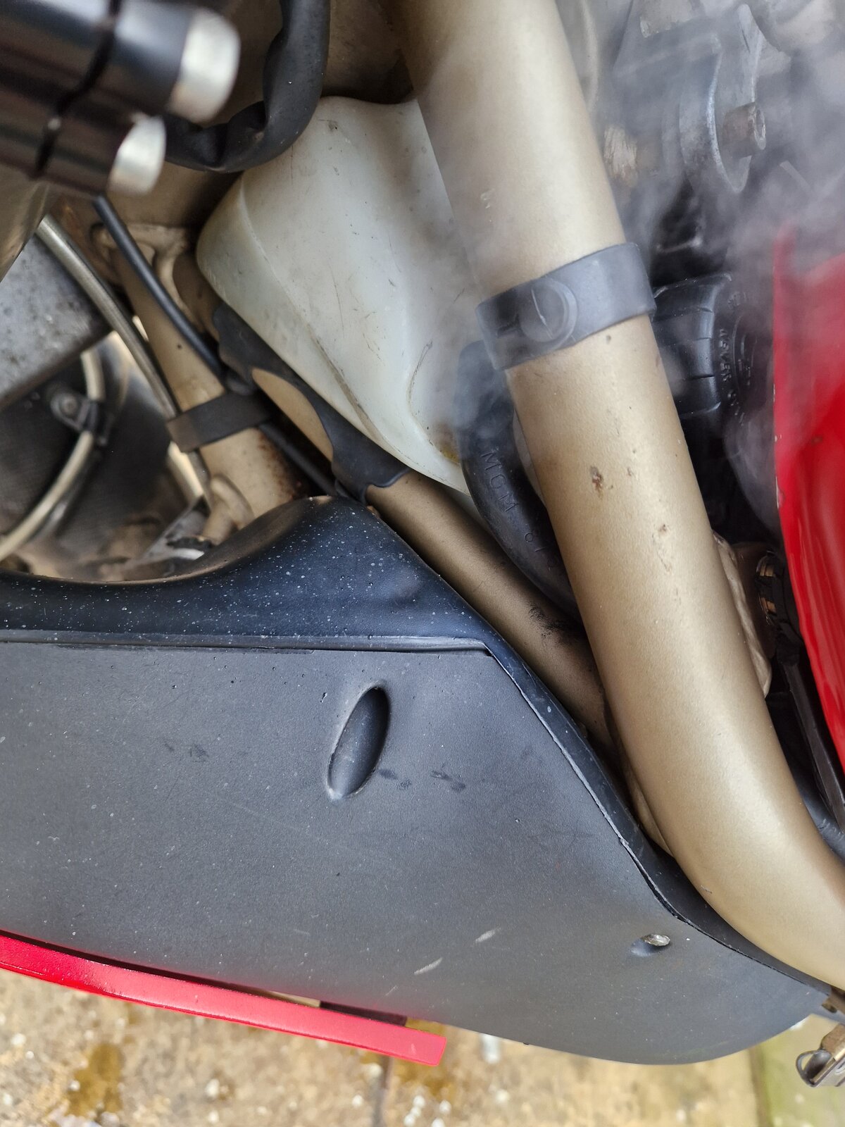

  1. The coolant was bubbling in the expansion tank above the horizontal cylinder, and it was hissing from the cap on the top tank
    The temp gauge was reading a temp, can't recall what temp though, I just turned it off as soon as I saw it

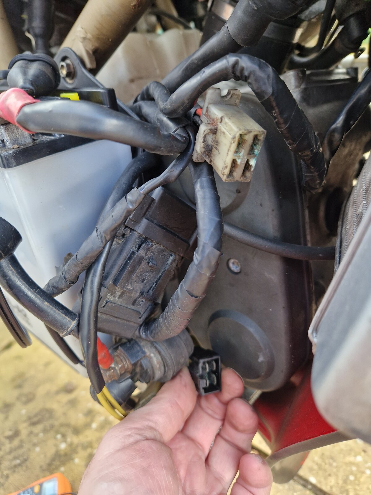

  3. I take it, these two plugs should be connected?
    The same (looking) plugs are connected on my 916, although, they are to the left side of the battery as looking at it, and these are on the right side
    Would/could this have anything to do with the issue?
    The white plug will be cleaned up before reconnecting
    I have checked the relay, appears to be working fine

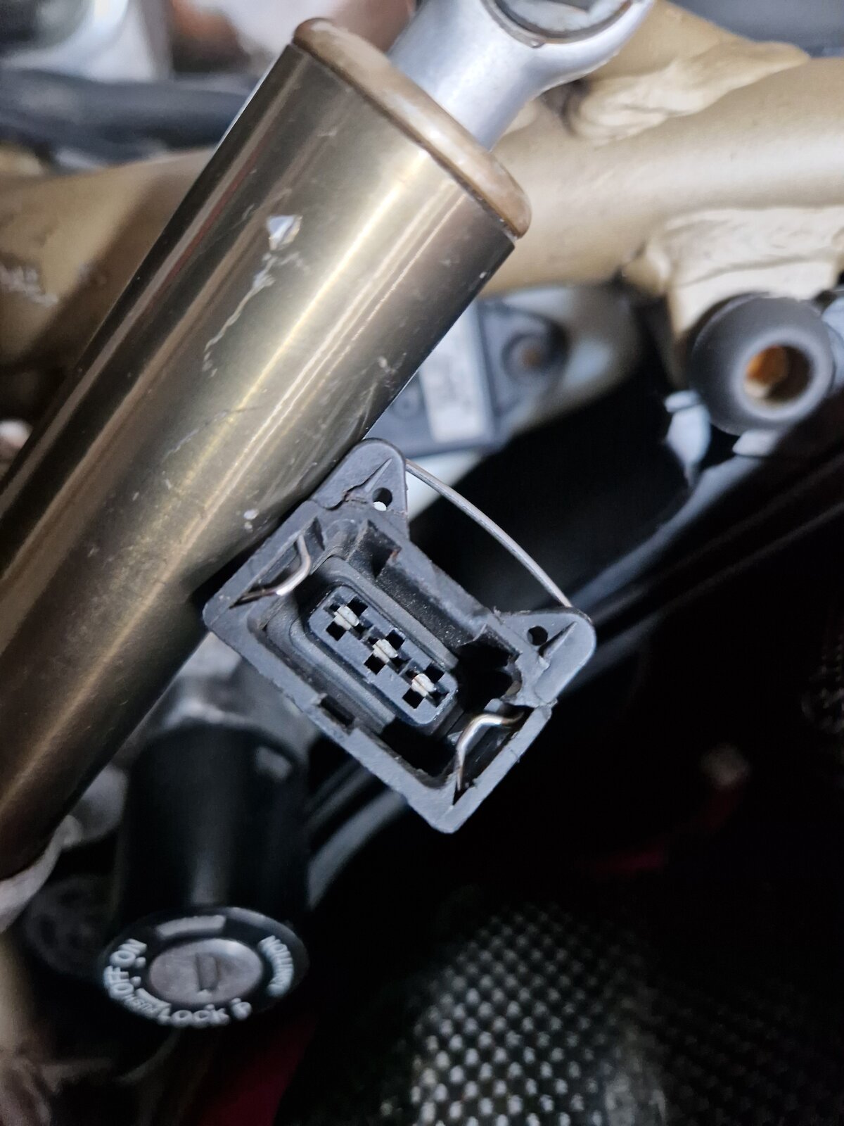

    I have checked voltage at the plug for the Cooling fan switch, shows 12v

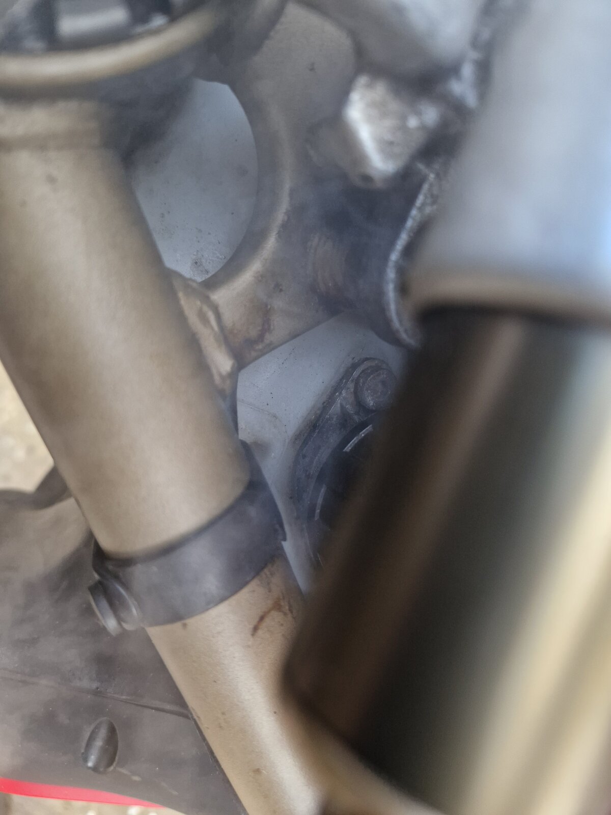

  4. Right, checked the cooling fan switch, it appears to be opening and closing as it should
    Had it running on tockover again, and it boiled up in the top header tank, by the headstock, there were bubbles and steam coming from the seal between the tank and the cap neck
    The fan started and stopped as it should
  5. That 4 pin plug looks like the R&R plug.
  6. It was, I checked the voltage on the battery, then checked again with the bike running, no difference
    Plugged it in, now shows higher voltage when running

  8. I know you said from the cap, but these tanks have the habit of splitting
  9. From what I could see, there was air bubbles coming from where the filler neck meets the header tank, then I got steamed out :joy:
  10. ? It must be pressurised, surely. How can it not be? A pin-sized hole will soon show that there's pressure there when it's trying to boil. There's no radiator cap on the 996.
  11. I was on about the wrong tank i.e. the overflow tank in the V.
    When I realised that, I have commented that the correct tank in question does have the habit of splitting in various places.
  12. He's right, the tank by the headstock is notorious for splitting. As above they all do it apparently. Mine did and was pissing coolant on every ride. A fine mist of it...

    The coolant issue appears to be the plug for the pressure regulator on the expansion tank by the headstock, not being fully connected, the wire securing clip is missing from the plug, hence the plug coming away from the connector on the regulator
    Plug pushed firmly in place, the bike has been run for a couple of long periods on a high tickover, and taken for a test ride, with no issues

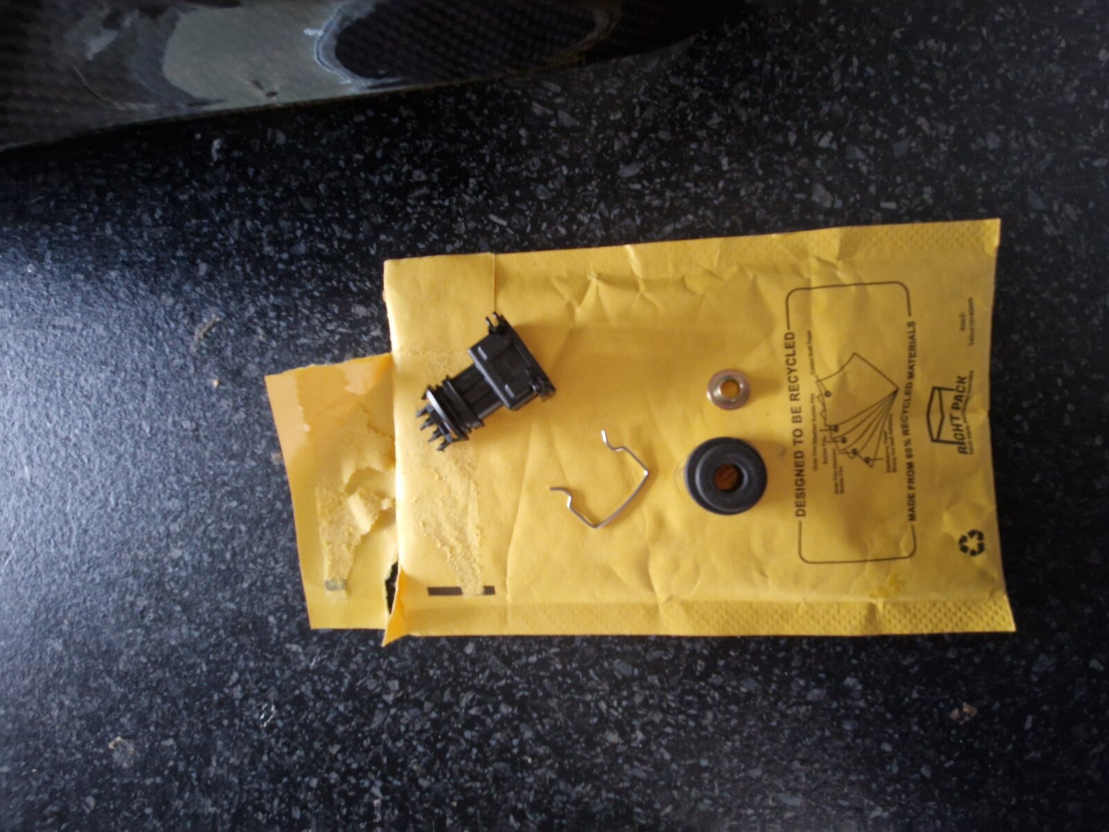

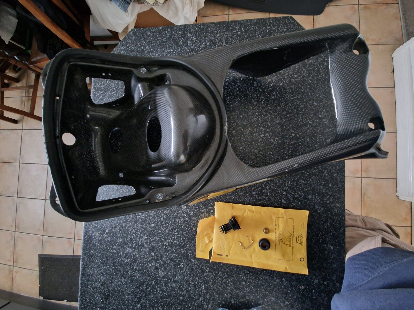

  14. But of an update, a carbon fiber airbox has been collected from @cookster on Friday
    The parts ordered from Ducati Coventry, which should have also been collected Friday, were not collected, they assured me they were open on Good Friday, but, when I arrived, they were closed, I called them, the automated message said they were closed all through the easter weekend, so, a couple of phonecalls were made Saturday morning, and the parts were sourced from @nelly at Cornerspeed
    If anyone needs a rear tank mount rubber and sleeve, DC will have some in stock
    A replacement 3 pin plug was ordered from a seller on eBay, I only need the wire clip
    Now, I need to find sone rivets to swap the airbox clips over from the old airbox to the new one, that may be a trip to Halfrauds tomorrow

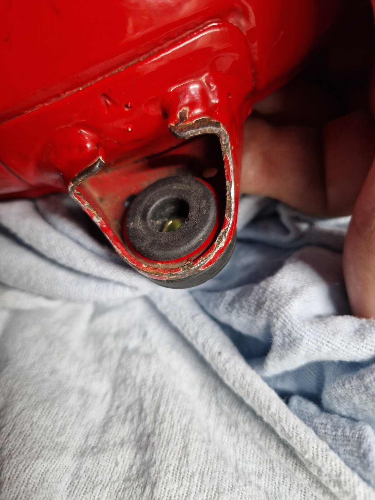

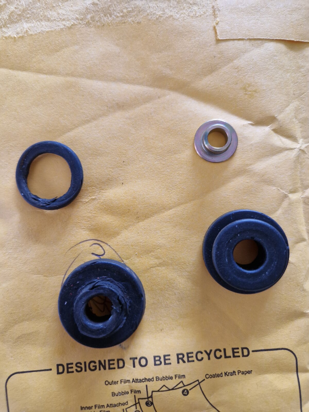

  15. Done the metal clip, and the rear tank rubber grommet
    Need to get some rivets tomorrow before I can do the airbox
    Old grommet, and new grommet

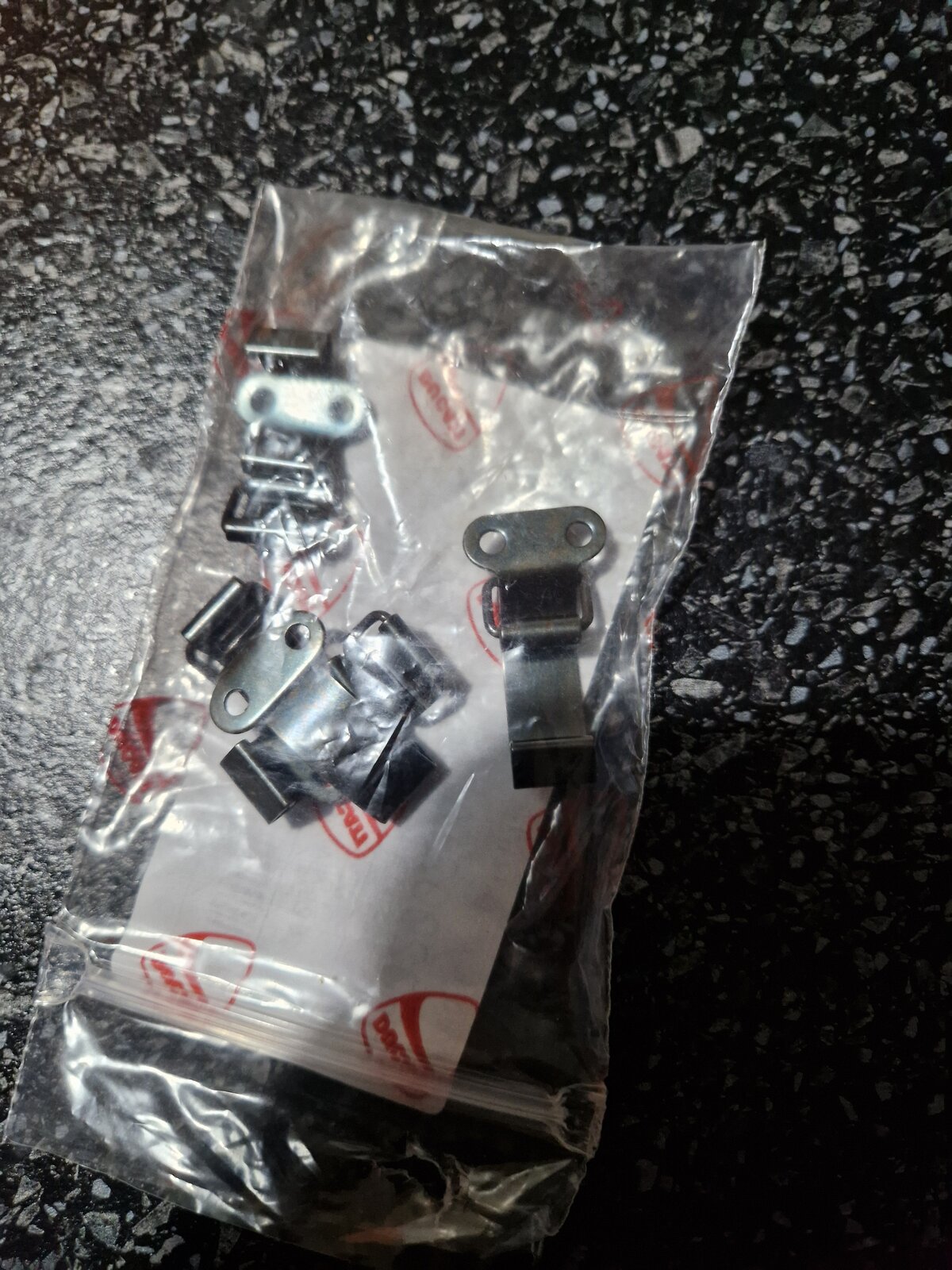

    Not fitted the new airbox as yet, I decided to order some new clips that secure the intake pipes to the airbox, instead of fannying about trying to remove them from the old unit

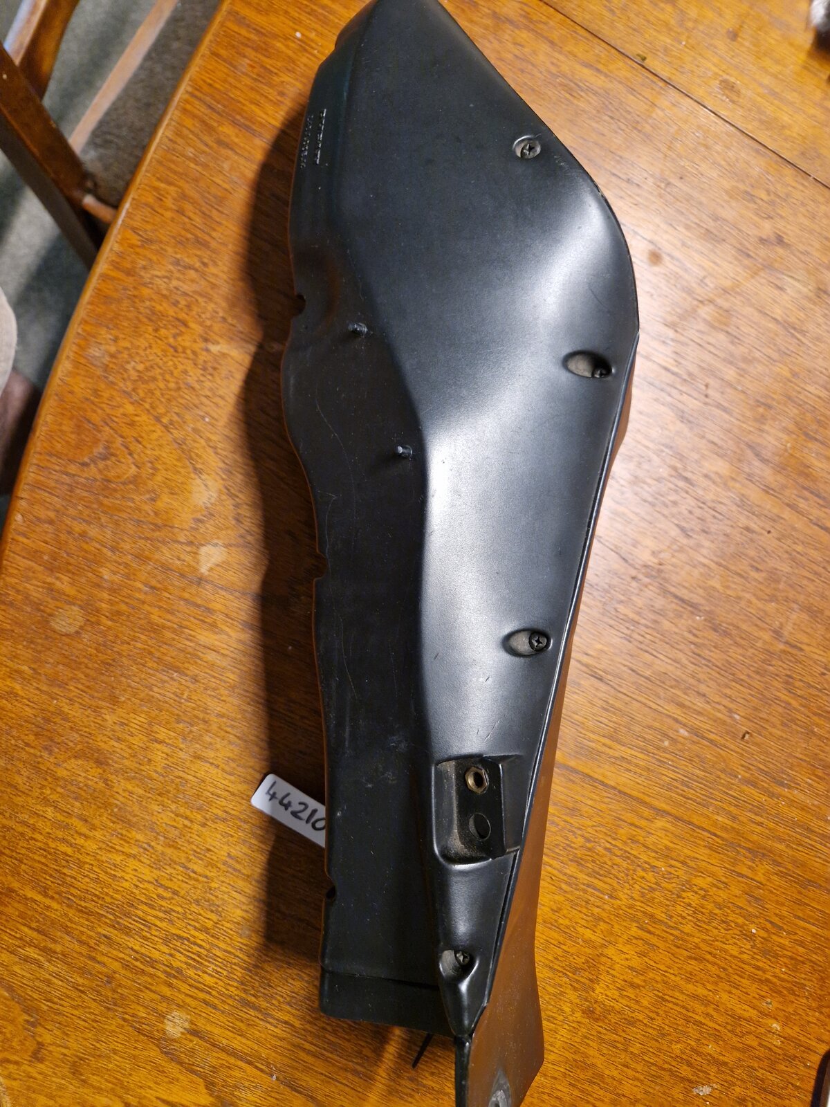

    I have also ordered a replacement right side air intake tube, as on the outer part of mine, all the fastening points are cracked and broken, some with chunks missing, the ebay seller sent notification last night that it has just been despatched
  19. Some parts collected, some parts delivered
    4 clips for the airbox to air intake tube, £38 :eek:
    Replacement used right side air intake tube, £20 from the Bay of fleas, all fixing holes are intact :upyeah:
