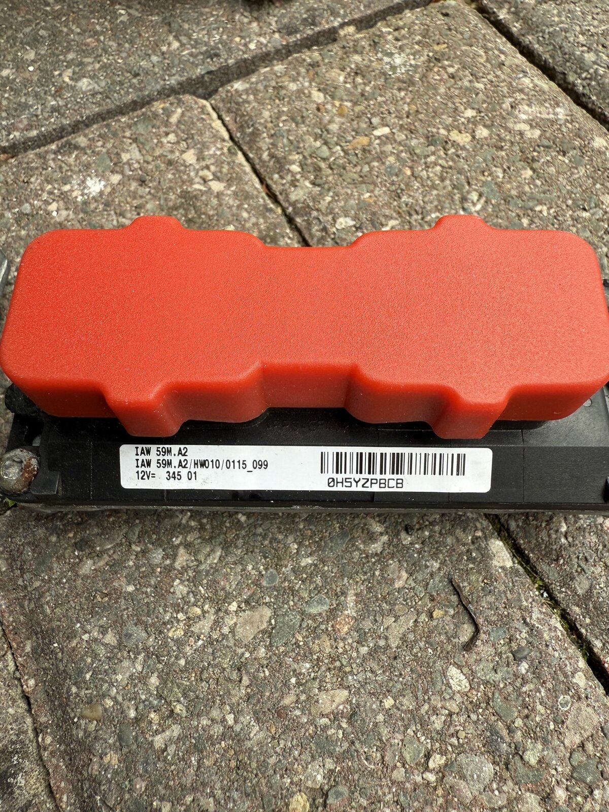

  1. Is anyone able to shed a light on what these 996r Ecus are please?
  2. That is the standard 996R IAW 59M ECU. Will probably be interchangeable with 998 and 999 ECUs too
  3. Thanks. Tho which one, as there are two there :)
  4. The first one is a stock ECU.

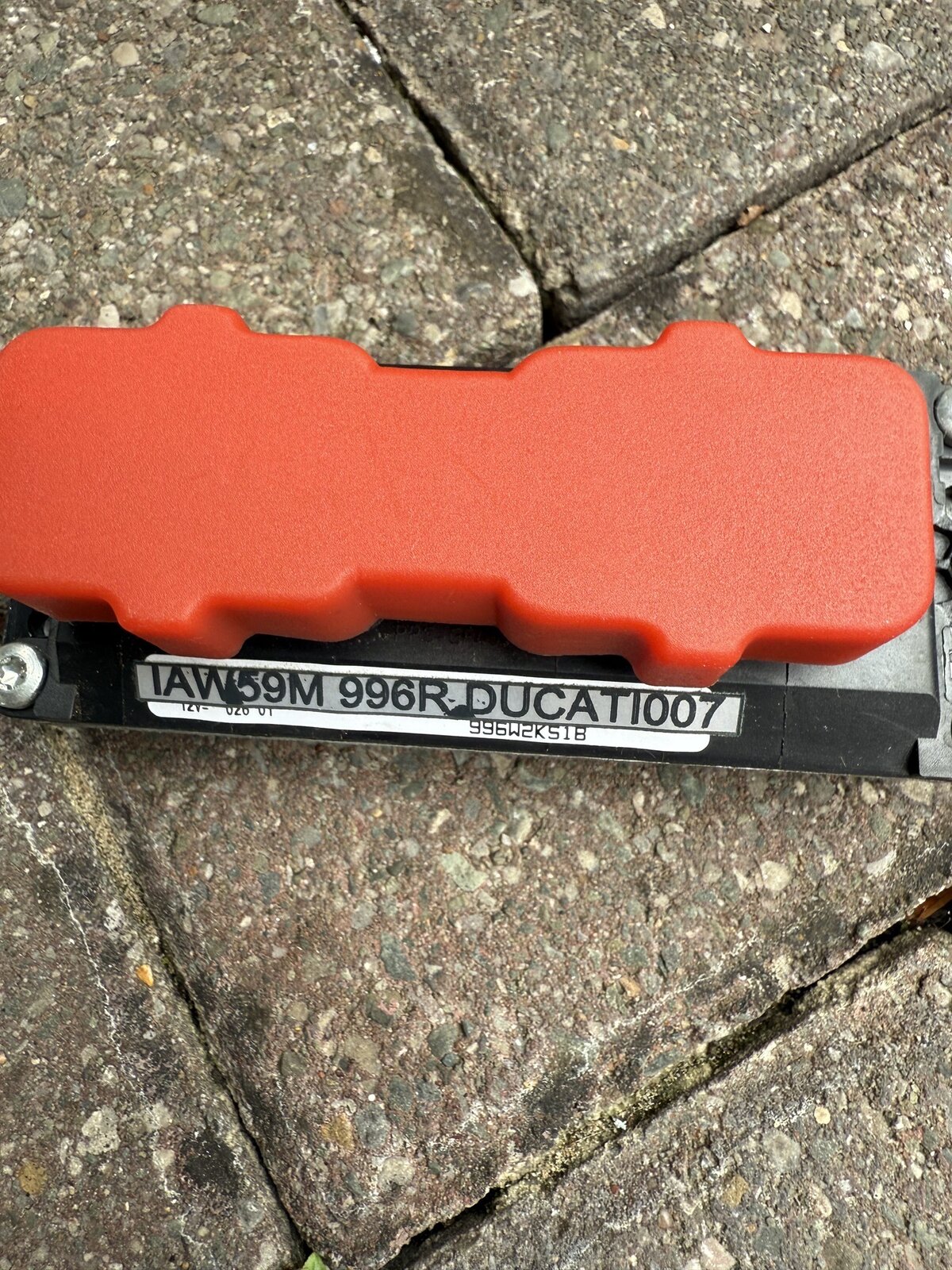

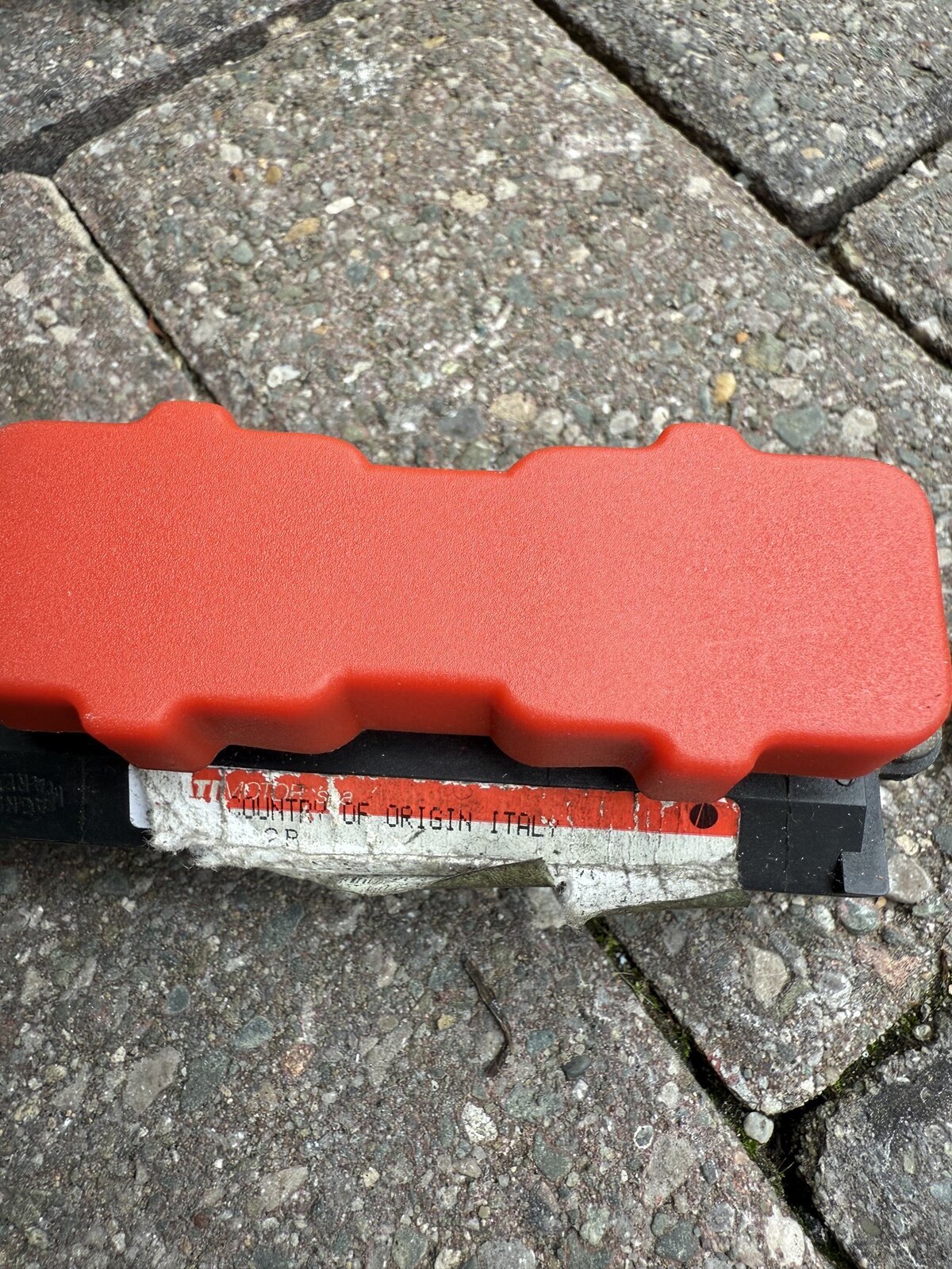

    The second one is a Ducati Performance one. Are you able to read any of the printing on the red label? That would help identify if it is for Slip-Ons or Full System.
    These ECUs will be virgin. They are IAW59M’s and can be used on later bikes like the ST4S, 749 and 999.
  5. The DP one looks like it ends 2B.
    I have looked at my map files and I have a 996R map 96509202B. Unfortunately I do not know if it is for Slip-Ons or Full.
  6. Found one for the 996R 50mm - 96507502B
  7. Thanks Chris. Without being able to read the numbers on this one I’m not sure how I’ll identify it properly. I have 3 ECUs, the standard and one for 50mm system is on the bike currently, makes me wonder what this one is for..
  8. Well, we know the last one isn't the stock or the 50mm slip-on tune that came with the bike, just by virtue of it having a retail label on it. Without downloading the .bin and analysing it, really no telling what it could be. It might be a warranty replacement, might be a spare, might be for a 54mm system.
